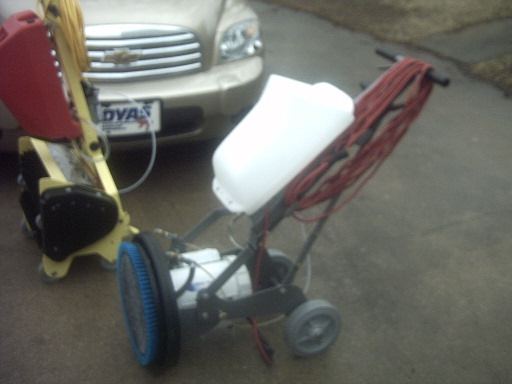

I like both velcro and bristle drivers for different reasons, they each have their pro's and con's but I liked the pad driver on this machine the most. CX picture.jpg
