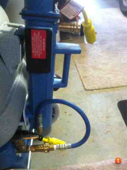

I liked the Edic for this whole set up.
Edic has two cords. If you dont use heat only 1 cord.
This one does not have Auto Fill/PO

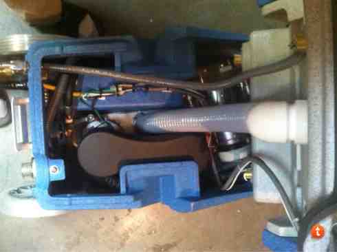

Well you can just give up on "trying" to make quality equipment - as you say ... I'd have to say you've "succeeded" in making quality equipment .. I've had my galaxy for about 7 years cleaning commercial carpet .. about 20hrs a month roughly .. and the only issue I had was the pressure regulator silver bullet (plunger) rubber cup ring wore out causing a drip and my pressure gauge stopped working last year and started dripping this last month ..
I thought about replacing the vac motors for best performance but I'm getting great results with the way they are .. the carpet drys in 4-5 hrs .. and I'm going to assume its because the building I clean is very dry .. so I won't be able to accurately gauge dry times on normal conditions
I'm also using a 35ft one and a half in hose
Oh wait - my power cord is all twisted and wrinkled looking - yeah - must be poor workmanship - maybe I shouldn't buy a galaxy - damn cord

If you did decide to change those vacs, the newer generation motors will give you a nice boost and slightly less amp draw.
Also, I'm not sure of the condition of your recovery tank lid gasket but we've also upgraded that to a better material with more "memory". Replacing that may help create a tighter seal.
