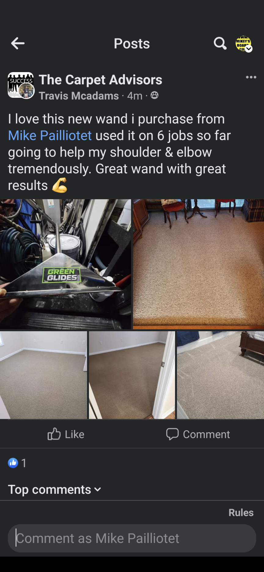

The only actual “improvement” ever made to wands was the glide. Everything else was just window dressing.
I don’t know pig guy. Doing away with the bulky triangle head down to a low profile rectangle head and the feather trigger with the jets at an angle instead of straight down is nice too
Reactions: Austin Willoughby
