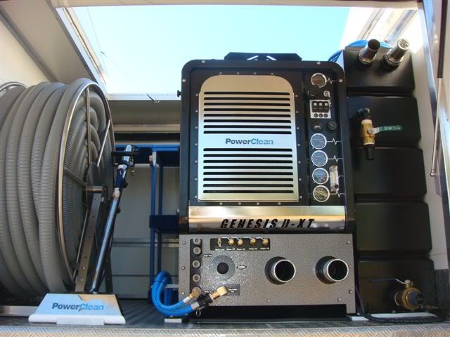

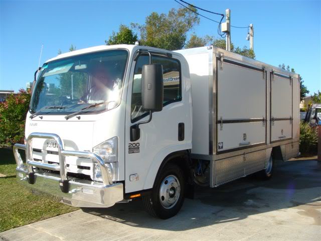

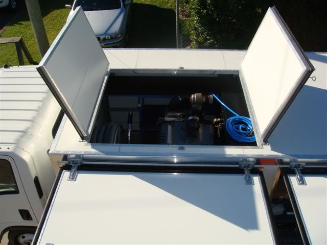

This is the new Isuzu NNR Truck with a custom designed low profile pantec to get into smaller places and underground carparks. You will notice another hinge on the lift up doors, this enables the doors to fold back in on themselves in case the vehicle is parked in a tight area and cannot fully open the doors up because of a wall or gardens etc. The pantec also has under body lock boxes and storage areas for various tools.

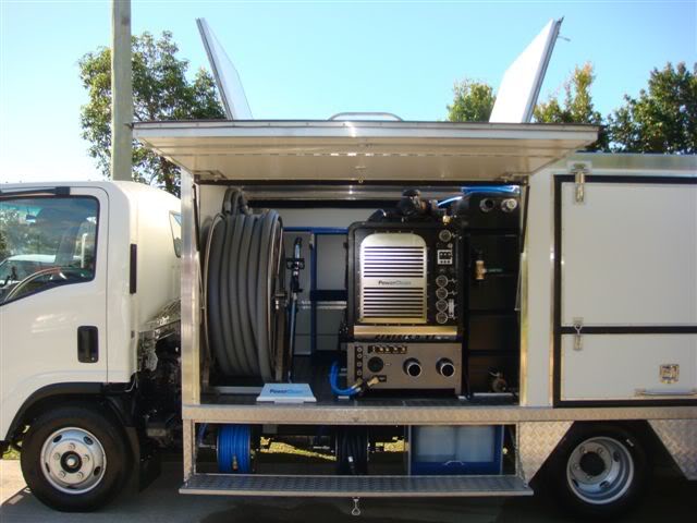

We installed the new PowerClean Diesel Genesis in the front compartment. The hose reel is filled up with 2.5" vacuum hose. Underneath the pantec, the checkerplate faceplate folds forward to show the live water feed hose reel, live Auto Pump Out hose reel and both the emulsifier/acid rinse chemical injection bottles. When folded down, this faceplate also acts as a step for hoping up inside the pantec.
You may have seen in the earlier photo that the roof has swing doors as well.
When these doors are open, you can simply stand up in the pantec, even though it is low profile. Servicing is a breeze with this type of configuration.

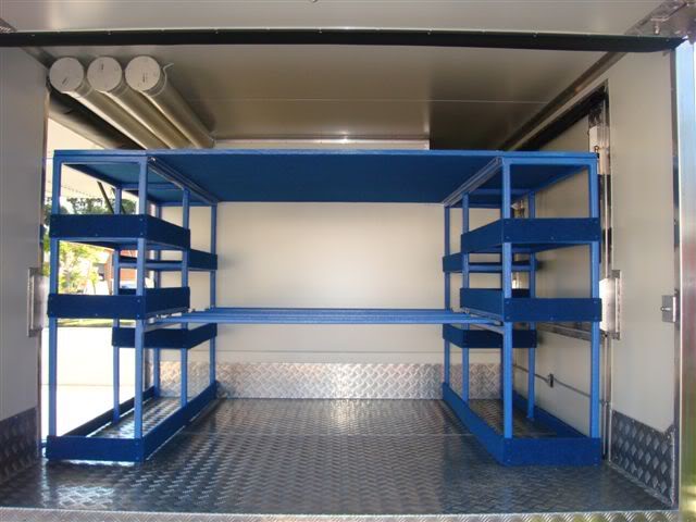

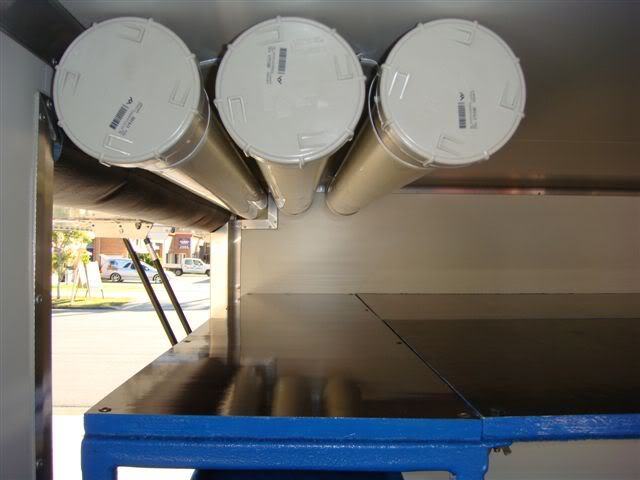

This is the rear view of the truck. The machine can obviously be operated with the rest of this rear compartment and it's 3 doors completely locked, keeping the valuable smaller stored safely. There is enough room for a Cimex and another type of scrubber/rotary in the right and left hand corners behind the racking and then can be tied to the pantec to secure them. There is racking in the middle between the right and left hand side frames about 600mm off the floor. These are to store air movers on. They can be removed if you are needing to carry alot of larger objects as well. The right and left hand side frames are designed to carry toolboxes, chemicals and other carpet cleaning/laying equipment.
This area sits on top of the rear right hand side frame. It is to make carrying long rugs/rolls of carpet easier. This continues right through to the front Truckmount bay of the pantec.

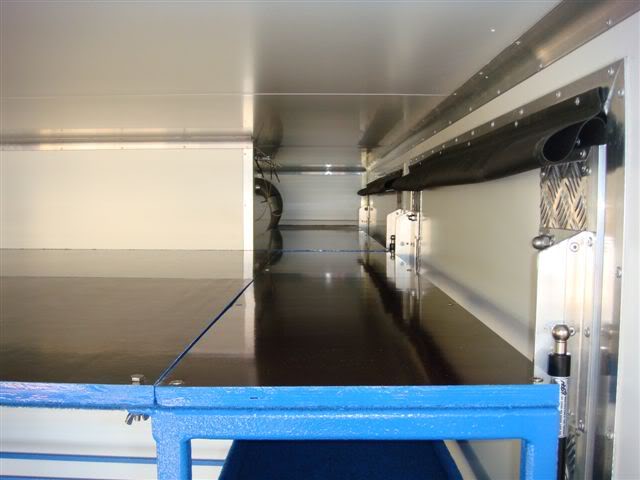

These three containers are for carrying nap lock/trims etc. The one on the left hand side again goes right through to the truckmount compartment as well. The top shelf between the left and right frames is for carrying smaller rugs. If however you need space to carry larger things, this entire shelf can be quickly taken out giving complete floor to roof access right down the middle of the rear cargo compartment.

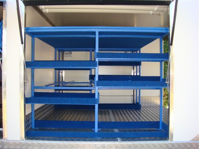

Side view of the racking in the rear cargo compartment. Having gull wing doors in both sides means that you don't have to climb up in the pantec everytime you are chasing something.

Can the electric power poles in the roof be removed when it is necessary to get under low clearances?
Scott Warrington

Couple of questions there Mate, Will that folding step hold the likes of me and the Short One without buckling in the middle?
Won't those reels, even though they are for waste water and your incoming supply line, get a lot of road soils and mud from the tire splash?
Here in the US some of us take the waste hose into the home to the toilet so it has to be clean on the outside surface as well. Where is your solution line reel going to be placed? Looks like you have shelves behind the cleaning plant on the drivers side.

Fortunately we don't have to worry about freezing down here. So we can remote mount the chem bottles without any worries.
The bottles hold 20 litres each (5 gallons).

John Watson said:
Young Jim,
Yes the folding step will hold You, Shorty and then some John.
Yes the reels will get grime on them. We can build them and enclose them completely, however, I don't know of anyone running the APO hose inside. We have alot of space over here you know :wink:
However, as these are all custom rigs, if someone wanted us to build it enclosed, we would do as they require. Yes, there is shelves behind the machine, it is to hold a portable, dehums and carpet laying tool boxes.
