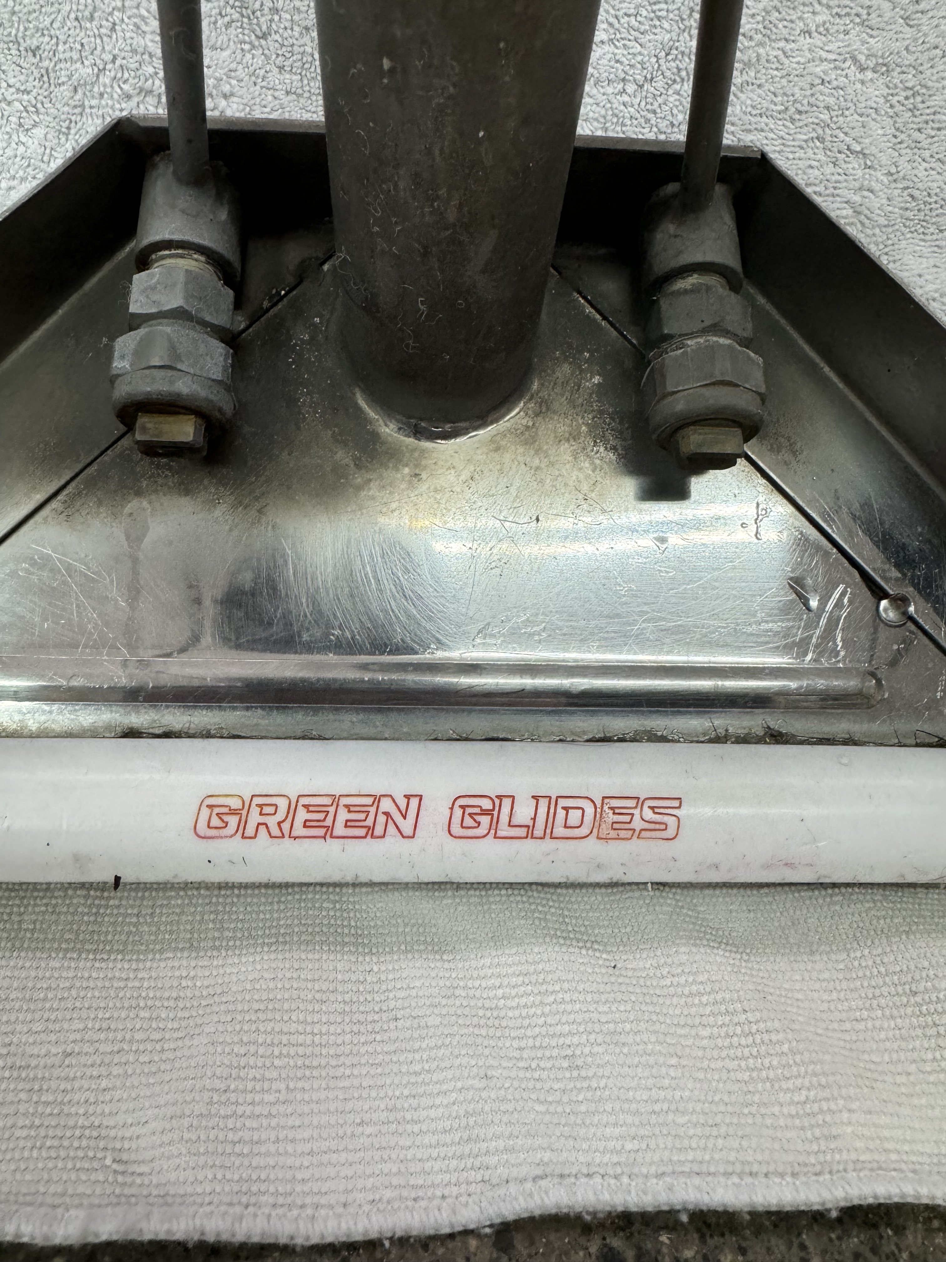

Let me see a nice clear photo of your current jet configuration on the wands in question

Waiting for photos

There's a low profile version of the aw29 that I have not tested the extenders on, and depending on the angle of the photo taken it's hard to tell
Ok, from the ground to normal height of holding the wand, it’s 5 1/4” off the ground to the top of the shroud.

2 slot glides, 2 sets of EB’s, and 2 sets of new stainless jets.
I’m assuming that the EB’s change the height of the jets, so…. 4 flow, and 110 angle???
Actually, one set 4flow, and one set 3 flow, the second wand for my porty…
