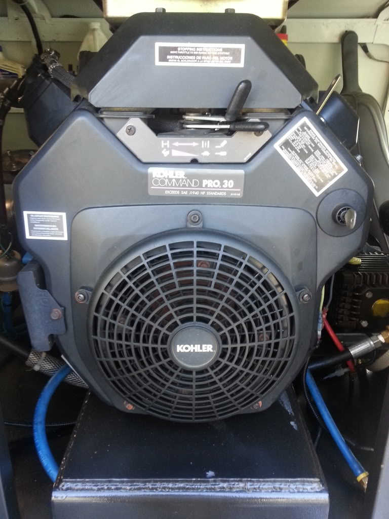

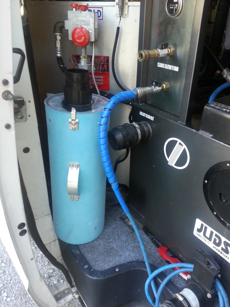

I think my Little Giant is too close to my C4
115,988

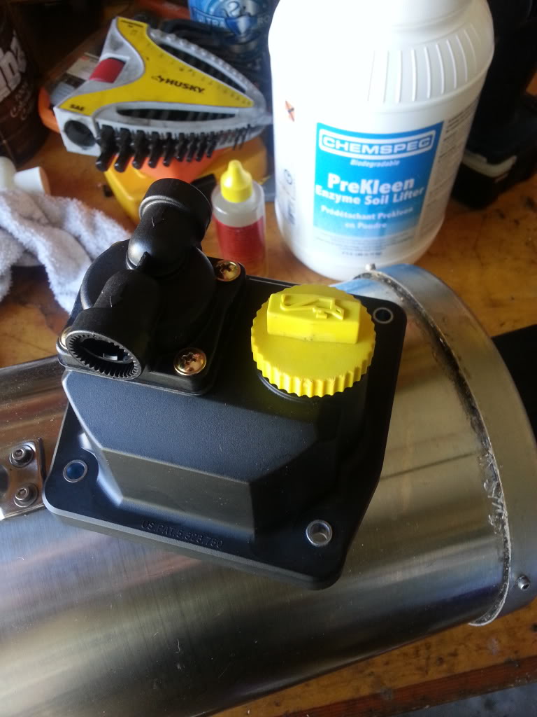

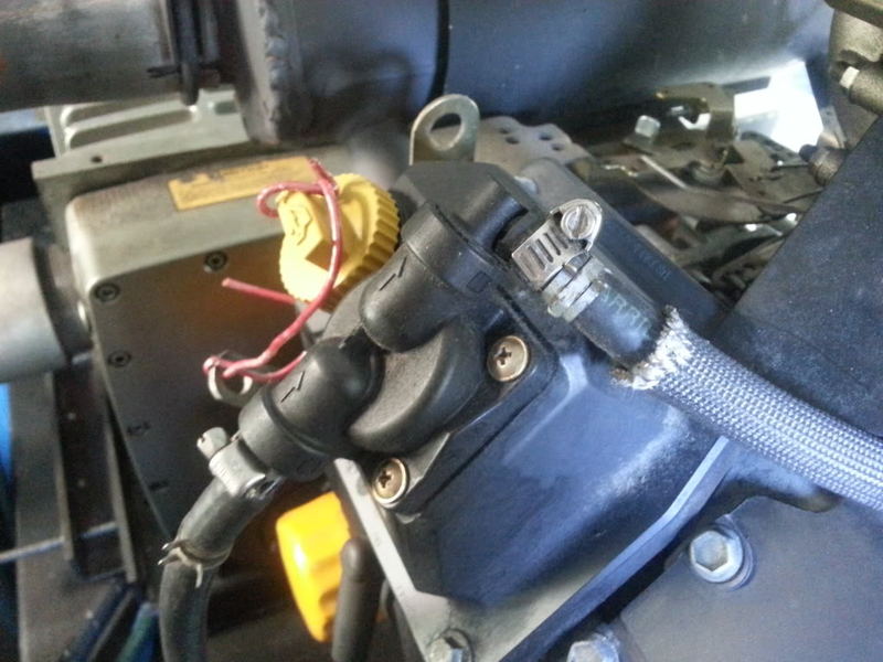

the oil valve cover has gotten so out of shape the even with a safety wire and thick teflon tape around the cap threads, I have oil leaking out from under the yellow cap once the unit is hot.
you can see how close in this photo..
Les sent me a new new valve cover but I'm thinking I better create a heat shield to prevent further warping.
Any one else have this issue?
115,988
but than again, I'm guess that the cover is being warped from the heat, it could just be faulty. its darn thick plastic.
I've seen more Kohler fill caps leak than not.
Just recently had a guy come in with a engine knock.
Brand new engine the fill cap was not seating correctly. (piss poor design)
My own 38hp Kohler has the biggest pos fill cap design on it and it also had factory defects in the valve cover oring.
So I wouldn't be suprised to see a defective part.

Even though your LG is close I doubt that it is the cause of the cap warping. More than likely it's the heat from the motor itself and maybe the cap it made of the wrong material. That plastic igniter your have attached to the LG seems to take the heat.

Mike like lockhart said get some sheetmetal from a race shop nearby. Glue some insulation on it. Make a divider. My silencer box in the Vortex was barely warm and made like this.
Not sure what insulation they used but the fuzzy side was facing the silencer.I dont think the heater is the main cause though. My #3 doesn't get that hot.
115,988
new cap/cover.

I walled off my little giant on three sides for safety reasons. I've heard of carpet pad or some other crap shifting and causing a fire. I also elevated mine. If there is a leak, propane is heavier than air and it will flow out the door. Also, put a mirror under it, incase I need to light it with a bar b q lighter.

no prob's with mine. I would say it is from engine heat and a bad part as well. the LG doesn't create much heat to the side. Mine in within half inch of carpet and it has never melted or deformed the carpet. However, at the top of my LG I do hae a heat sheield that protects the wall.
115,988
It's awful thick plastic on the valve cover and the cap has never turned this hard so I'm going to go with it being a faulty cover.

Off the subject , but what kind of hose is that running the propane to your lg heater?
Thank You

I need to get some hose to run from my belly tank to the LG and IDK what kind of hose to buy.
I just go to the local propane shop.
They give me the hose I need rated for propane (cut it to fit) and special fittings you put on with two wrenches.
