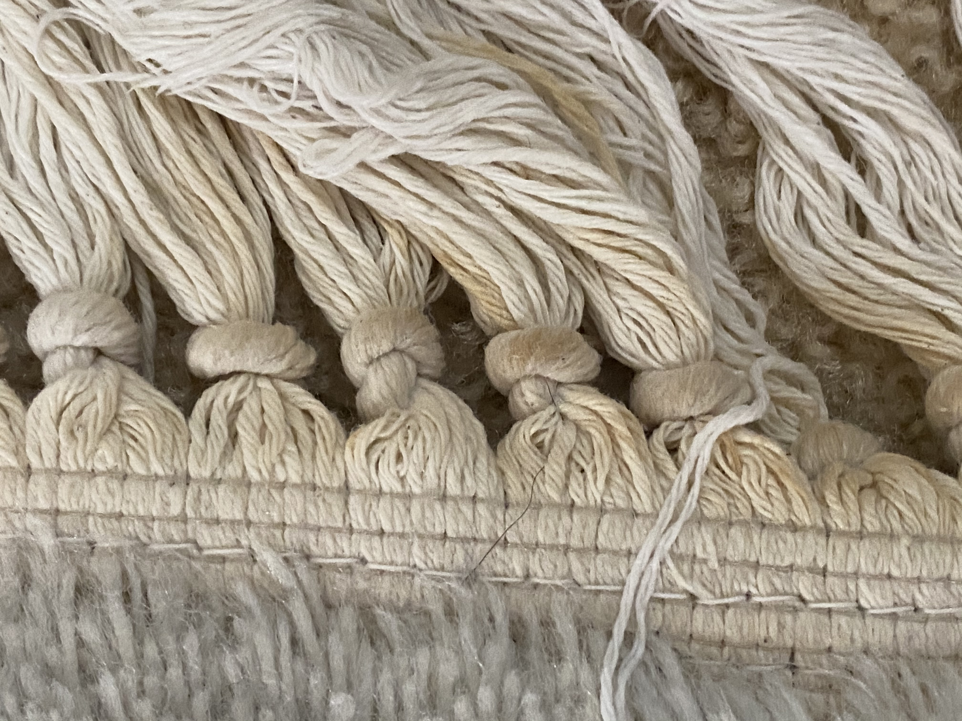

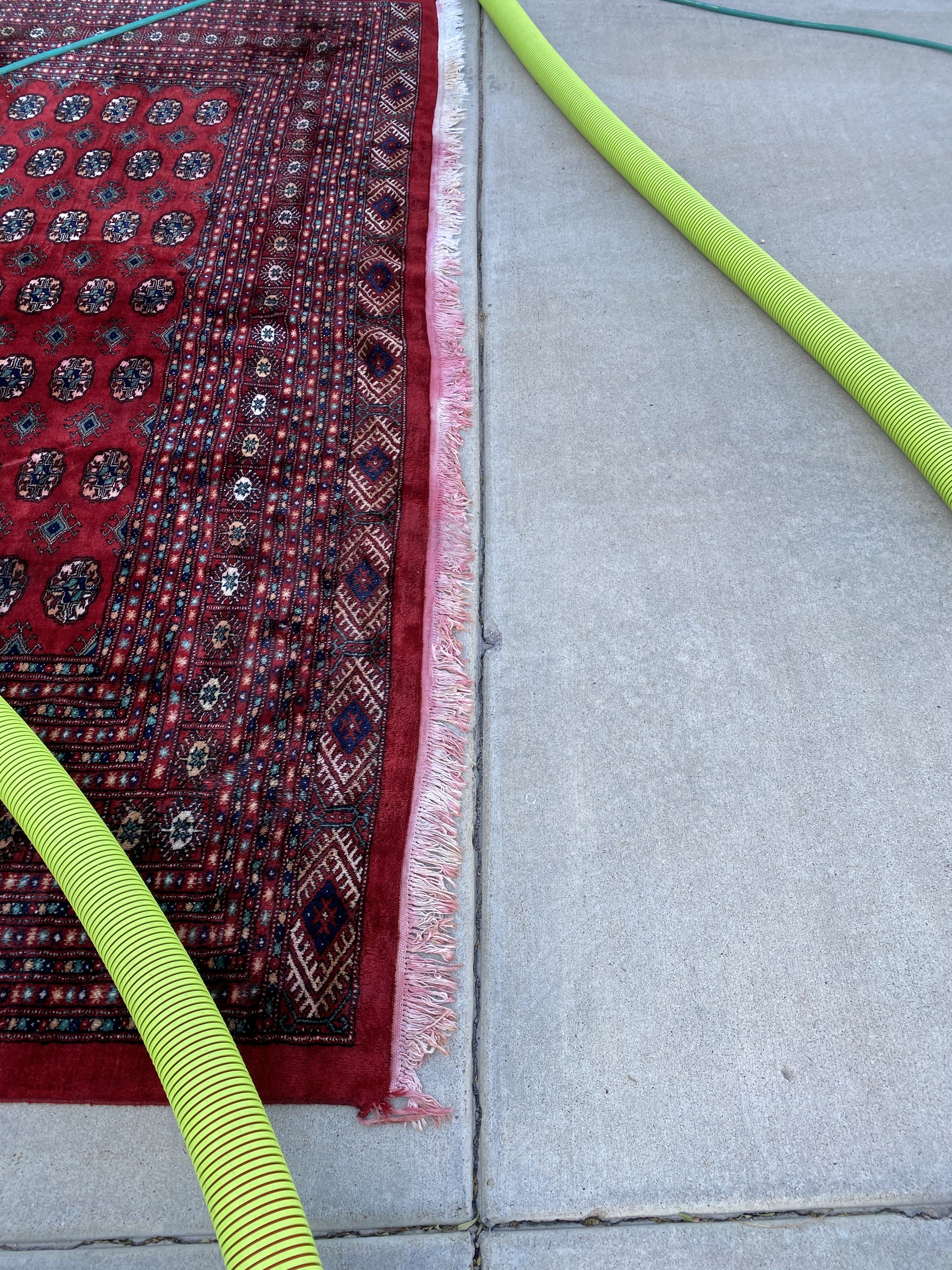

Browning of fringe
24,146
Did you pit wash it or try and clean it with your wand?
That was pit washed. I ended up soaking it with acid rinse and drying it face down on a canvas tarp. I placed air movers on the back in an effort to reverse the wicking. It worked. I also sprayed the backing with peroxide as a post treatment which cleared it up more.

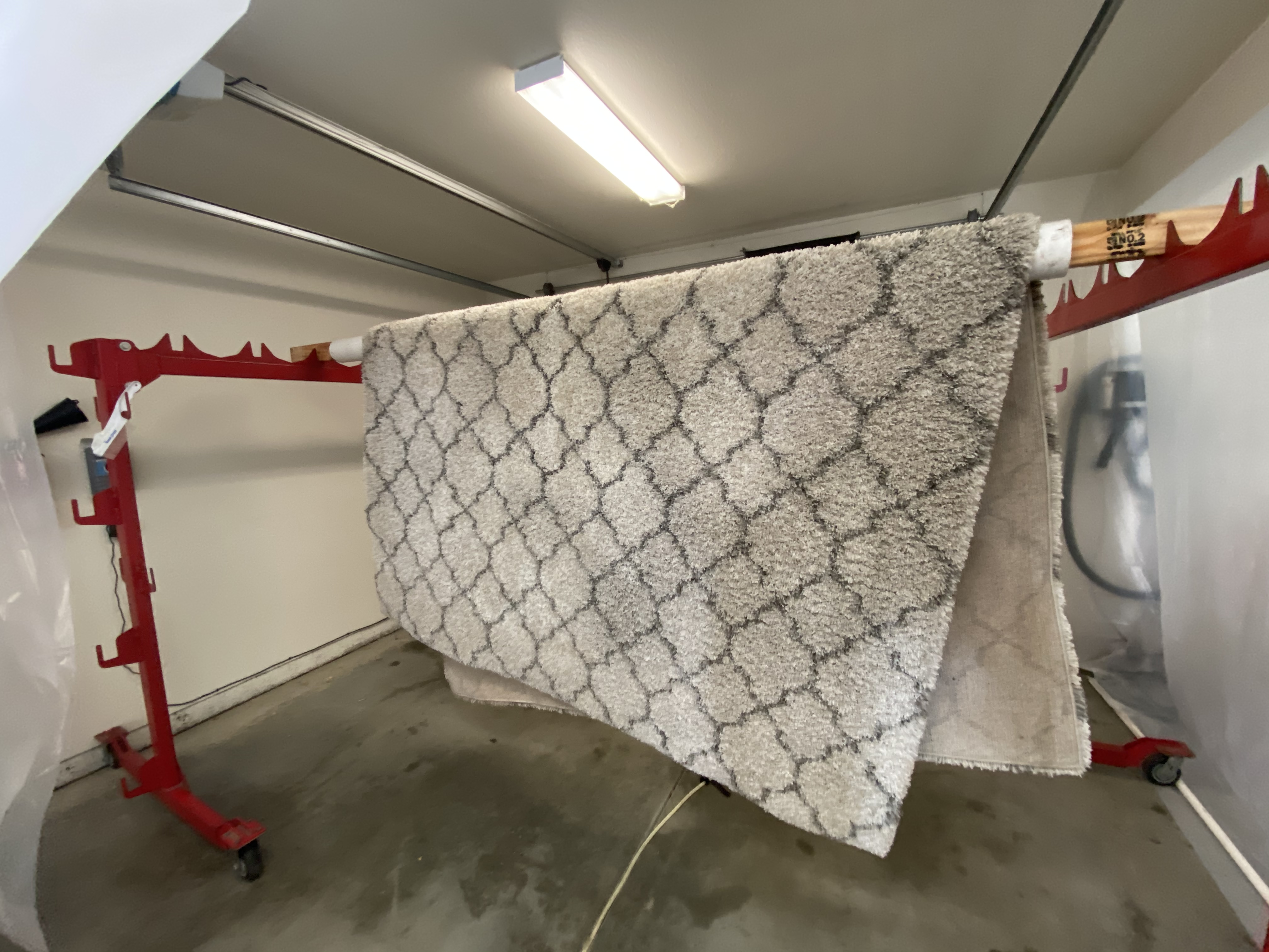

Got the monster done today, and 5 others...
The big one is taking up 4 bars.
I think I’m going to need another hr. or 2 on it....
I’ve got 10 more that need to be done. They are all scheduled to be returned this coming week.
Boo, guess I’m working 7 this week.....

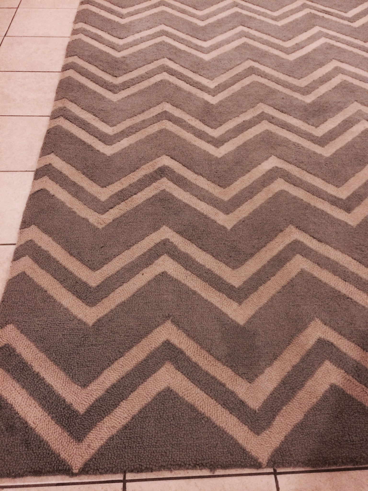

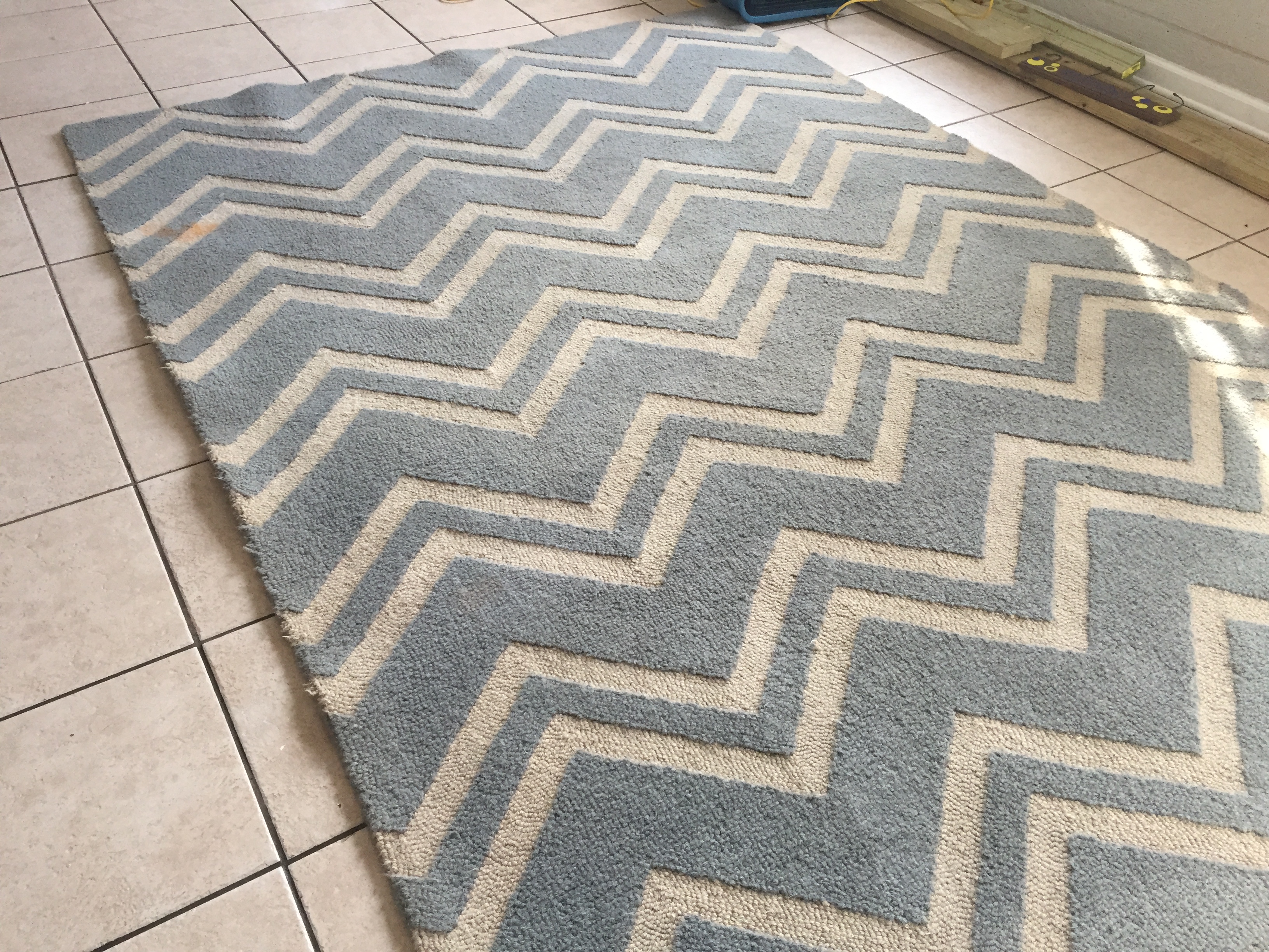

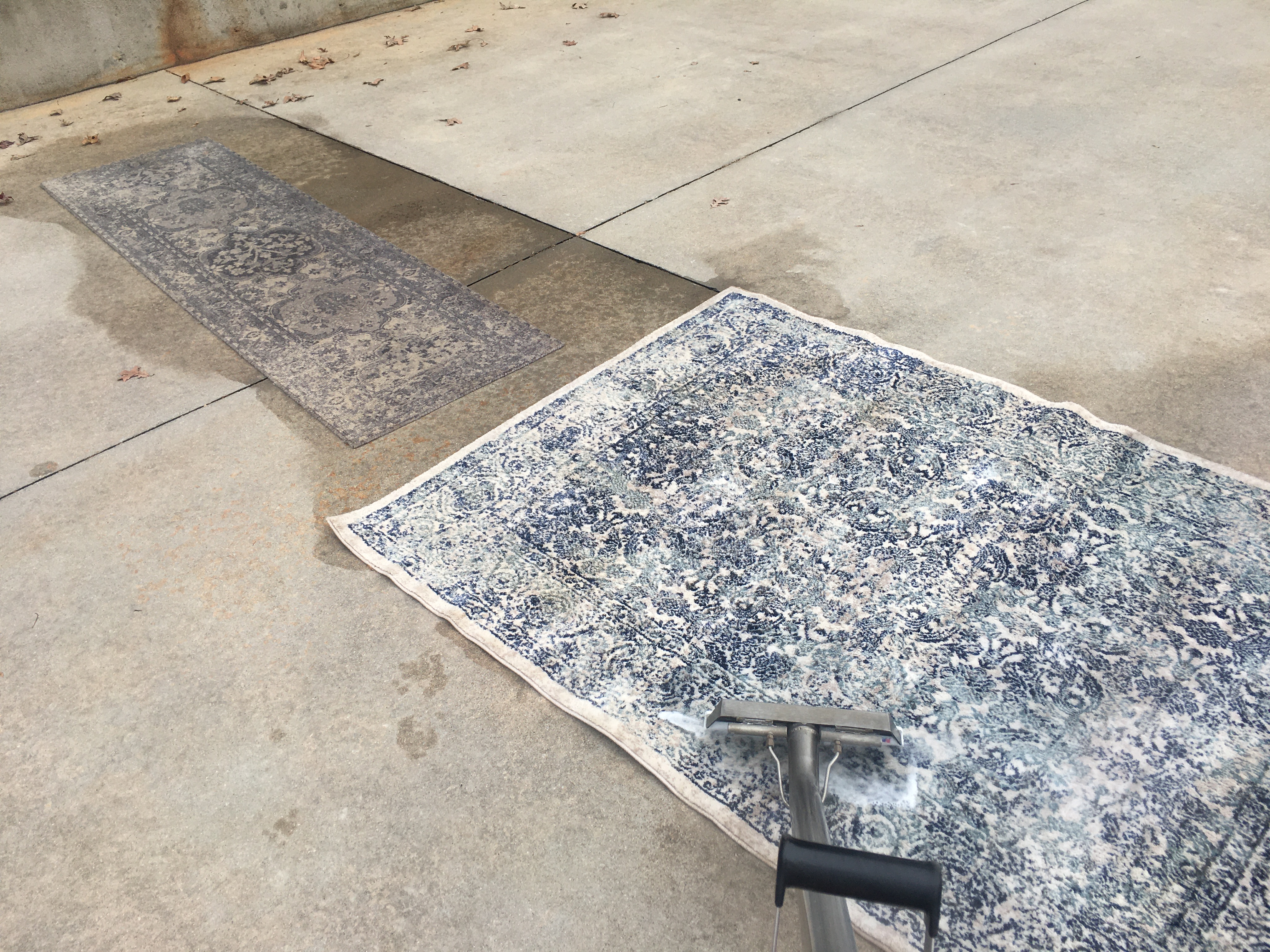

A wool rug that browned from alkaline washing, corrected with an acid rinse:
Not being critical Coastie, just looks like the floor has a similar browning issue. Maybe part of the first photo is a lighting or camera artifact?
Old Coastie
Jun 29, 2015
7,504
Stephen
No, the floor is a beige pattern tile. I guess we can thank iPhone or different lighting on different days for the way it changes tone between pictures.
14,632
Oh no!!! What do I do to fix this? I made the Concrete brown out around the rug!!! Lol
