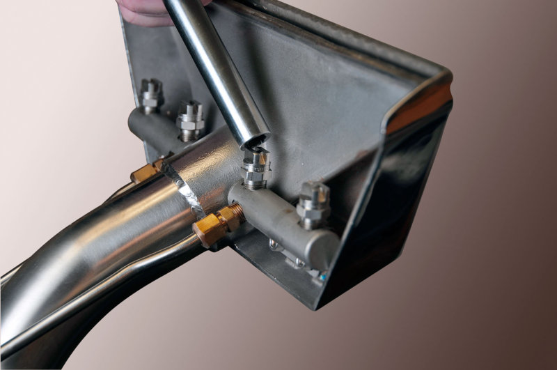

btw EVERY TRUCK should have a Hard Surface Wand on board.
I prefer the PMF wand as it's a full size S bend and built like a tank.
Some of the others have goofy angles and cheesy hardware.
27,863
The new Gekko wand is pretty nice, has a swivel, new manifolds and got rid of the cheesy little connectors and replaced them with proper qc's. Squeegee head for portables/brush head for TM's

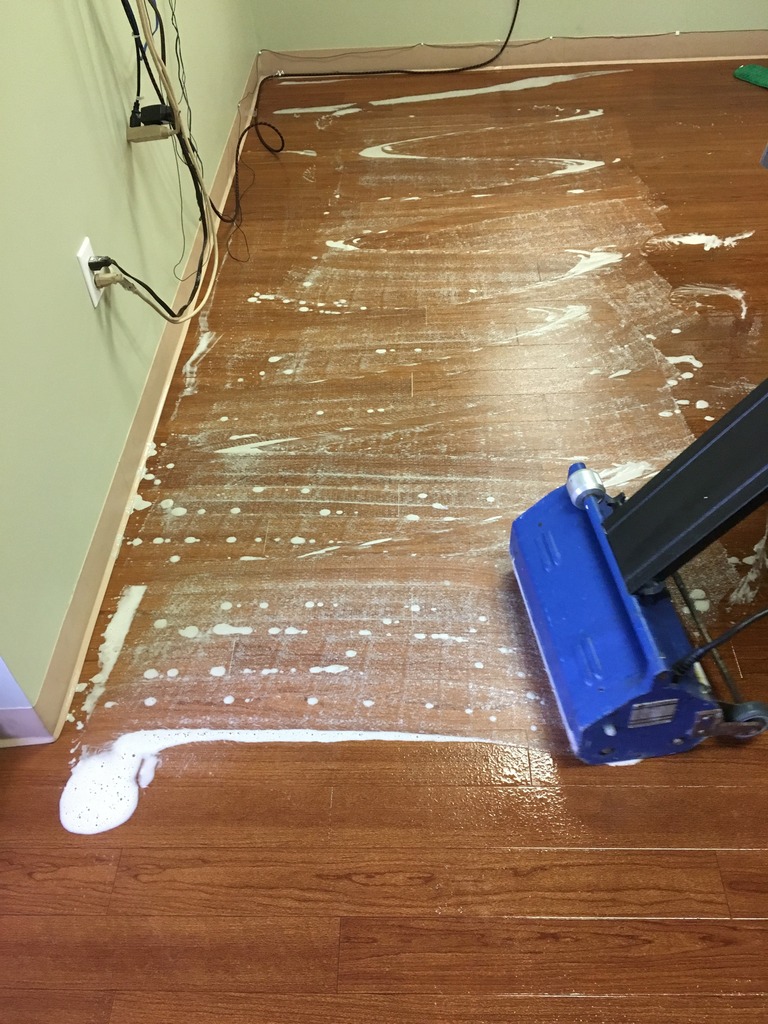

I have the 20" brush pro with standard Blue brushes, are those equivalent?

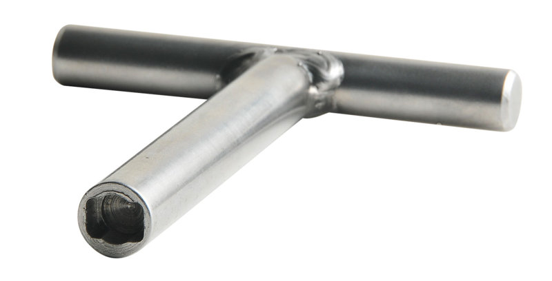

Those jets look like they're hard to access for any service that needs to be done on them. WAs that just a complicated shadow I'm looking at or is it a tight fit for the socket to remove them?

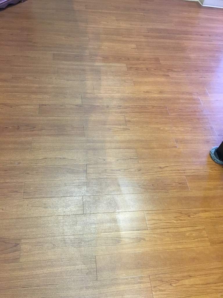

If you have a laminate cleaning procedure, it should work to clean the construction dust.
These photos are from a job where the vinyl had a texture to it. I hope the previous cleanings with a black pad did not ruin it.
We used only flat mops for extraction. A CRB is the right tool for this type of job.

Yep. Looks very similar different color. What did you use for a cleaner? Daily neutral or Bruce?
