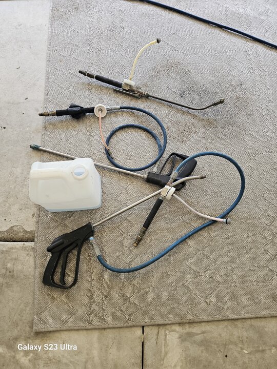

I drilled out the yellow plastic metering valve larger, but still not refilling the jug for weeks. I need to check the o-ring, but I did lightly stretch the spring and the ball moves fine, just not pulling the product. So I just removed the yellow metering valve after my last job, we'll see if that changes things. You told me on my last Hydroforce, to remove the yellow metering valve and use 4 scoops and that produced great results. TY 👍🙂
