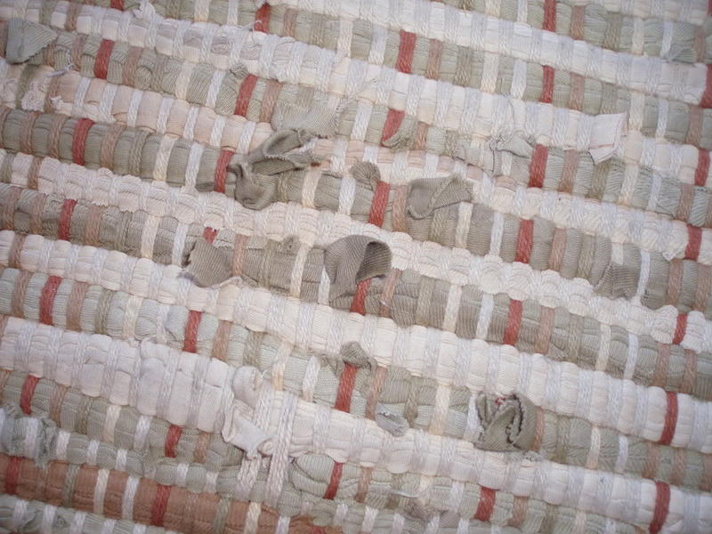

How would YOU clean this....
116,025
All Cotton construction. No backing., Lots of loose "threads" sticking out.
New @ Cost Plus $125
Apr 4, 2007
1,085
Rub bagger then bioclean and acid rince 3 dry strokes and hang dry it with a air mover.
Forgot to take the most important step. Checkmate secret, Spray the living crap out of it with coffee tannin.

I cleaned a rug very similar to the one in your picture. Only the one I cleaned was soaked with urine. To clean it I soaked it with a bio-enzyme and let it sit overnight. The next day I rinsed the rug thoroughly with a hose and flooded the rug and used a water-claw to extract the rug. I repeated this procedure three times then dried it with fans. Do not try to use a wand as it will not clean it as thoroughly as flooding it and extracting with a waterclaw. Nothing fancy but great results.

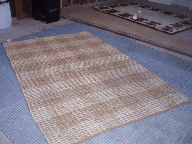

The problem with this thing is that there are hundreds if not thousands of loose ends (as you can see in the 2nd pic) that will pop out of the weave if overly agitated or "sucked".
We actually put it in the commercial wet washer.

Not all cotton reversibles that look like this are cheap, there's one line on the market that retails for the same per-foot price as an Oriental rug. They bleed easily (right on your wand line if you extract them) and lose a lot of color if you wash them. The only answer for these if the customer doesn't want the faded look is to dry clean them.

Rag rugs are a real pain to clean. We don't wash them, we have a commercial front load washer and dryer, but I'd be afraid of splitting the stitching or loosening up the knots.
We clean them flat with either a a Steam Genie drag wand or a glided wand and then drag over it to remove as much moisture as possible.
We usually do them as the last rug of the day, clean them and let them dry flat, then at the end of the following day clean the other side. They can stretched when hung wet, so to avoid that problem we just clean them flat.

I cleaned one of them in a commercial washer earlier this year and a section of the rug fell apart. (I Had to re-weave the section)The fabric is not continuous. That is why there are loose ends. Better to flood with minimum agitation and dry flat.
