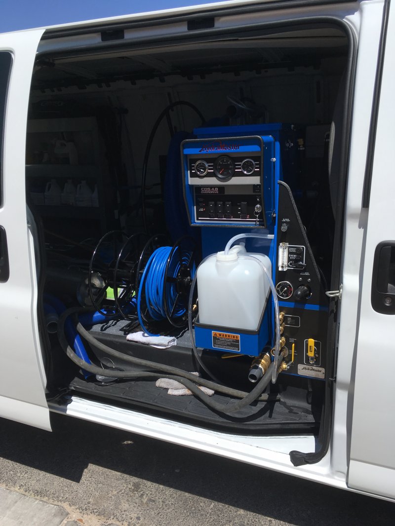

I looked online and can't seem to find anything, and was wondering if someone knows how to grease the "zerk fitting" on the axle under the hood in the engine compartment...Matter of fact is it easily accessible?
I just purchased this unit and I can wait to ask the people who installed the unit, but I am anxious in finding out so I don't have to make continual trips to the shop...
I understand the other fitting is in the doghouse on the other end of the axle...Which seems possibly easier...Again no real how to on removing the dog house as well...
I just purchased the CDS 4.8 w/2016 chevy 4.8 I am pleased so far...Especially with the electric vac hose reel...

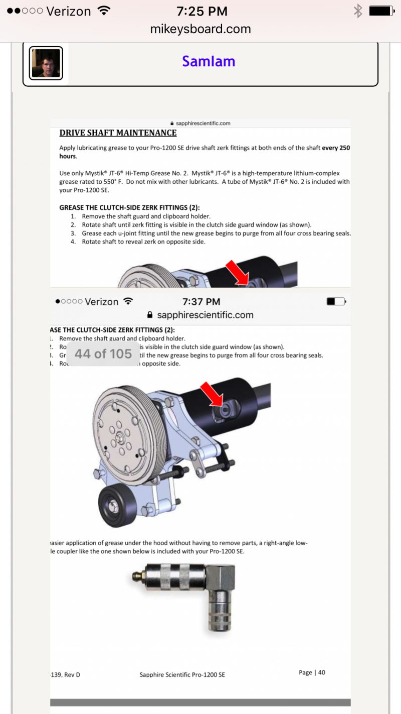

This image is for the pro1200 se you need the grease gun fitting at the bottom of photo and line the above response said there's a few place to grease so keep
Rotating and filling.
11,297
You know I complained and got the grease gun fitting but I didn't get the tube of grease!
Says right there in the manual grease included DOAH!
