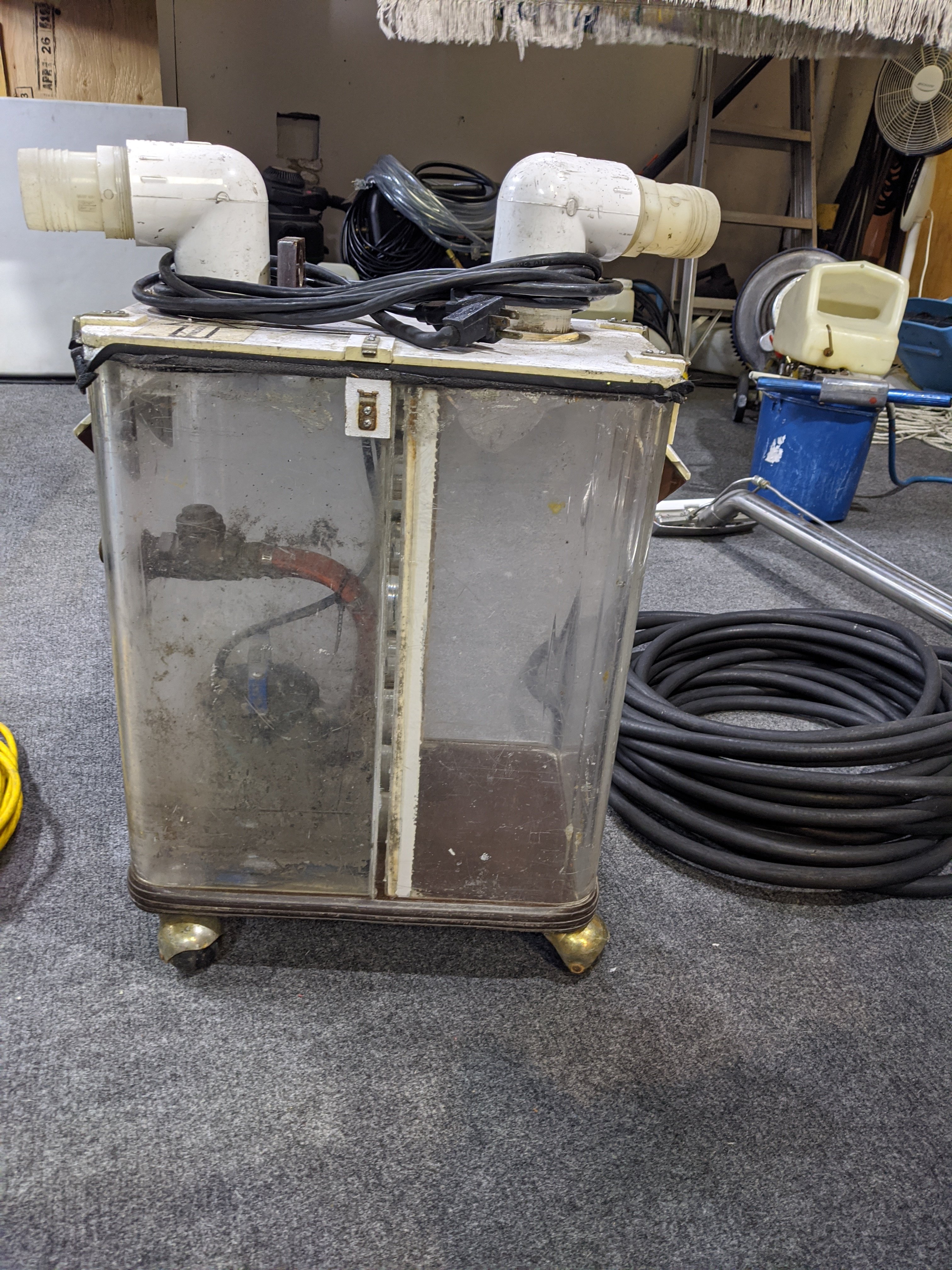

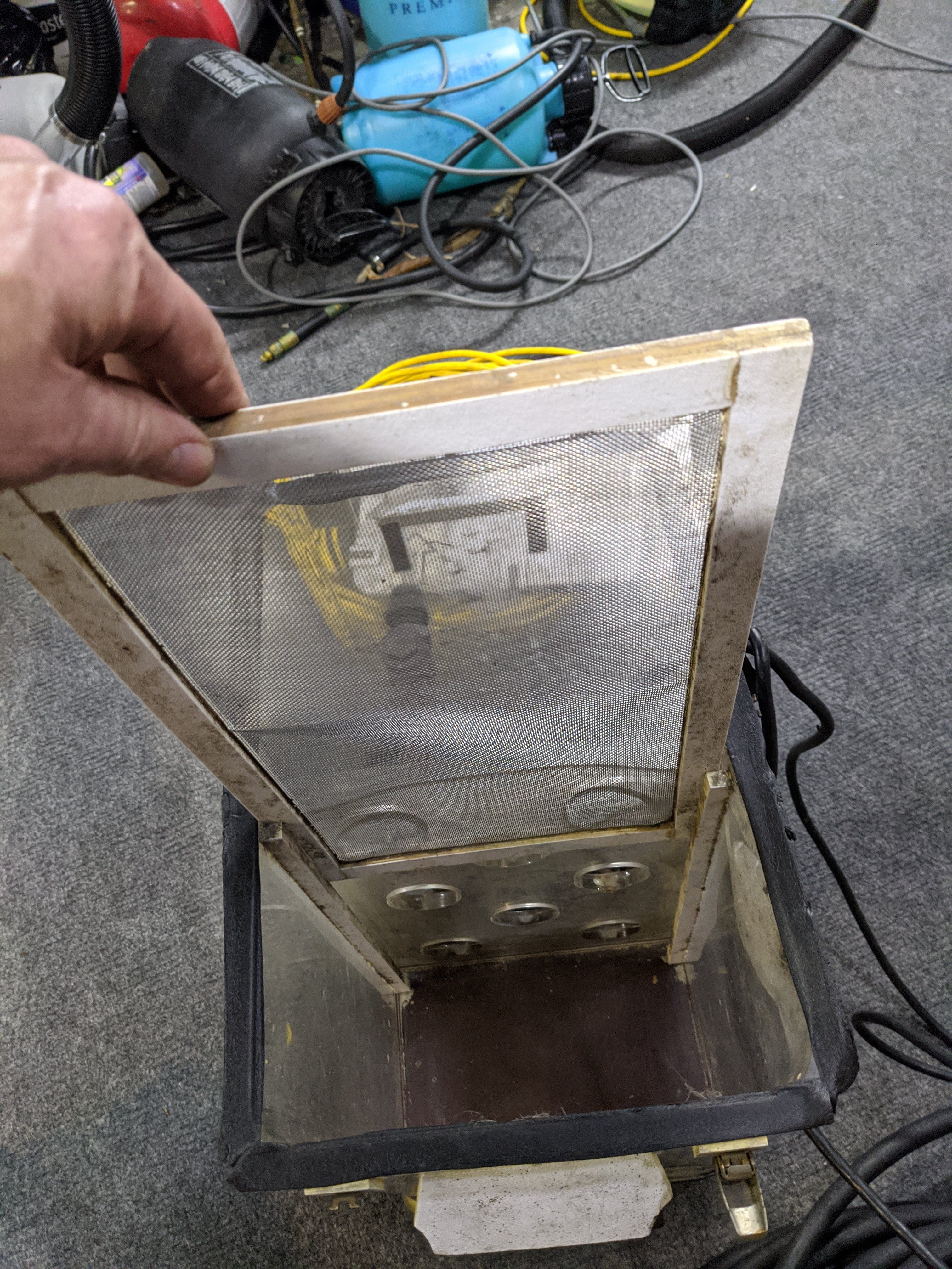

This is the only inline filter I use. Over 25 years old. I have 2 of them. Large screen filters out debris and pump out lets me clean all day long. It would be nice to see a new, improved version. Clear plexiglass keeps the customers mesmerized by the dirty water.
View attachment 95615 View attachment 95616
