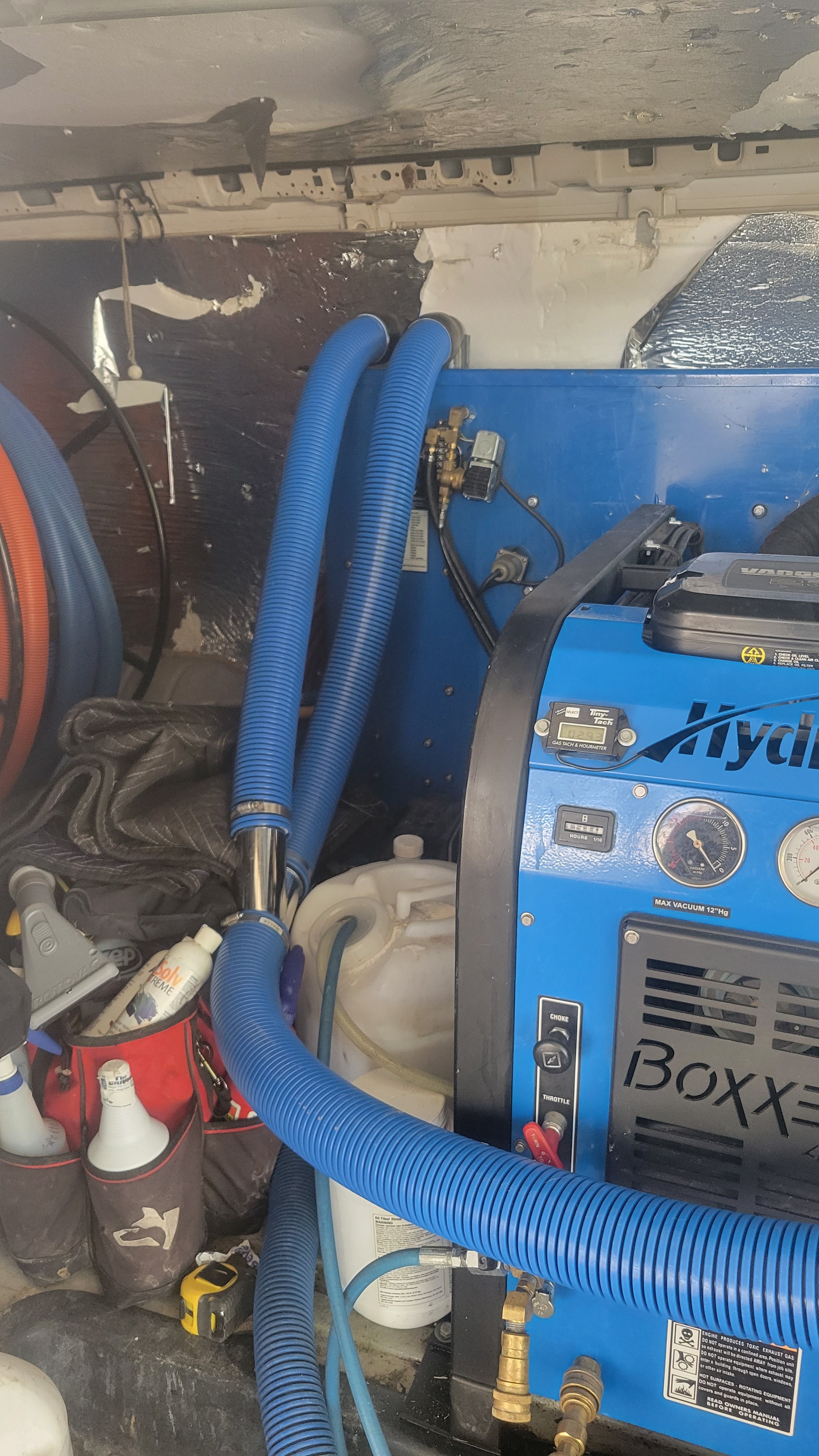

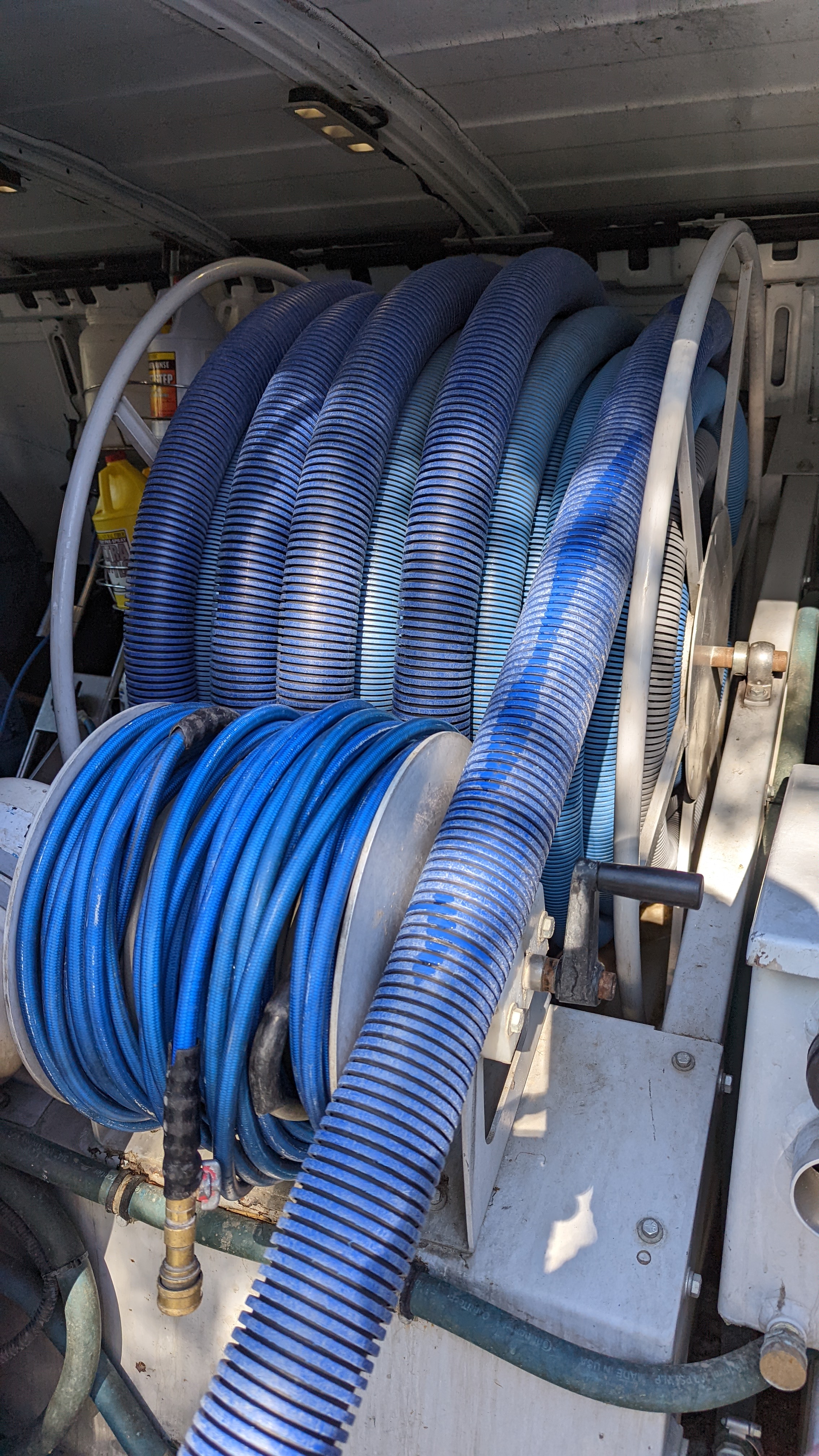

That's the way it comes off the reel 2 small 2.5 leader hoses to filter, 50 ft of 2.5, the last 200 ft is 2 inch.
My 15 foot 1 1/2 stays in the truck.
