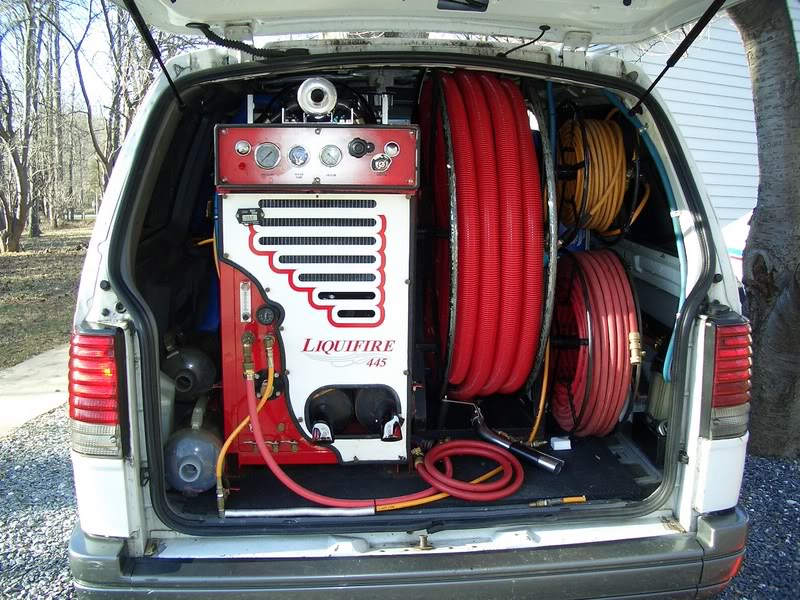

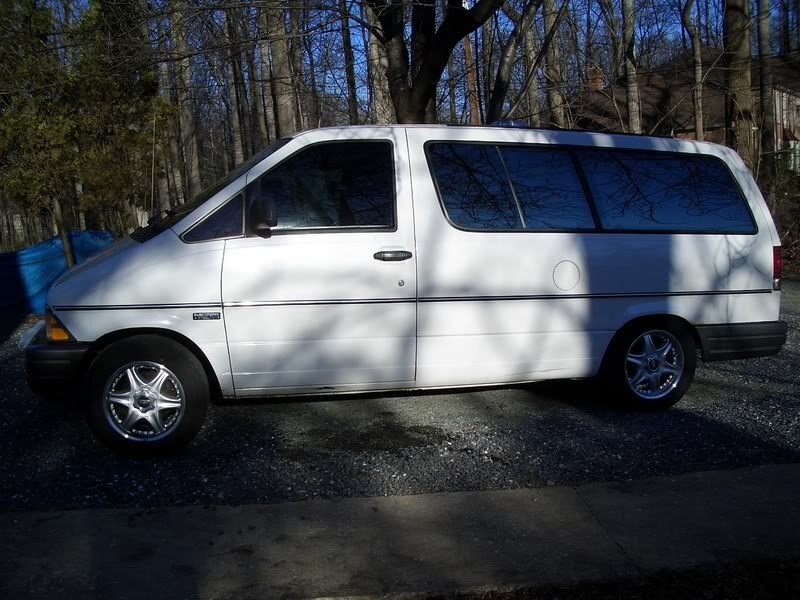

I Just recently transfered all equipment over to my new mini extended Aerostar 4x4, I decided to maximize space as much as possible.
My narrow TM footprint allows me to run this awesome rear mounted configuration. Everything is at my fingertips. My equipment and I are protected from bad weather due to the overhead protection of the hatchback. That mainly is why I use a mini. If only there was a full size van with a rear hatch.
I'm such a nut for keeping everything in its place and in top condition.
My re-located, re-designed, ceramic coated custom exhaust I came up with SS heat shields, no more belt failure and component cooking!
I try to use every inch of space
I'm proud of all my hard work turning this bitch from a multi-problematic lemon into a high performance beast. She is tricked out and back with a vengeance! Many thanks for all that helped me with my numerous failures and problems over the years.

Fast Eddie;
I know you've spent a lot of hard work on your van, but I think it is unsafe because of the propane bottle behind the seat.
In the second picture, the little circle on the propane regulator is a VENT. It will release propane if the temperature in your van gets too hot. The pilot on the heater looks to be about 18" away.
It is clearly illegal in most states, including Texas.
Go to an external tank for safer operation.

"If that thing hits and kills someone else"
Adam, can you please explain a little more in detail what you mean by that and why my set-up is so much more dangerous than average? Besides the LP bottle, which Larry pointed out, which I was aware of and kinda sketched out about it from the start. A year has passed with no issues though.
I would think that having a half ton TM, like the majority cleaners do, mounted directly behind the driver and passenger seats would have a high degree of danger involved in case of an accident as well?

I really don't have any tools loose and laying around. The ones up front are strapped down using a rachet strap which I removed for the pics.

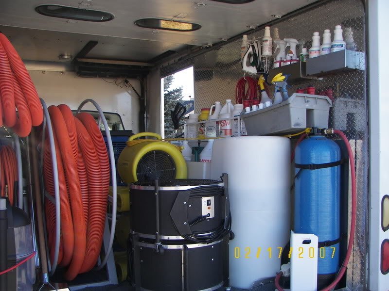

floorguy
Nov 7, 2006
6,948
Utah
Doug
such is one reason businesses have such ahigher minimums for insurance...
no i can pack some stuff in my van(pics later)...but that scares me....my van doesnt put of heat like that would....think about how hot that stuff gets and in such a tiny space...
oh and as far as adams comments go........hes dead anyways if its anything near serious...

"If I saw a minivan sagging down in the back way over loaded causing way more wear and tear on the brakes, shocks and struts then ever were intended for that van"
I hear where your coming from Adam but I have a beefed up suspension with extra heavy duty springs in combination with rear air shocks. Brakes were upgraded as well. The van handles very well and stops just fine. As far as heat build-up I have no issues due to the radiator fan mounted on TM moving large amounts of air out the back. I also have a solar vent that exhaust air out 24/7 during the warmer months.
I am going to work on getting a LP belly tank or going back to H/X heat. Eventually I will get a full size cargo.

There are plenty of mini-vans around here with the small belly tanks, that is a low cost smple solution, and would free up some more space.
I'm not sweating the tank in the truck cause I know Eddie runs with the doors open when the tank is turned on, it only takes a mild draft and "off gasing" is not an issue, it's not a bank vault.
