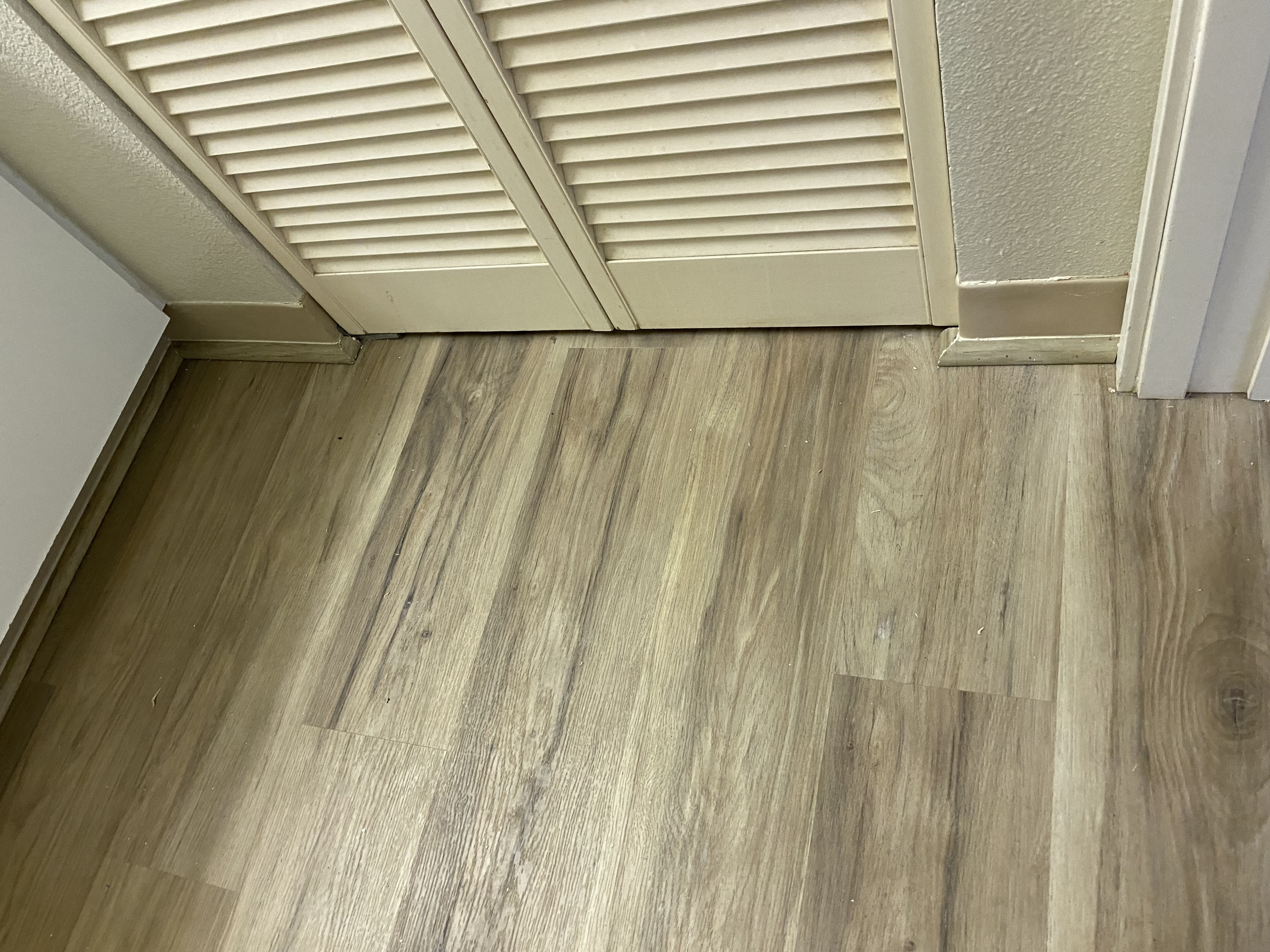

Don’t know the height of that cluster fook but if 5.25 mounding won’t cover it, that house should be burnt to the ground
Lower income condo.. You want to burn a $650k condo because of the moulding?!? :rockon:
I'm right there with you! :lol: I've seen some real sh!t work, but this one takes the cake.. Standard 4" rubber cove-base which they probably reused knowing the nature of the building..
