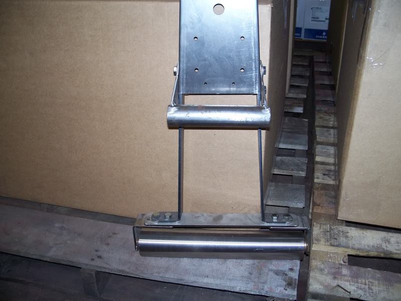

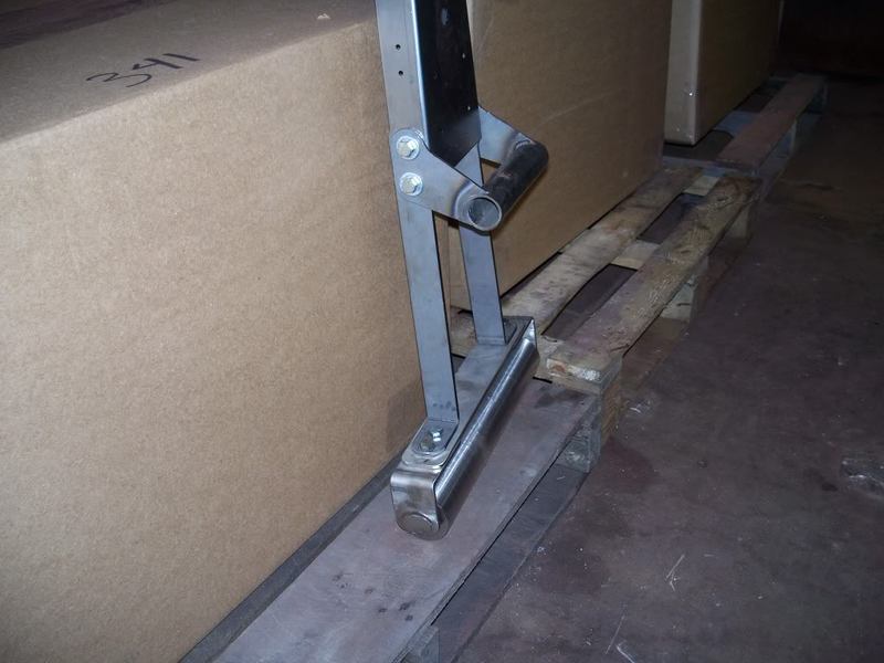

I'm not sure it's tall enought for you. I may need longer struts. Solid stainless steel roller, SS lower bracket, and the top will be powder coated red or forrest green. So what do you think Mr Mikey? Having all the handle parts makes it easy to produce fast. I will cover the switch hole with a plate.

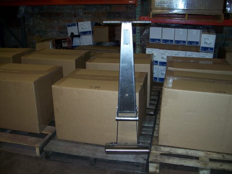

Hello Larry, It is 35 pounds. The roller is solid 316 SS CR and lower bracket is 304 SS plate. The upper I would like to go with a telescoping tube for a long reach. It would help with storage as well. The handle I have on it works well. By the way this is a Rug Pit Roller Squeegee. It is in production now.

If that is a standard pallet the handle only looks to be one foot off the ground. :!:

I really like the idea Clark..BUT If I was making it I’d ditch the stainless handle go with a broom handle fitting and make the roller 2ft wide. I know the idea is to give it weight but run that thing repeadly over 2-3 9x12 rugs and you’ll know what I mean.
I have the master blend roller it’s a nice tool yet ergonomically unfriendly and too narrow to be useful so it sits and collects dust.

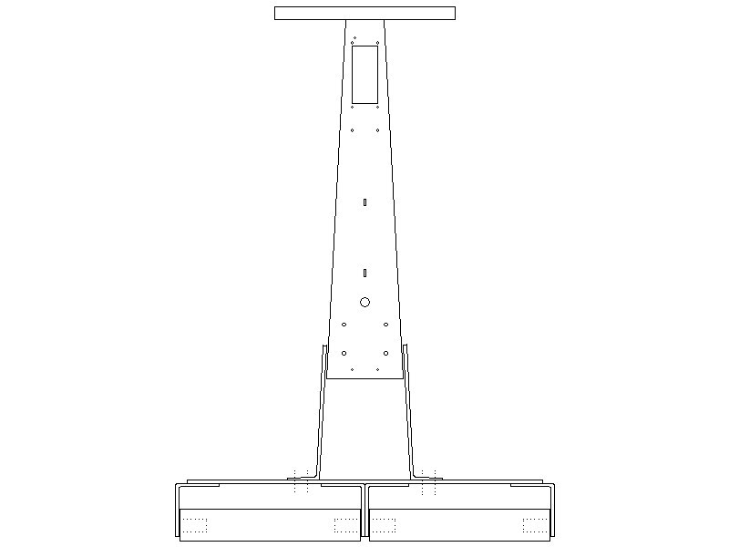

There are two models. One 14 inches wide (shown) and one 28 inches with 2 14 inch rollers. What about the handle would make it easy to use? And the MasterBlend unit has plastic rollers. The lower handle is to pick up the unit and carry it.

1, I’ve been down this path years ago… If the key is to compress the water out of the rug after washing it’s one of these ideas that sounds and looks good until you actually use it. The reality, it’s a time/money waster you’d be better buying a pallet load of Terri towels from Costco and patting the rug dry. A wet dry vac works much better
2, If the idea is a squeegee for washing it could be very useful as a roller squeegee and an alternative to a bladed rug squeegee. A rollers squeegee is more efficient, less fatiguing, but it needs to be lightweight the Master blend tool lacks ergonomics and is too heavy & narrow to be useful. You want to know what works best. Extra wide paint rollers, problem is they don’t hold up to the use but they work great. What makes them work well is light weight and the paint roller itself contours to a rug’s high and low areas where a static steel or plastic roller cannot.
Here’s what I’d suggest, Ditch all the heavy stainless steel, make it light weight 24”- 30” wide and allow for the end to pop off so paint rollers can slide over the steel/rubber or plastic rollers and be changed out as needed.
