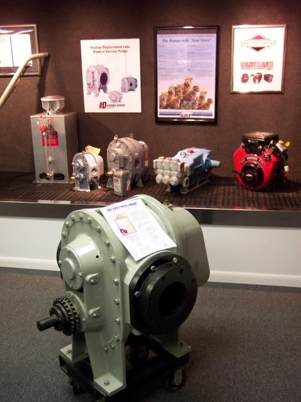

Ashley, once you pull the endplate off the blower, you can use a punch to knock the bearings out of the housings.

Ashley Mckendree
LES
Thanks for the help Les! But witch one is the end plate?
I made a reference image using your blower photo, is it #1 or #2 on the image:
AshleyMckendree
Sep 1, 2007
1,572
Versailles ky
Ashley Mckendree
The endplate is # 1
Thanks.
I what I have is an old Sutorbilt #5 MF That spins freely, but has hardly ANY vacuum.
The main shaft can move about 2mm forward/backwards and I just figured the tolerances where all out of wack and the plates needed to be machined perfectly flat.
Or maybe the bearings are old and worn and allowing the lobes to move a little?
