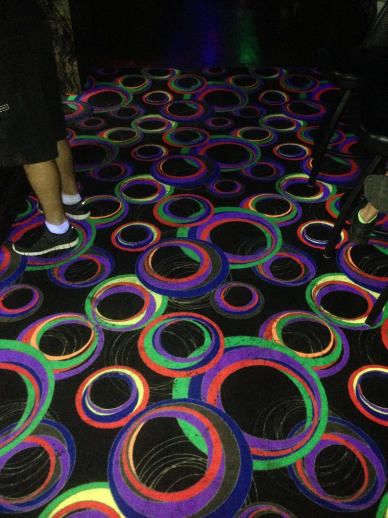

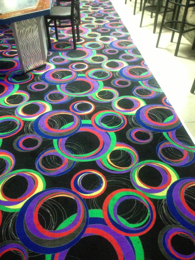

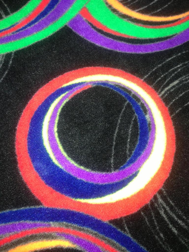

here are the pics of the strip club carpet
davegillfishing
2,229
st augustine fla
dave gill
less than a month old..never cleaned..manufacturer told them to hwe it and then protect it..it came from factory with protector on it.
it glows like crazy in the dark..kind of creepy actually

Most manufacturers of fluorescent carpet warn that high pH cleaners may accelerate the degradation of the fluorescent properties, so you may want to watch your pH. Also make sure nothing you are using contains any optical brighteners.
davegillfishing
2,229
st augustine fla
dave gill
yea you guys should see it in full swing..with all the lights blinking and light dots running all over the place like colored bugs..its crazy.
i really dont see how anyone doesnt get motion sickness in there..
i will watch the ph on my prespray and i have to see if powermax has any optical brighteners in it..

The advice to watch the pH is very important. Some manufacturers say no more than 8.5, others say Neutral. So, stay very low.
Because you can't hit it with the strongest cleaning juice, it should be cleaned and protected fairly often. If the soil levels get out of control, it will be difficult to clean without high pH.
There is an article on Glow-In-The-Dark carpet and how to clean it on Cleanwiki - http://cleanwiki.com/technical-resources/ Look under the Technical bulletins selection.
