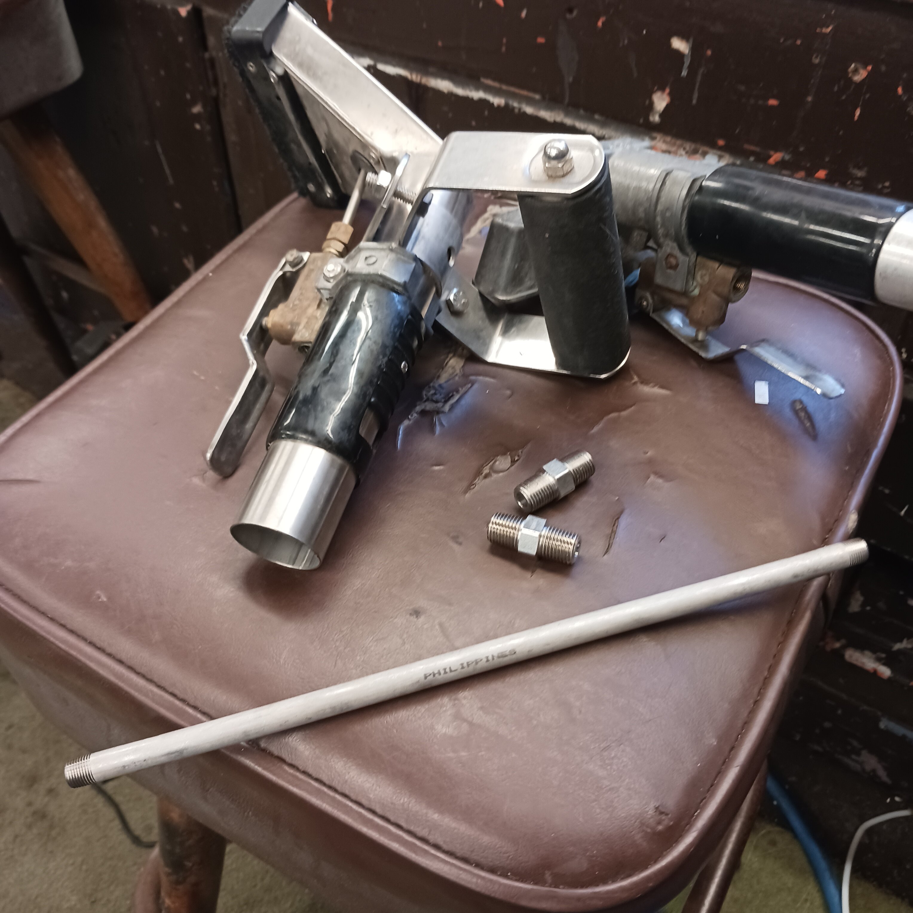

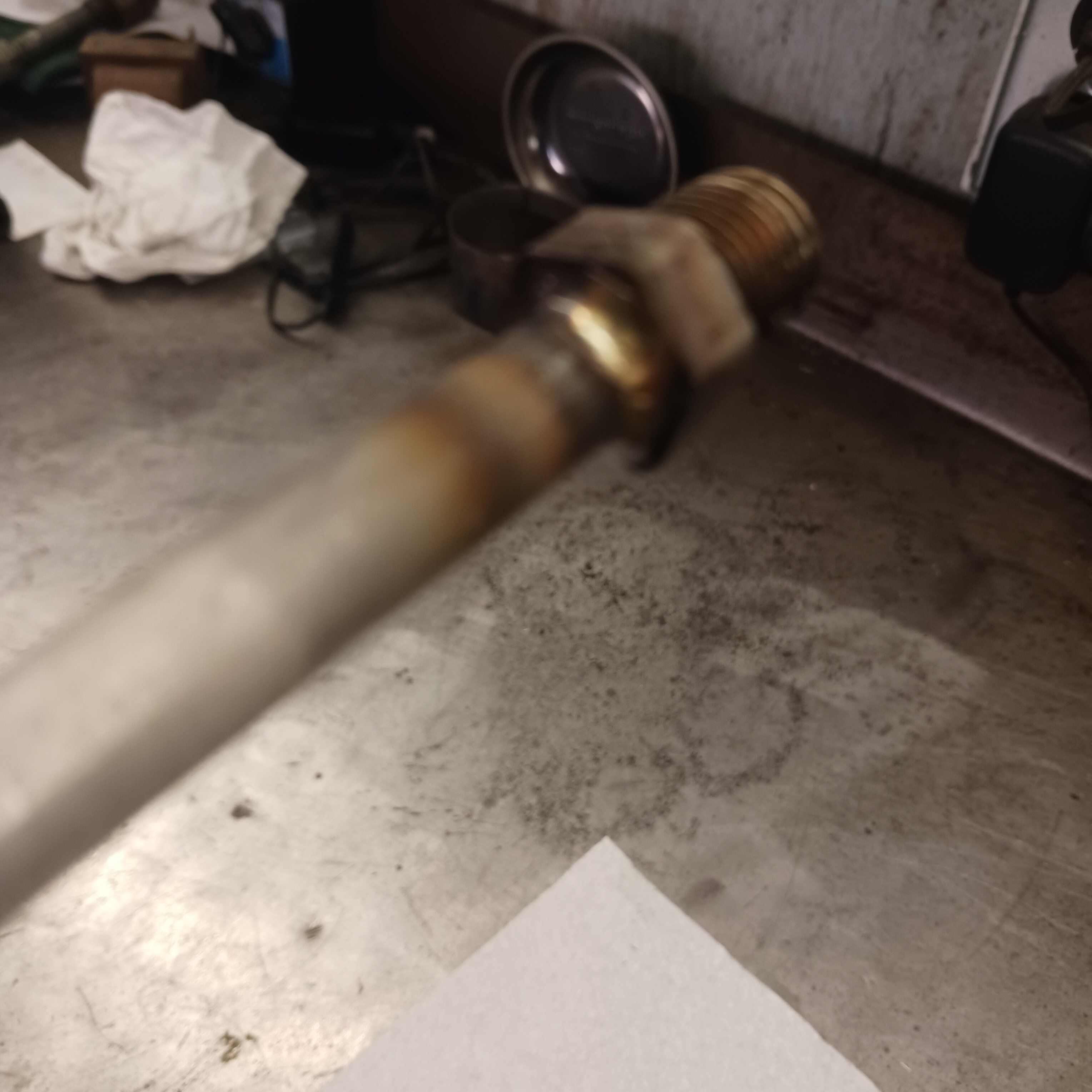

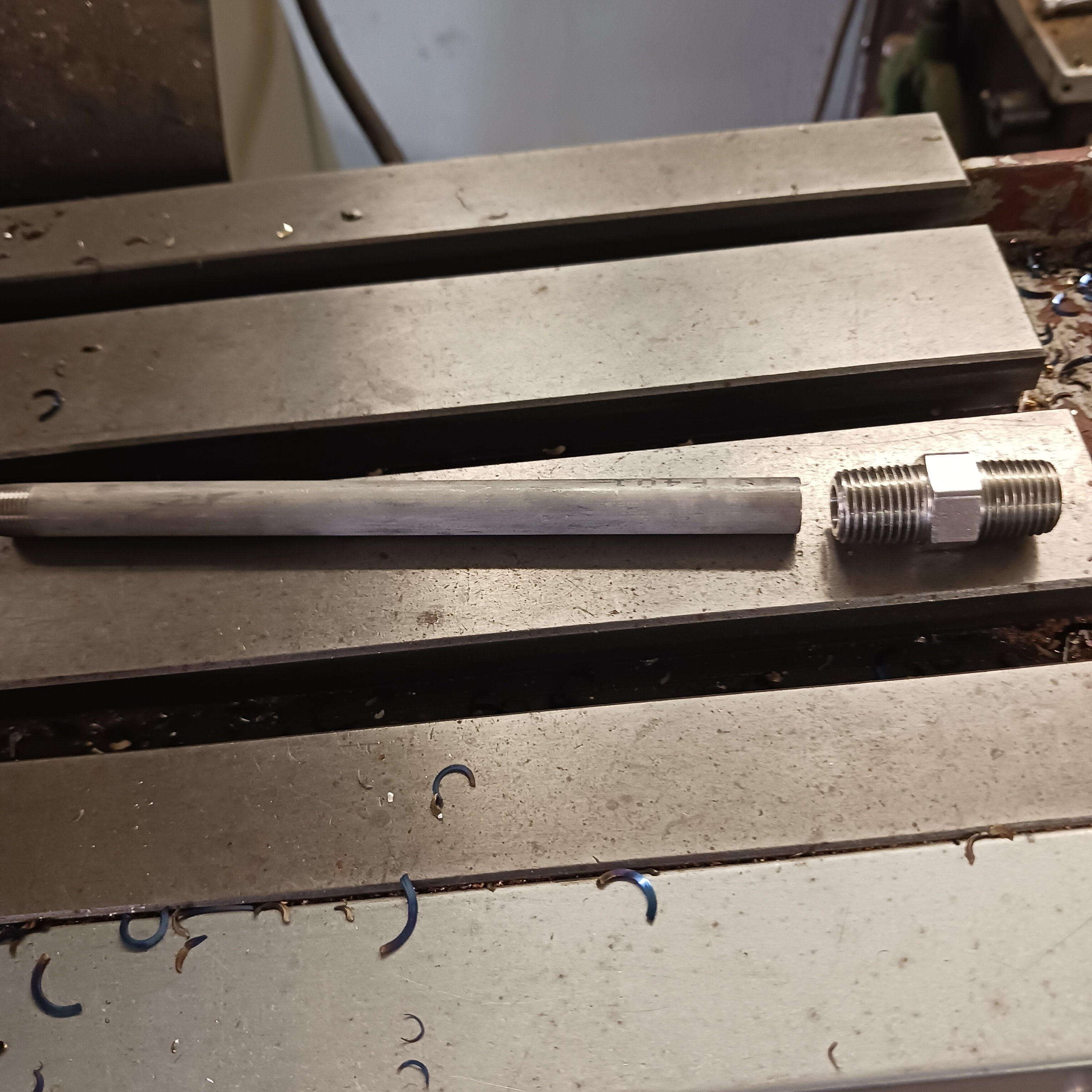

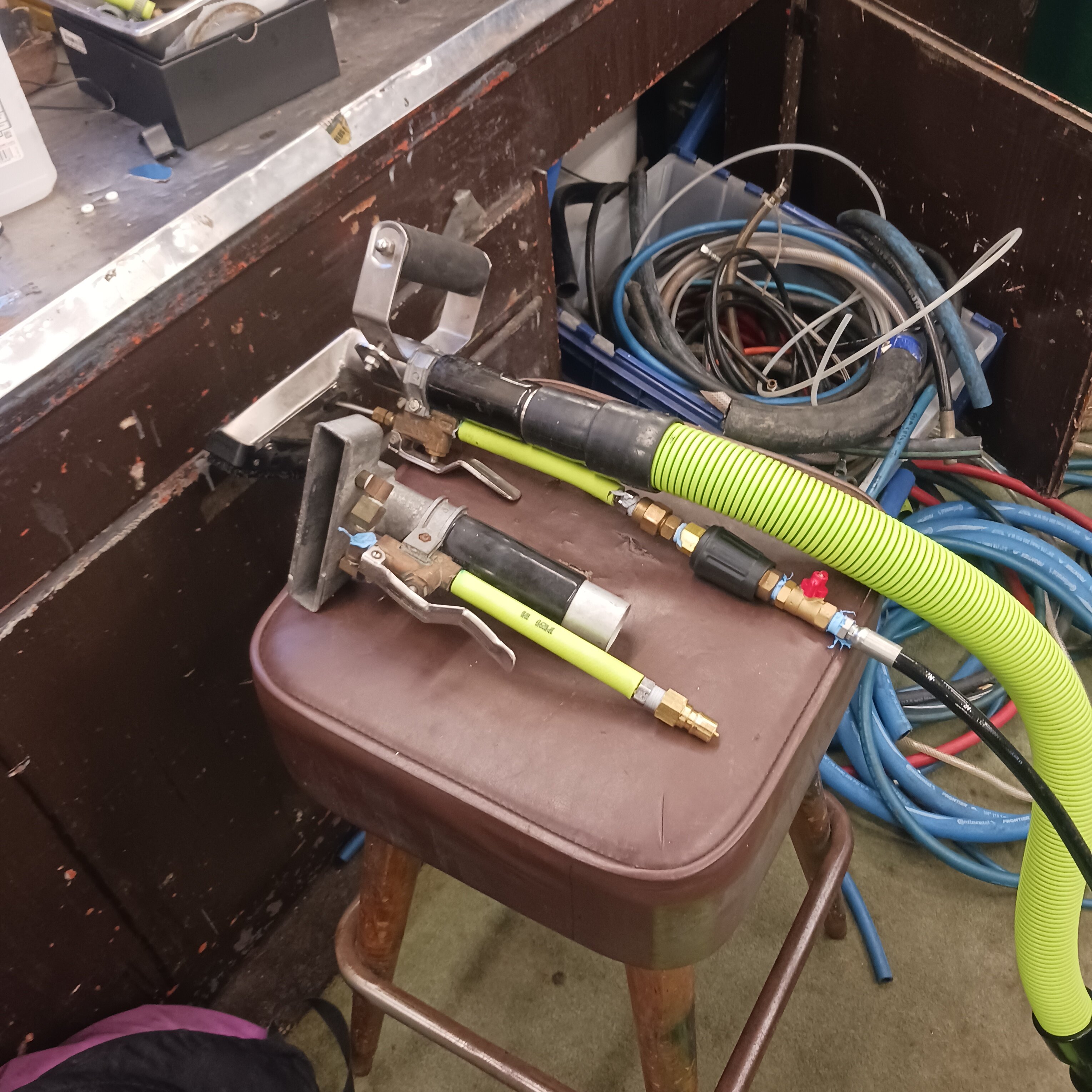

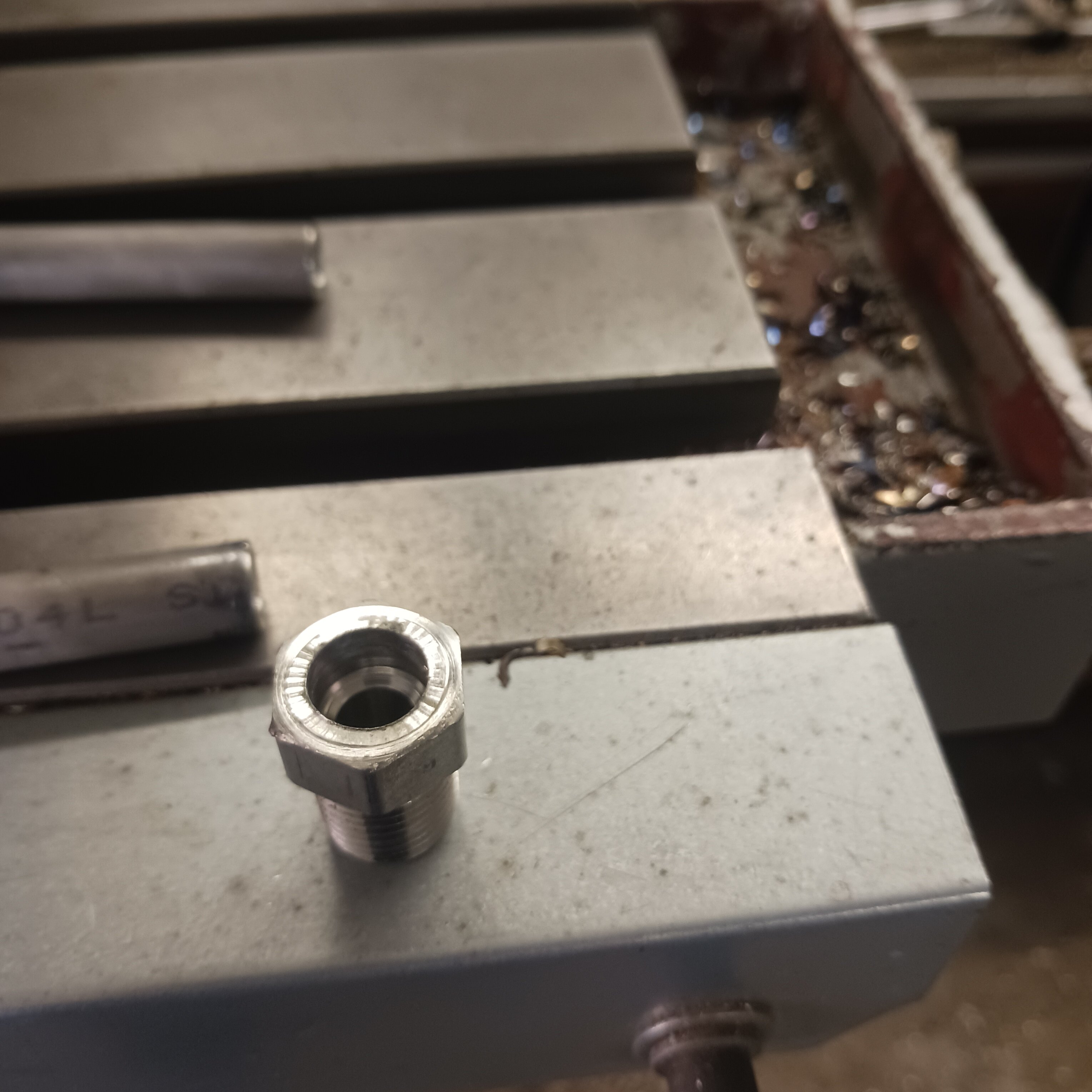

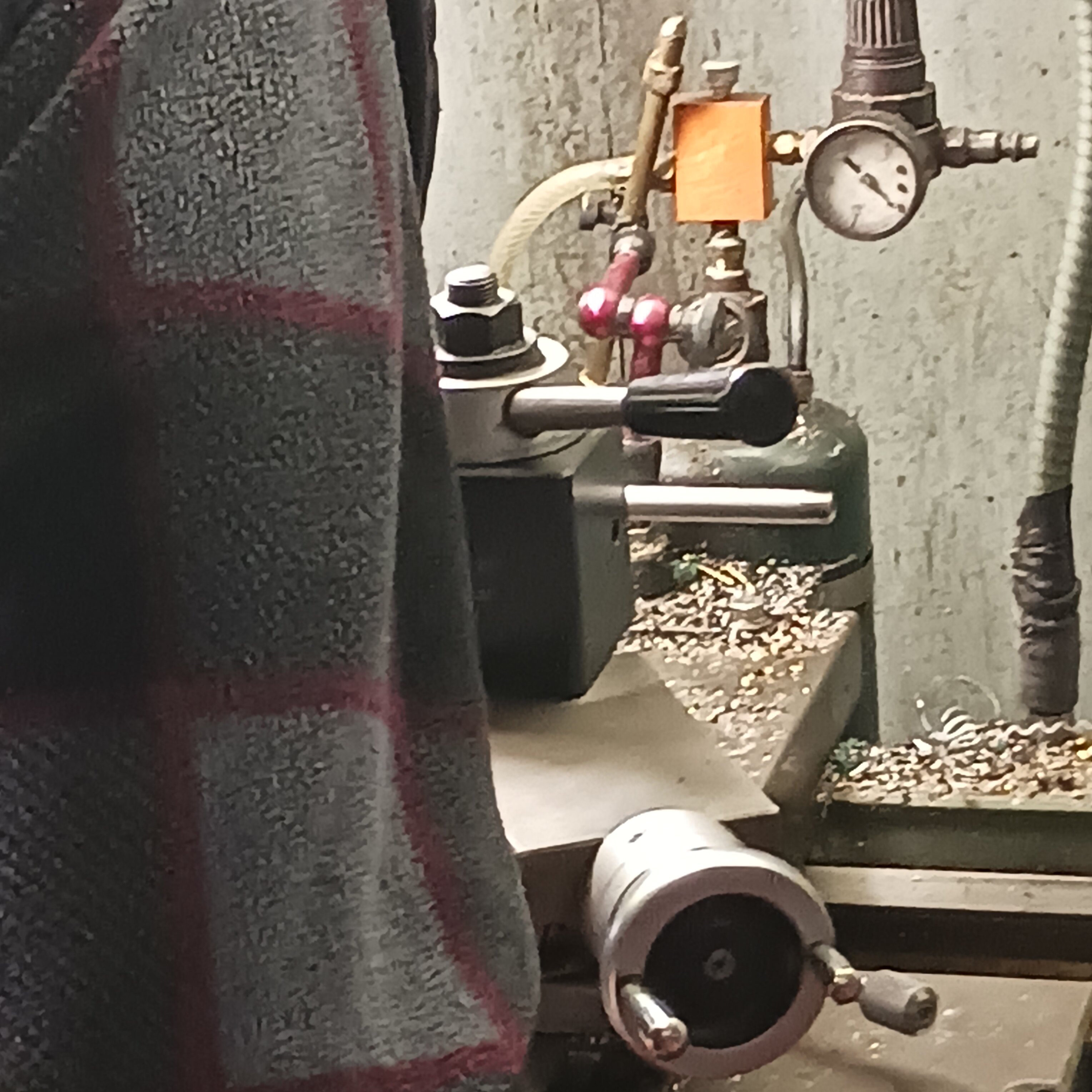

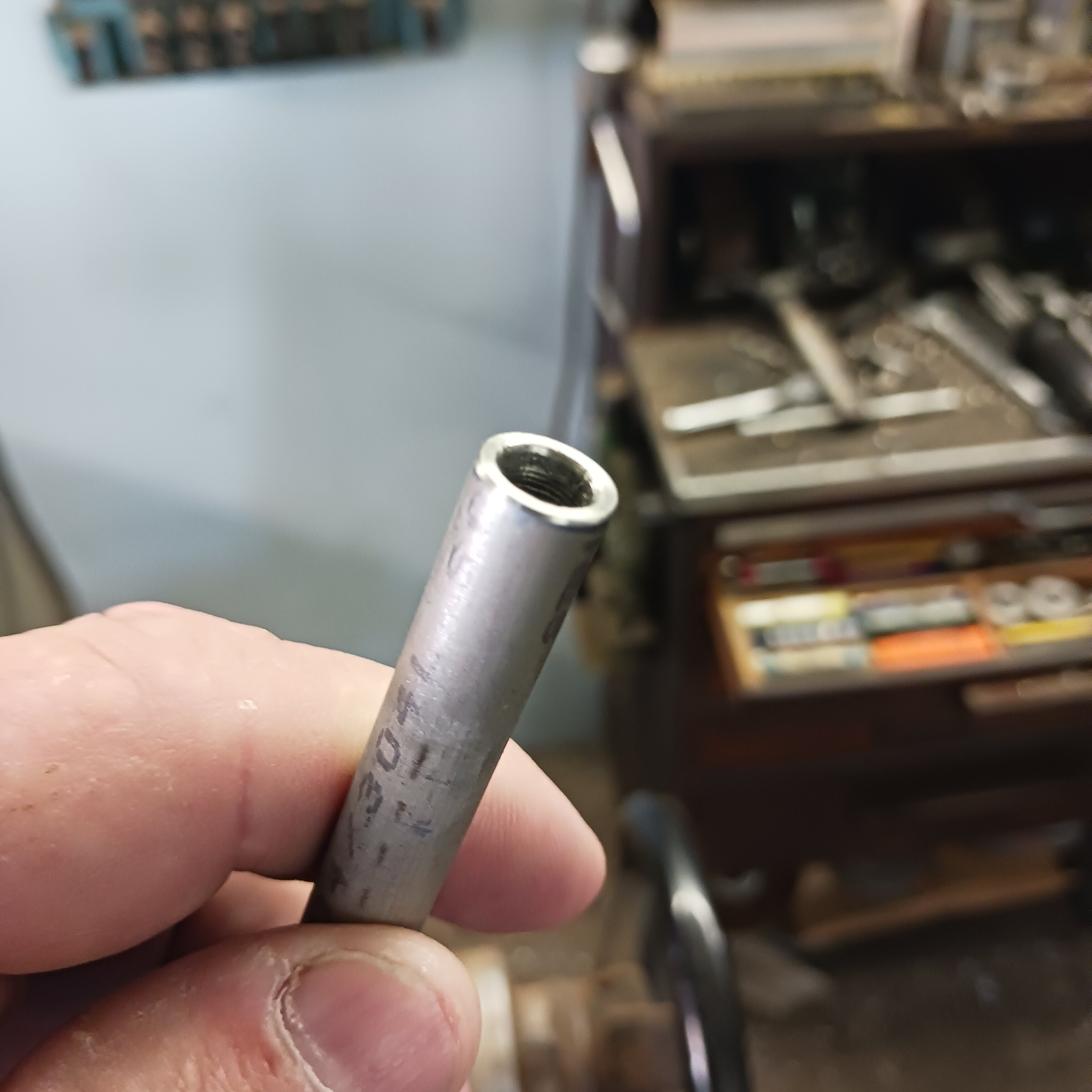

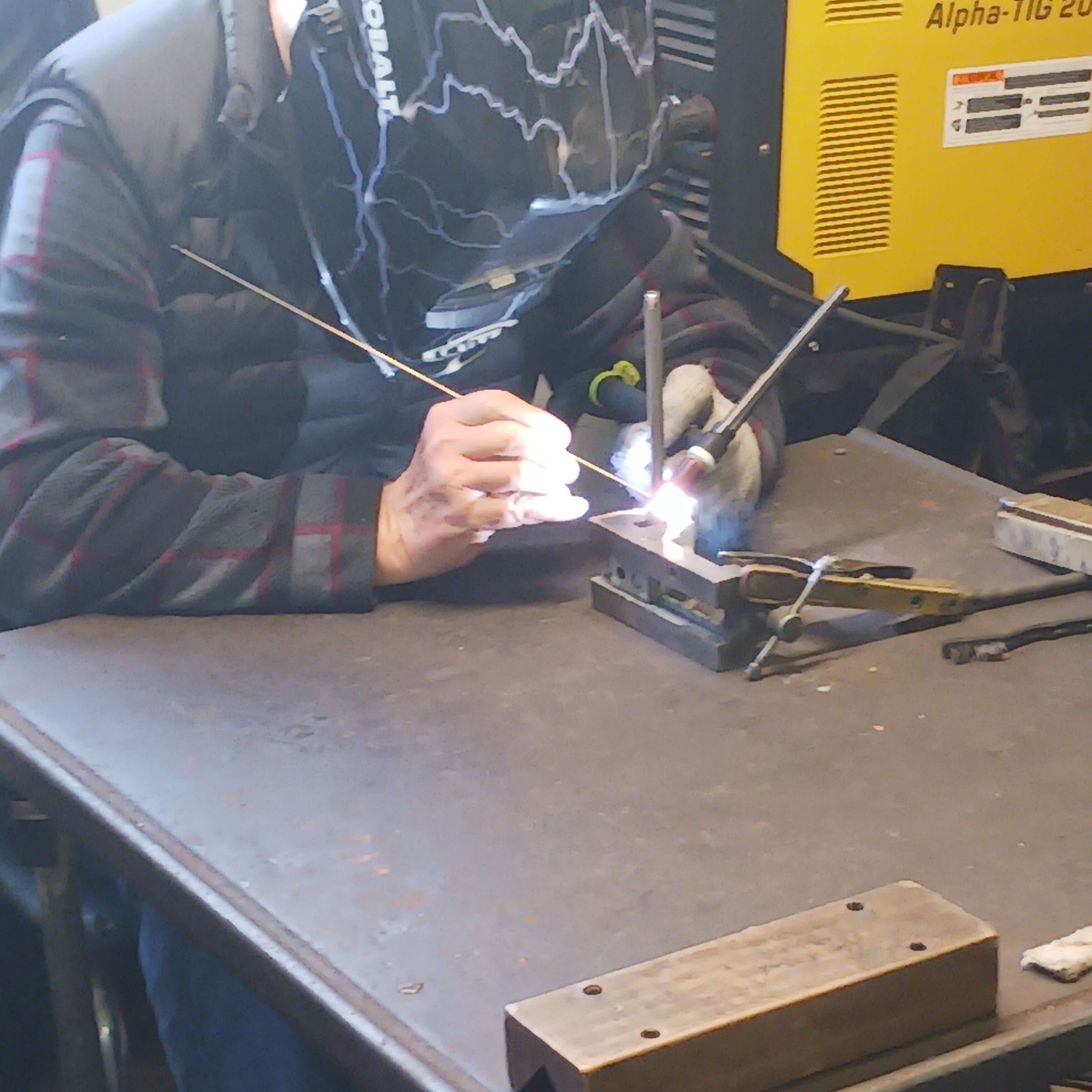

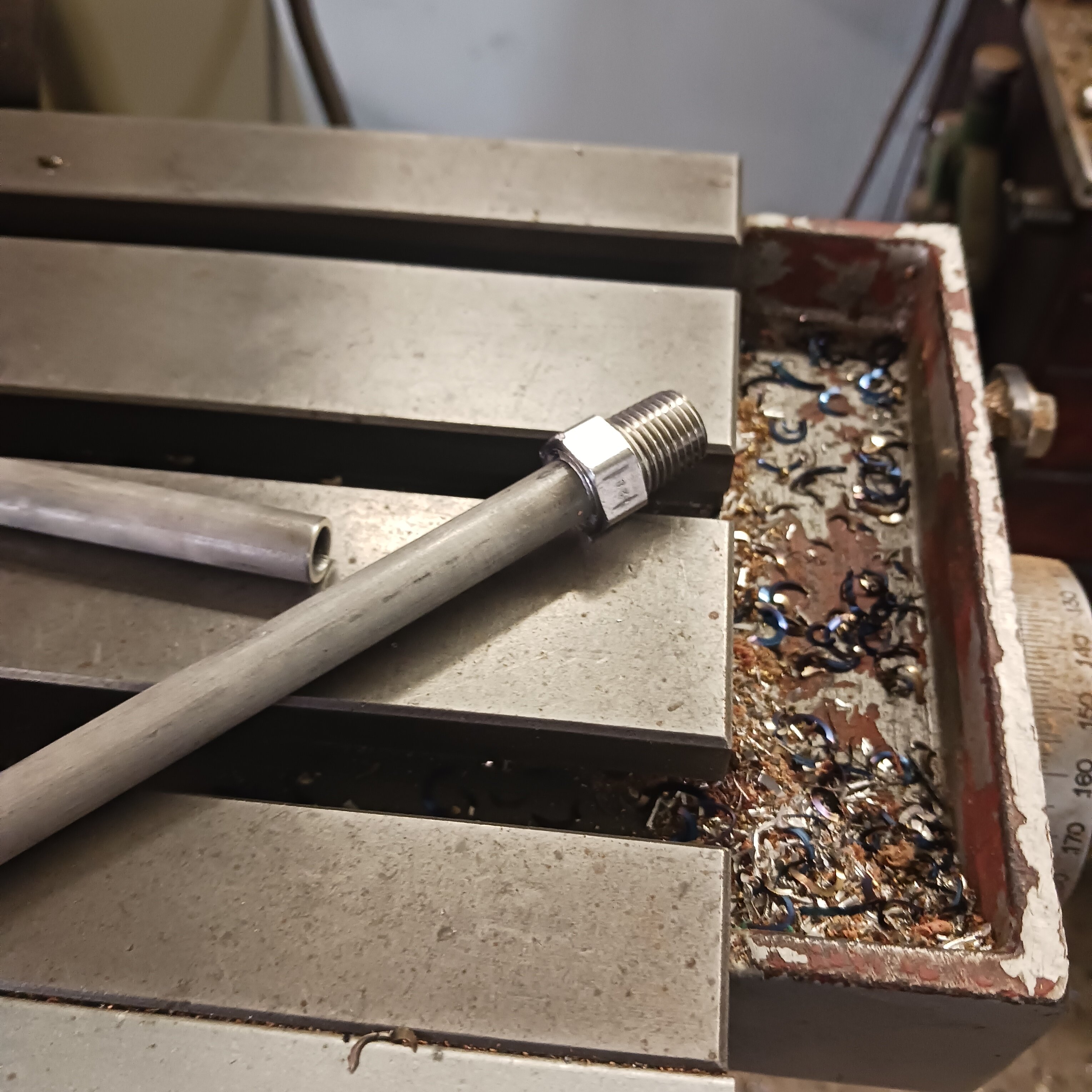

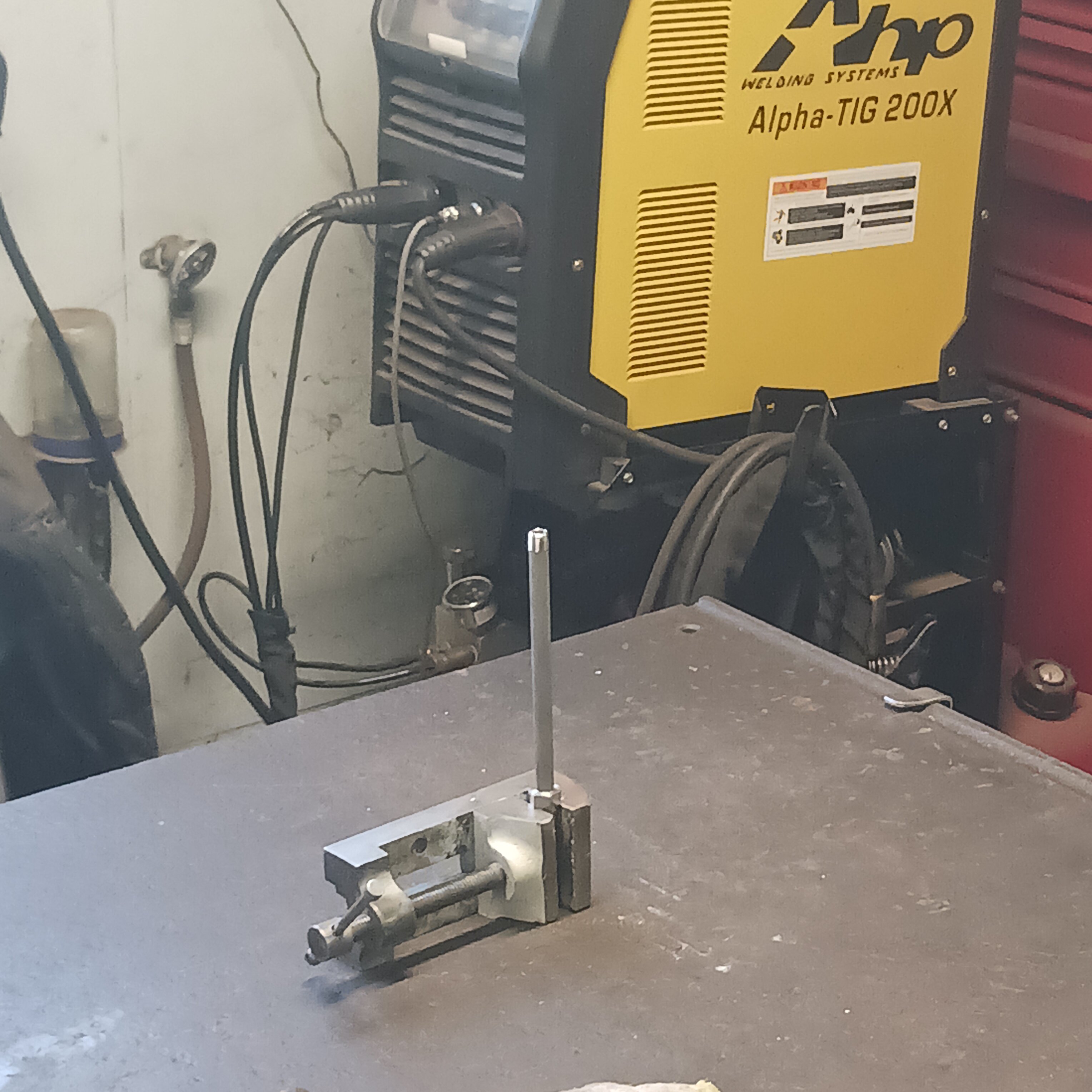

My latest project is to make the tile tools i bought on ebay all use the same custom gekko hoses. He wanted 10.00 to drop what he was doing do all that machining and welding while i waited ( i gave him 40). Took um back to my shop polished (to make the ⅜"id insulation hose slide on easier) alot lof silicone spray and alittle effort and it looks store bought! (But better.no stacked fittings!) nipple ⅛"mpt×¼mpt×6"long insulated woth ⅜id flexzilla hose. One attachment has an hydroforce inline filter. Other attachment will get a filter too (only had 1 on the shelf)

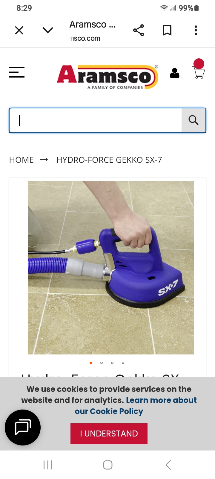

Its a gekko setup, its only external enough ( about 12")to connect attachments designed for external hoses like the gekko sx7 then its internal solution line for 9'
