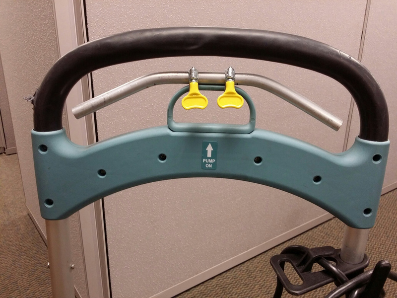

i have a feeling nobody has.
the Trio's trigger for the solution system looks similar to the GLS's setup. on the handle in the center. this is not the best design. 1 or 2 handles offset from the center would be much better (for ergonomics.)
has anyone altered theirs in this fashion? or put some type of a bar across the existing handle so that both hands can squeeze the trig? if so can you share with me how you did it? i am going to attempt it this week but wanted to see about other ideas.
thanx!
Derek
2,166
NY
Derek
for the sake of future Search'ers, here's what my buddy and i came up with. the bar is aluminum, very hack-saw'able. bent it with a pipe wrench on a garage floor. hopefully Whittaker will update the trigger & the handle someday...

Jimmy has the on board sprayer but has never used it because the tank is too small.
He just prefers to hose out an area with his 100 psi sprayer and scrub over it.
But he has added a straight bar across the handle so he doesn't get wrist cramps.
Easier to handle.
