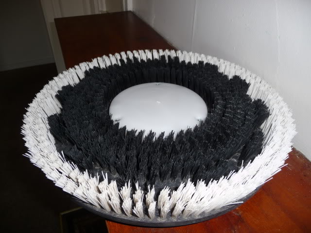

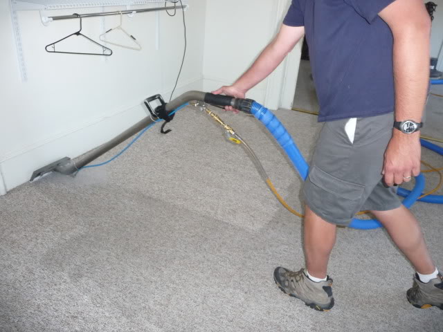

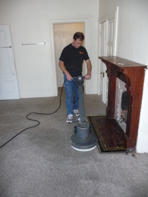

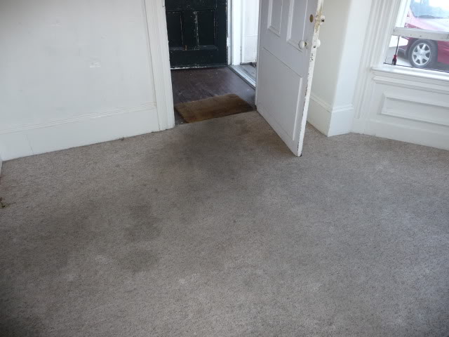

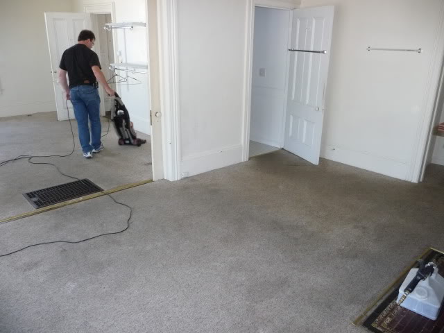

Ghetto but I gots my new shampoo brush.
116,397

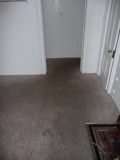

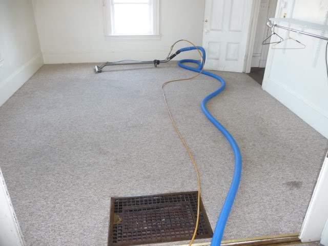

after shampooing , before rinsing.
I owe FIddy an apology.
A Shampoo brush does work every bit as well as a Fiber Pad.
But I'm not convinced yet that it's better.
siddy cent a foot for that mess KP, eat your heart out.

I don't have any idea who this thread was directed at, but you seem to forget that it has been ME, the king of pork, that has been telling you to get a shampoo brush for years!
On residential cut piles, it's better than a scrub pad.
On CGD, the pad is best.
I never get any credit around here!
116,397

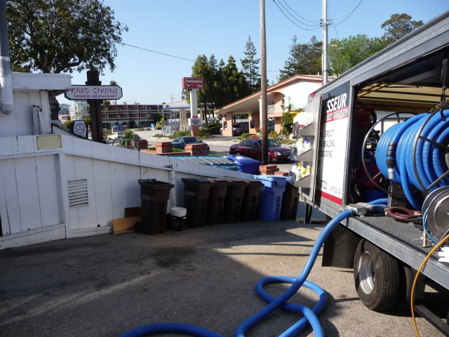

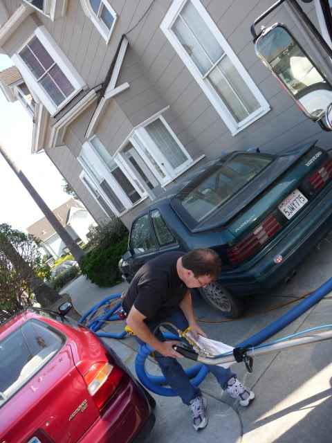

Yeah, I left a real clean spot on a asphalt drive way @ my Realtor's office :shock:
I should confirm what Marty said, it works about the same on Berber but better/deeper on piles.
Especially a 80 ounce plush we did yesterday.
p.s Marty, if you ever want to be taken seriously, ditch the Castex's are great wands comments

What you guys are talking about is called "Showcasing". Where you pre-scrub with a 175 and a shower feed brush. Talk about old school. What's next? You're going to start touting the benifits of Host for resi? Give me a break.
Have you ever heard of fiber distortion? Sure, the rug looks great for a while. But, some rugs look like hell after a few weeks because the yarns can become untwisted and matt down twice as bad as before showcasing. What a terrific service you just did for the custy.
No thanks! If i can't get her cleaning using my RX then forget about it and move on. Besides, those freaking shower feed brushes are a beaaatch to keep clean. Then they stank after a while too cuz of all the crud build up. If you must use an adjust-a-glide then do yourself a favor and get a couple afro-picks to keep them halfway clean.
Word to the wise, if the rug in question absolutley needs pre-scrubbing then pre-condition as normal, then use the RX to aggitate without vac or steam. After agitation then connect vac and steam and clean as normal. Less distortion that way.
175 to pre-scrub. Give me a break! hahaha......
