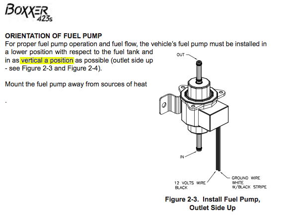

Just another thought here about fuel pumps. If the pump sounds like it is trying to pump, sometimes what looks like a bad pump can be fixed by priming the pump. On occasion if I run my fuel tank to low while driving the truck mount pump will not pump after I have filled the tank. I will take the suction side hose off the pump and gravity feed the pump to get it re-primed. My current pump has over 3000 hrs and still going strong.
5,856
Shawn Forsythe
That is great advice with mounting it under the van on the frame.. make sure that it is mounted horizontal and not vertical too.
Brent, not true about the orientation. Some fuel pumps absolutely MUST be mounted vertically in order to function properly. The pumps that Hydramaster uses, and many Prochems use must be mounted nearly or completely vertically or they WILL fail. By "fail", I mean you will damage the fuel pump, rendering it inoperable. That is not to say the model Louis is using will have that problem, but it is a concern that should be addressed by heeding the mounting directions specific to the fuel pump.
