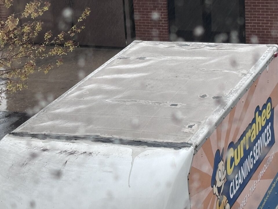

Mar 31, 2025 #1 BIG WOOD The Timminator Joined Feb 4, 2016 Messages 14,078 Location Georgia Name Matt w. I’m thinking about getting a new roof to put on top of this roof. Leaks keep popping up and I was wondering if I could buy this type of roof in a sheet of the fiberglass material and put some sort of adhesive down with pre drilled screw holes. Any thoughts?

Apr 10, 2025 #3 S scotty747 Member Joined Oct 19, 2006 Messages 866 I think I rolled mine out with snow coat or something like that from Home Depot. Never leaked again and reflected the heat so it was cooler inside. Reactions: BIG WOOD
Apr 10, 2025 #4 K KevinD Member Joined Nov 23, 2006 Messages 2,463 Location Binghamton,New York Name Kevin Dumas Try a coating of Henry's Tropi-Cool white silicone roof sealant. White deflects the heat and it dries seamless. Reactions: BIG WOOD
Apr 13, 2025 #5 Kenny Hayes Member Joined Apr 17, 2009 Messages 9,225 Location Yukon, Oklahoma Name Kenny Hayes I’m thinking a trailer repair shop can fix it. (I’m not bull shitting) Reactions: BIG WOOD
Apr 13, 2025 #6 BIG WOOD The Timminator Joined Feb 4, 2016 Messages 14,078 Location Georgia Name Matt w. Kenny Hayes said: I’m thinking a trailer repair shop can fix it. (I’m not bull shitting) Click to expand... I think I'll take a trip out to the trailer factory next county over that installed the side and rear doors. Thanks, that's a great suggestion Reactions: Kenny Hayes
