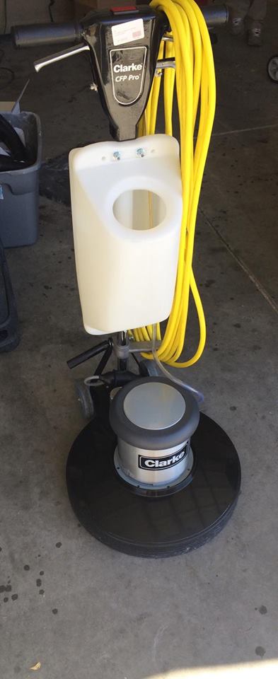

Finally got one of these..

Anyone do much hardwood floor cleaning or laminate what type of pads for that?
