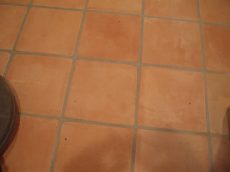

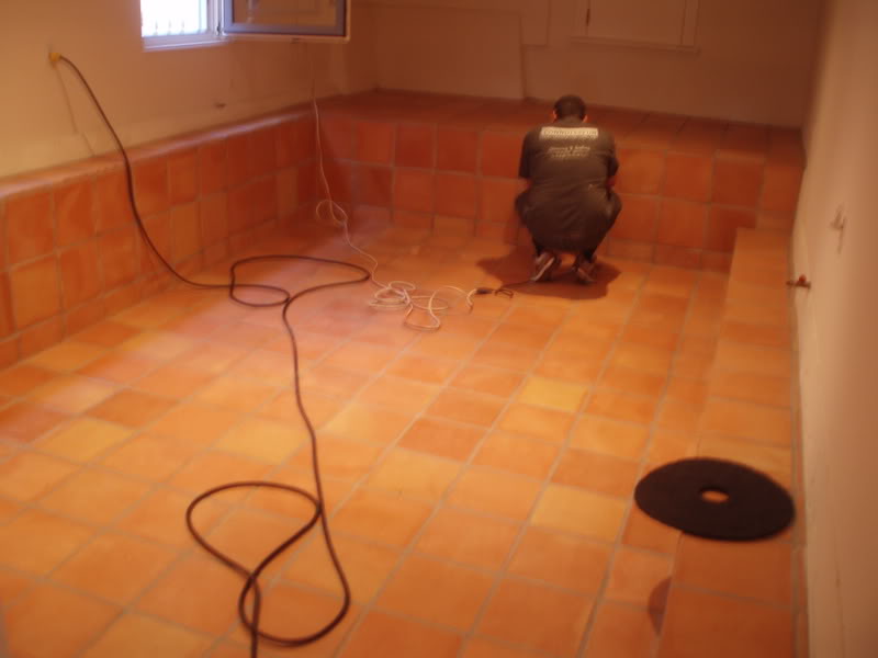

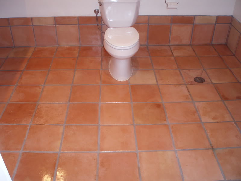

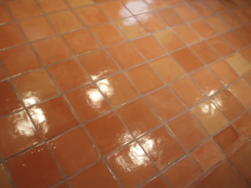

Nice even install with only one coat of some jive acrylic.
700 sq ft.

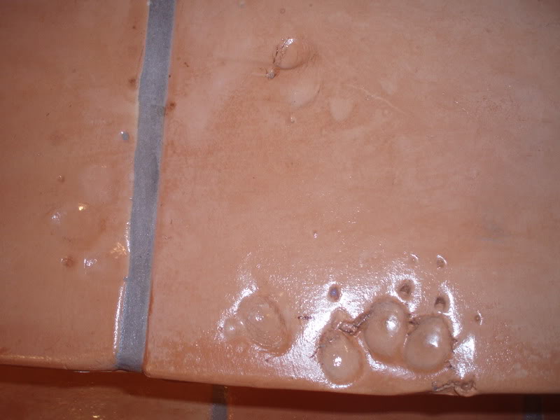

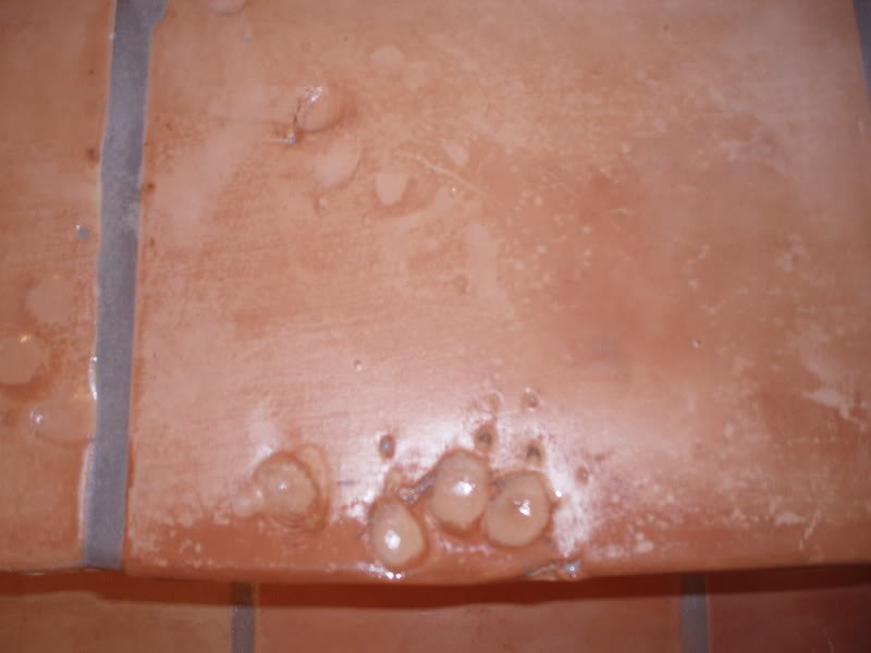

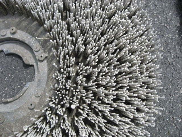

We were able to remove 85% of the sealer with just the dry Nylagrit brush I got recently from Jon Don.

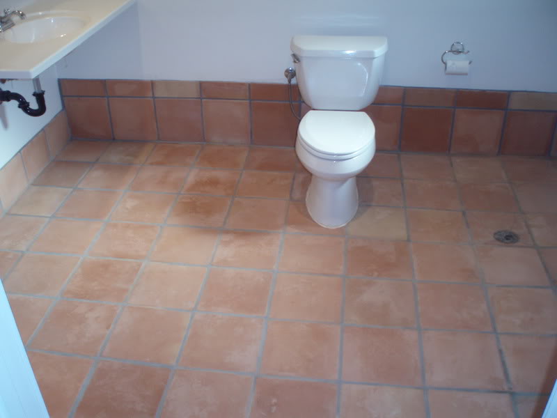

Notice the peel seal near the base board
Gone!

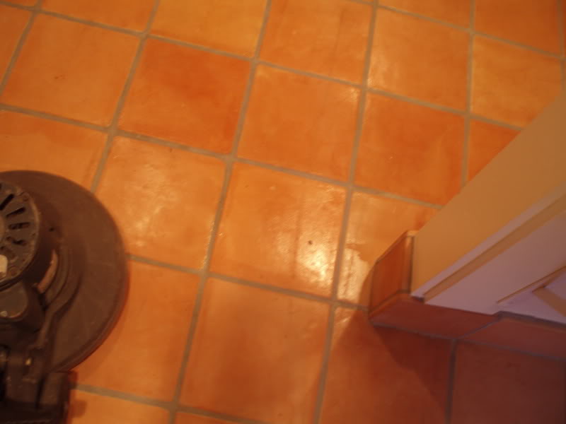

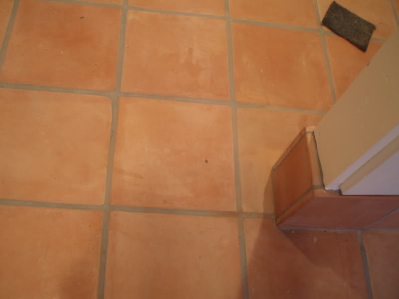

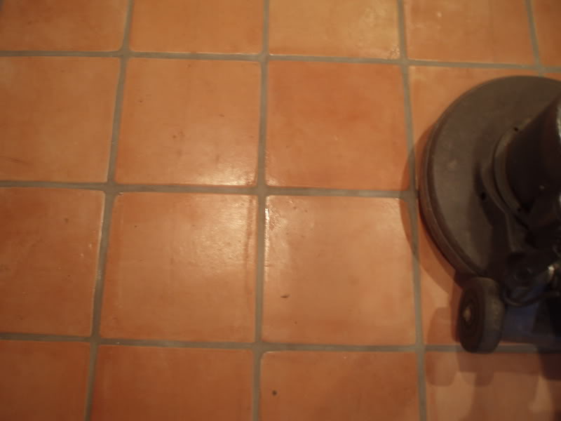

Shiny...
Not shiny

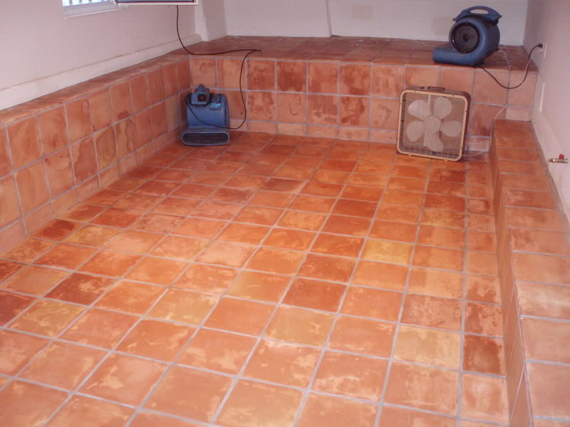

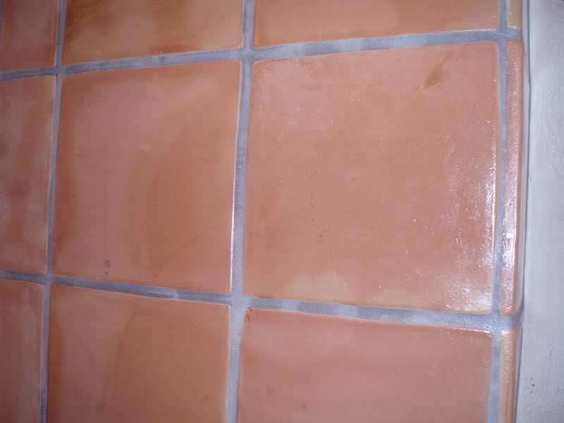

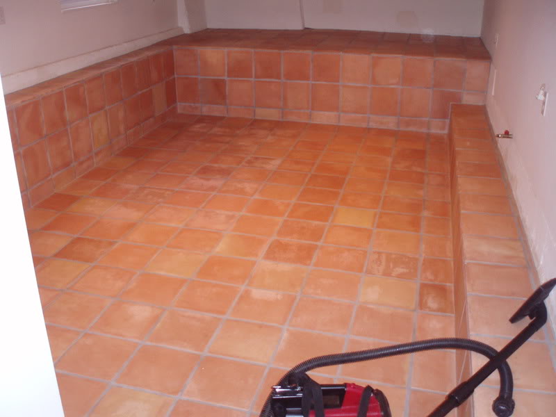

Taking it off the walls

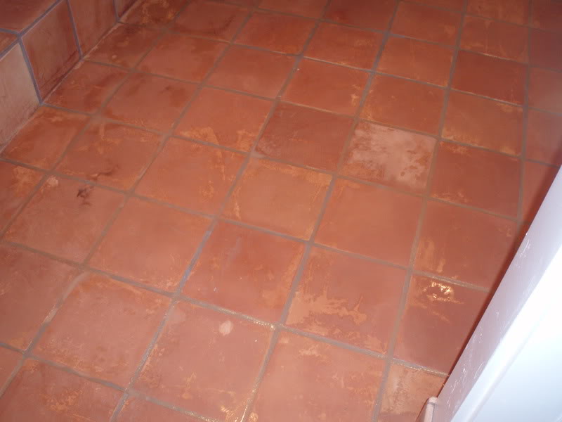

Stripped and drying
I'm going back tomorrow to seal her up.
I'll post more pics.

Have you guys used those on any other hard surface for scrubbing?
These cimex brushes I just got, suck. Looking to go with a little nylo grit action for these dirty commercial joints.

For Saltillo you need to determine what it is currently sealed with, if it actually need stripping ,9/10ths of them do and 8/10ths always have more than one type of sealer on them ranging from Mop N Glow, Glaze N Seal Ole', A acrylic finish of some sort, Lacquers, Epoxies, Peruvian Ear Wax, Turtle was and if you're real luck just some penetrative sealer. Be prepared to dry sand some of the sealer off where it's been over applied.
Do you best to get the finish or finishes off with out destroying the surface of the tile and base boards, let it dry real well and apply a high solids floor finish (or wax for you old farts) with at least 3 coats.
It's a learn as you go process because every situation will be different. Do not confuse Mexican Pavers with Saltillo, If you scrub a Paver too hard you' expos the hidden aggregate.
Make darn sure the customers expectations are not set to anything above "the floor will be clean and look better"
5 bucks a foot minimum to do all the steps. After you do your first one and most likely mess it it up you ask for ten on the next one.

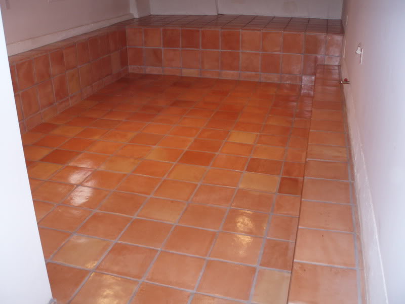

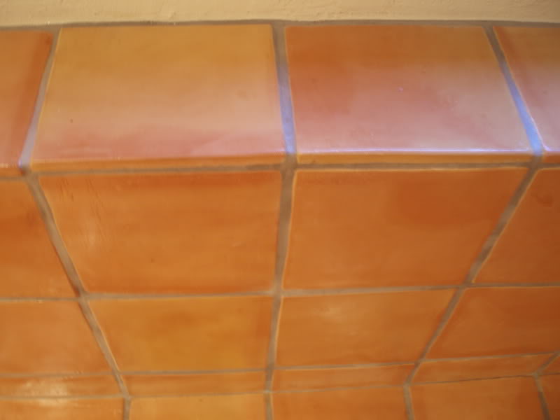

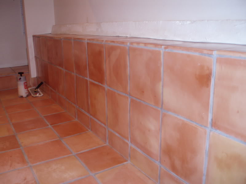

Went back today to find it nice and dry and ready to be sealed up.

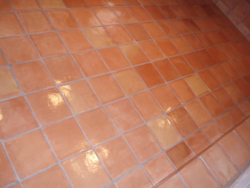

After one coat of a Pre Sealer..
and after 3 coats of wax
Look ma, no drips!
Looking good!
