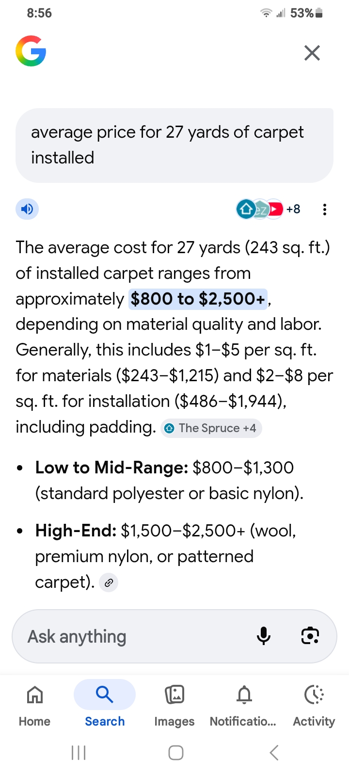

I would say thats alot!! 55-66.00 per yard, but googling it that's mid range for high end carpet

I cleaned a trashed apartment carpet several months ago and told them it really should be replaced instead of cleaned.
It was 2 small bedrooms. She said she was quoted $1600 from one company, and then $1800 from a different company, to replace the carpet in the 2 bedrooms. That was why she wanted me to clean it. The rooms were about 11x12, and 9x12. I was shocked at how much she was quoted for the replacement.
How much are you going to charge to clean that?
Its probably not enough for the risk.
And you dont have to tell me how much you would charge im just saying.
What happens when they start getting a cough everytime they vacuum after you clean it?
I would rather lose a job than a customer who figures out later they need to replace it for their health and then blames you for not doing a good enough job.
Its a risk either way but which way protects you the most and them. Its hard to tell people what they dont want to hear. Put it back on the insulation installers hands. They should at least help for replacement costs for the damage they caused if you the expert recommends replacement.
How old is the carpet and the condition before the insulation issue?
And dont prejudge your customers. Everyone complains about costs and not being able to afford things. The tightwads usually can afford the tough decisions.
$800 a room for carpet doesnt sound bad to me.
