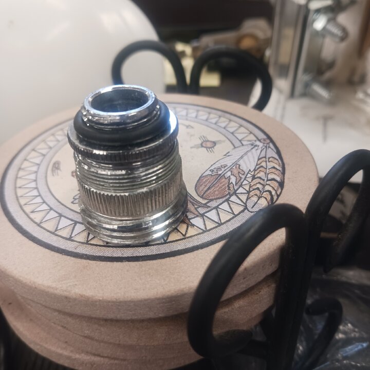

I have a carabiner full of adaptors that ive collected over the years haven't found a sink i couldn't connect to yet. However, some of the new fancy ass designer plastic over metal ones at times are nearly impossible to get a tight seal on. Ill take pictures tomorrowof the adapters i have.
Meanwhile howauout hooking up to the washimg machine hose bib in a pinch?? They're generally in a place that's easy to get to. You just have to make sure that when you reconnect the washer it doesn't leak

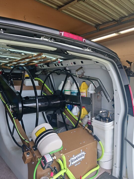

I have a waterpond installed on my van but im not a fan nor do i just drive around with 1,000 lbs of water on board in the off chance i can't hook up to a customer's hose bib and i need it. I generally only carry enough water to do a couple of rooms, small jobs where it's easier and or faster to use it

Ooo, you got the expensive water pond. Nice! 1000 pounds is a lot of weight for those big tanks. I definitely wouldn't keep them full and drive around all day with them either. 1/3 full should get you by just about any needed job depending on the truckmount hot water regulating system.
I can't say for all machines but the smaller prochems and ss370 machines sip water while the bigger ones go through it dumping a bunch to the water tank keep the heat down.

The way i clean blows thru water i can only do between 800-1000sqft on a full tank i first clean n dry with a 5 jet rx20 then i rinse n dry with a 16" 4 jet drag wand

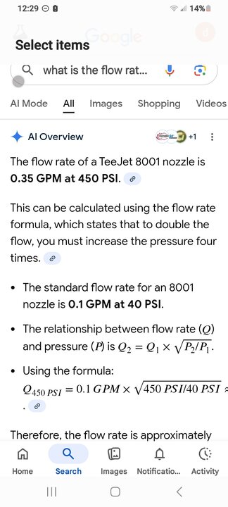

Never looked into rx20 consumption, guessing it would be significantly higher.
