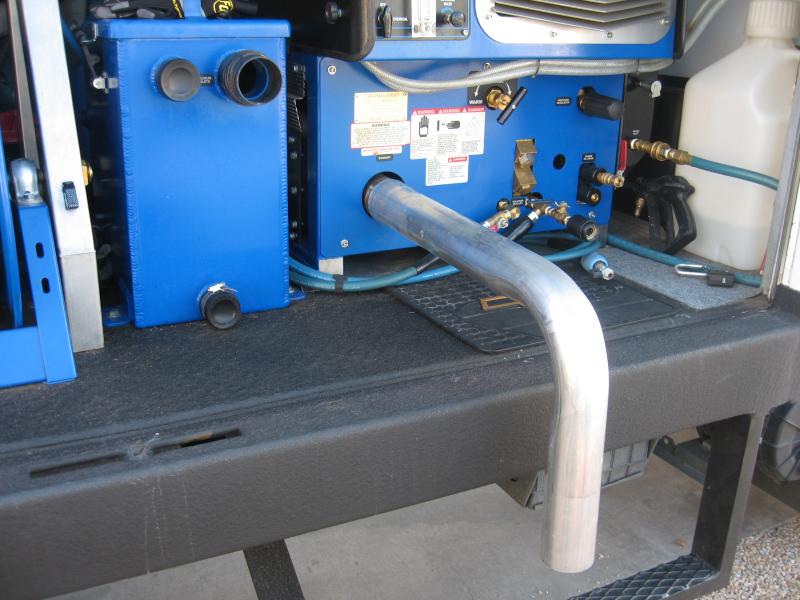

go down to your local exhaust shop and have them bend you up a 90 degree angle that you can slip on the machine when needed to divert the exhaust.........

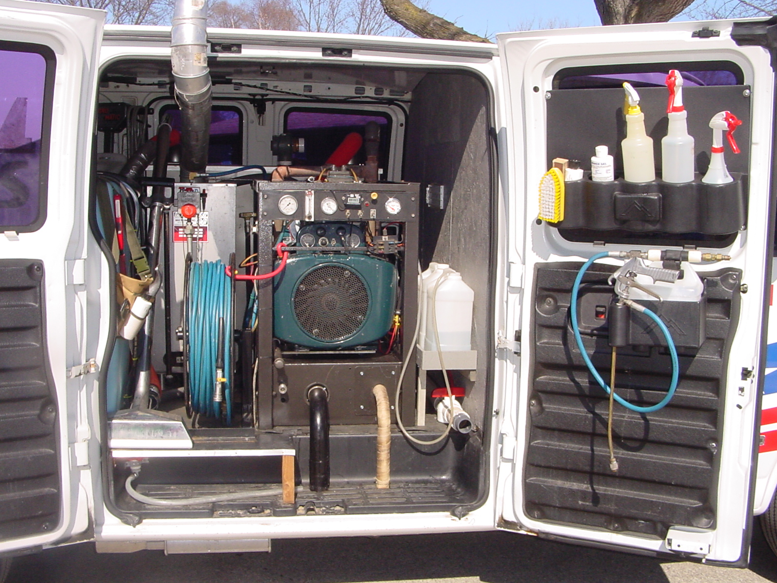

The large black pipe is the blower, has a 90 degree under van to another muffler. The small pipe is engine exhaust, it also has a 90 that directs the exhaust to the other side of the van.
