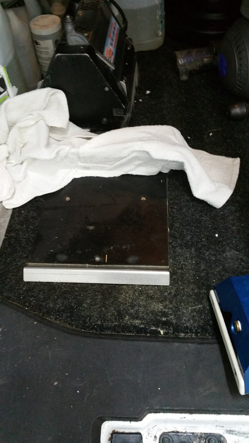

it has to breath....if not it will be history...........
this is the old way they wrapped them when I first got mine...
it held in to much moister....and rusted it all to hell....
replaced the HX and got a new wrap/blanket from AT....
it allowed it to breath and still hold the heat....
