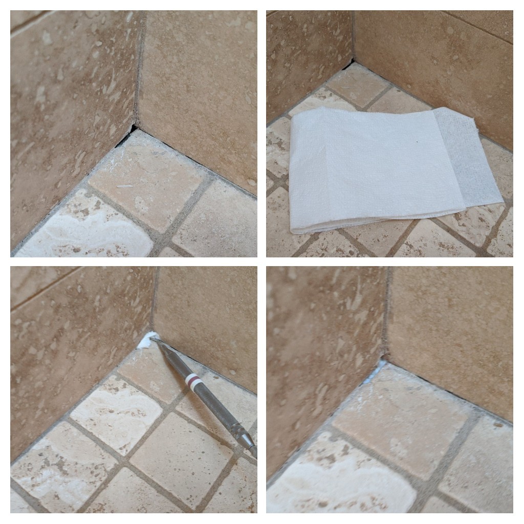

End of the world backer rod.

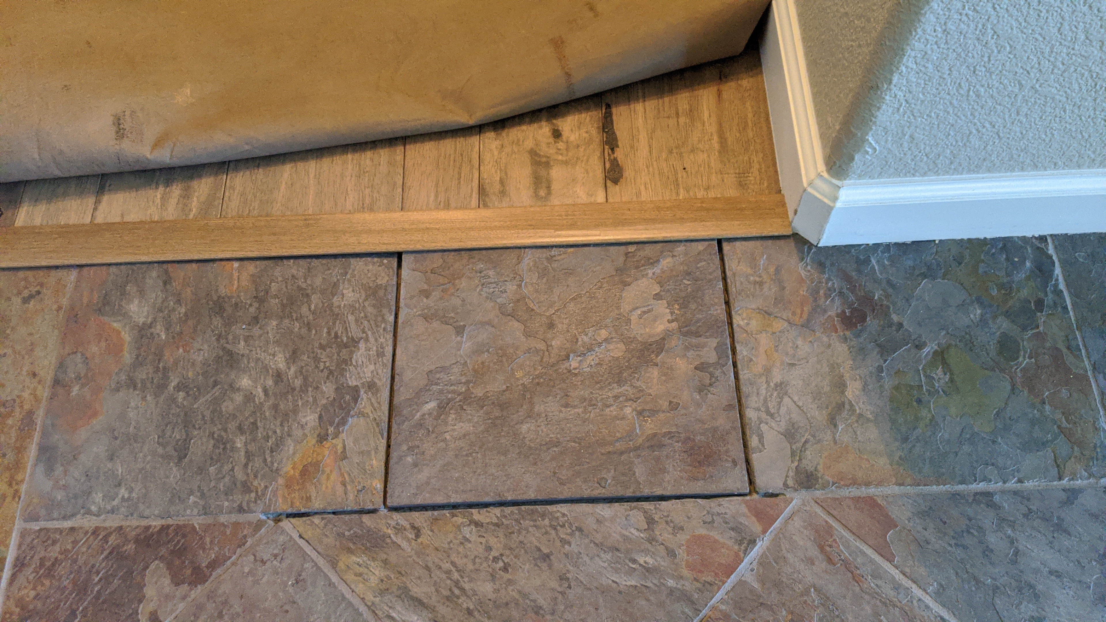

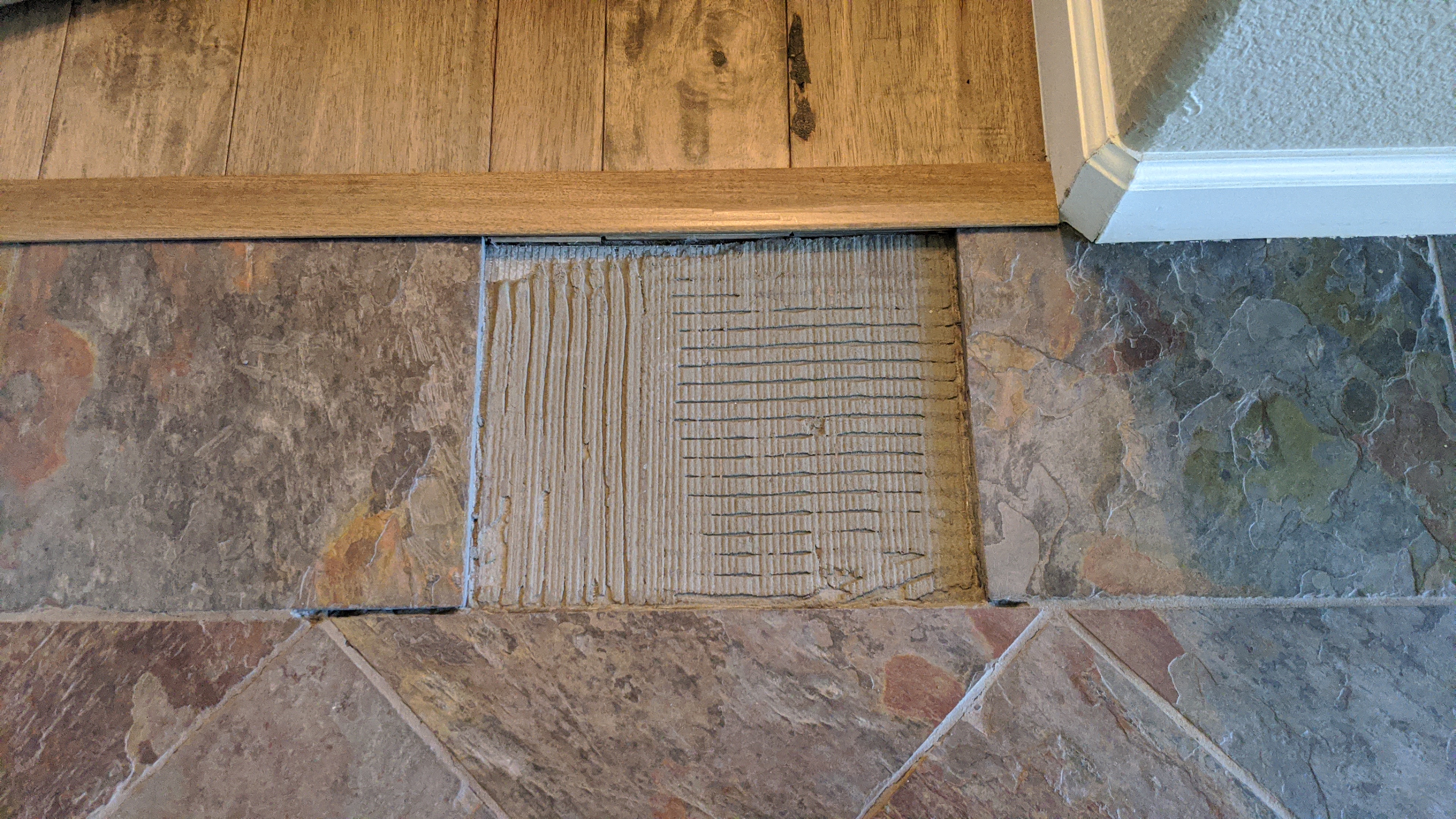

handyman replace these two tiles and match the new grout that dirty old grout well guess what happened after I clean the floor...
SGA to the rescue again

so paper towel as a backer rod?

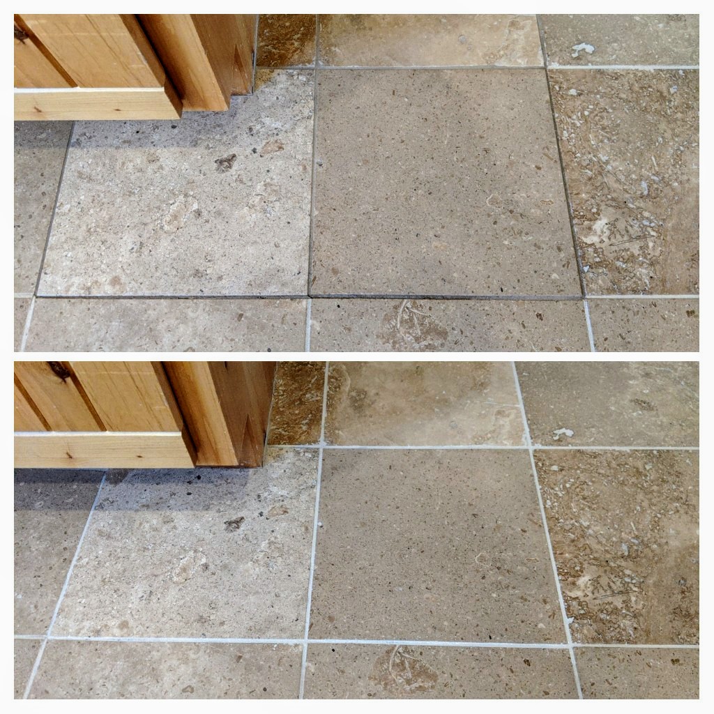

IMHO over complicated the missing grout repair. just use prism grout- done
more complicated?
customer has grout in garage.
I have SGA in van.
done.
TP to plug holes so all the SGA doesnt fall into the Bermuda triangle
Prism is a matsa cracker compared to SGA
