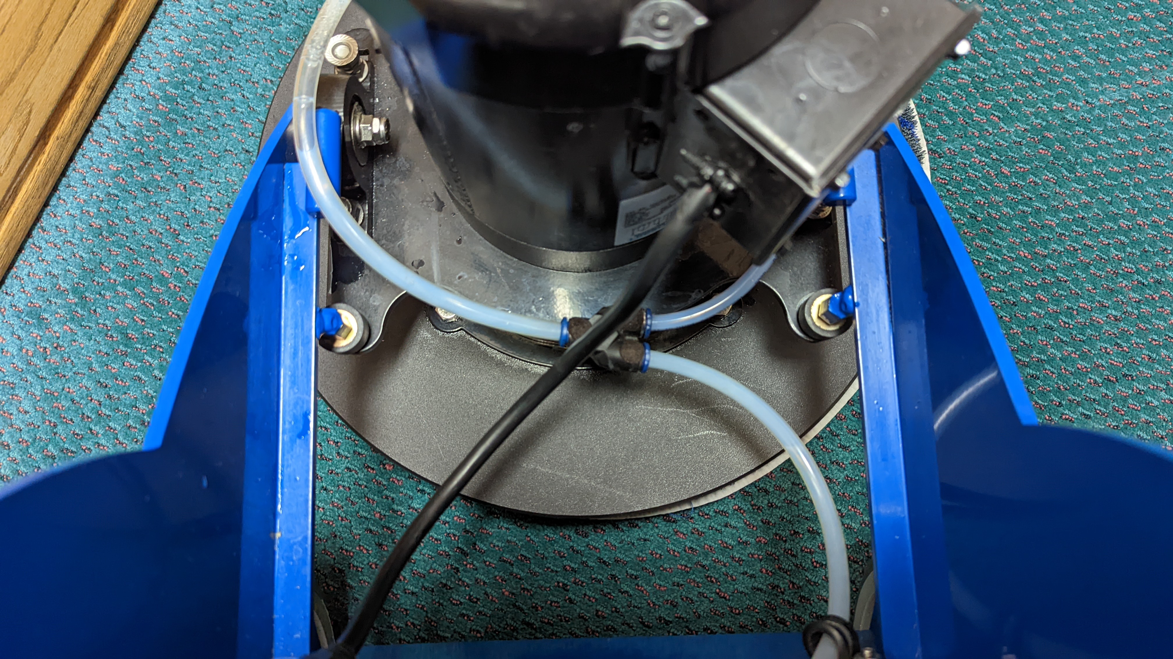

116,173
The problem is some idiot went and bought quarter inch inner diameter hose at Ace hardware. That is probably two millimeters off from what in needs to be in those snake bite fittings and never tested before he got to this job and was shooting saiger encap all over the goddamn place..
You can clearly see the undersized hose in that picture
I had a similar issue with my Orbot when I changed out the pump. Because I could not find the same diameter hose locally, I ended up switching from the sharkbite fittings to compression fittings. I wish I could have used the same hardware, but what you gonna do.
