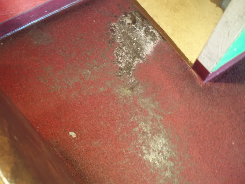

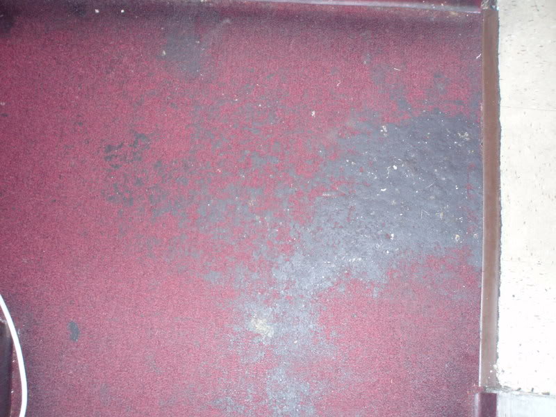

10 mounts since we "cleaned" it last.
Kitchen entry, hold the wasabi
So tasty you could eat it with a Pocket Bushmaster.
Pre spray icing.
After a good Purple Powering & Green Padding which did next to not.

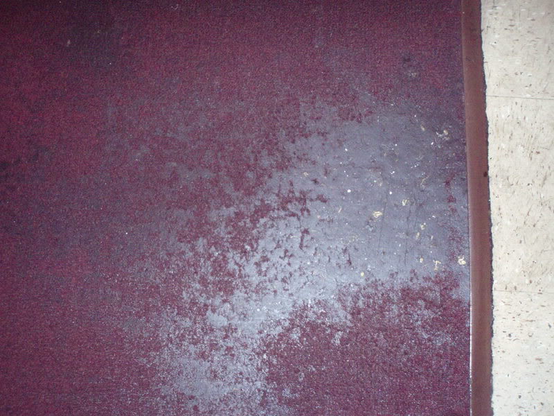

Top layer came off exposing more shrimp and mac nut

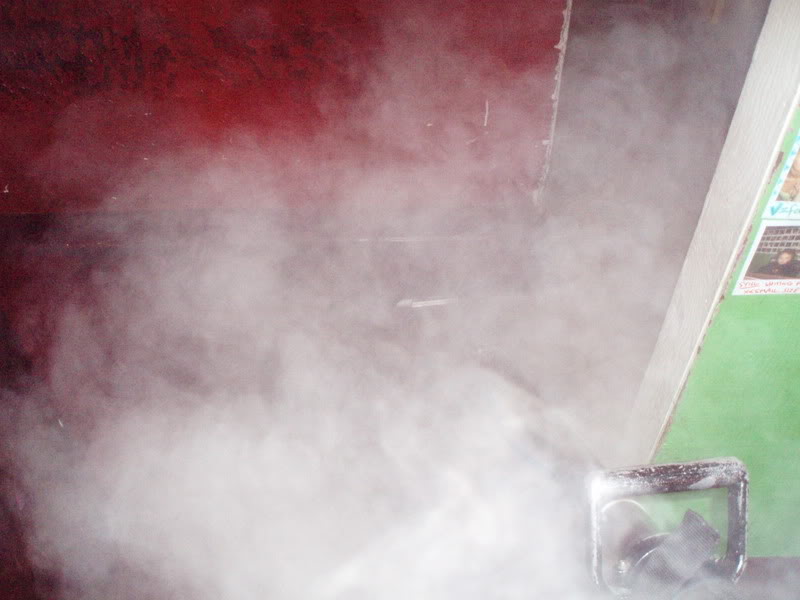

But eventually 250º got it out with 30 slow passes.

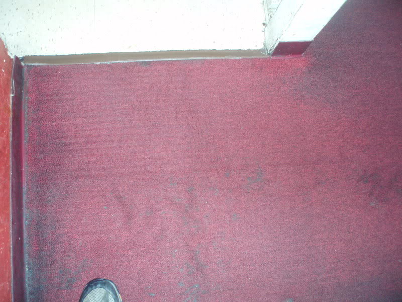

I clean a restaurant on a monthly basis with the same problem. At first I thought they may have a water leak, but then I learned it was from the kitchen help pouring buckets of water on the kitchen floor to scrub with deck brush etc. and then mop. Water would get on the carpet before it was moped up. I have to extract the carpet in a small area with a claw first and then clean.

One of my regular accounts had a grease slick like that. I didn't get too fancy, third month in it was gone. Came back a little each month, but I have been able to keep it at bay now. Every 3rd or 4th cleaning I have my helper monkey get down with a bone scraper and scrape the build up at the edge of the tile with some gel break and flush it out.

Are you telling me after looking at the 2nd to last photo that I didn't get it clean?
Zep Purple Power was used, did you over look that too?
