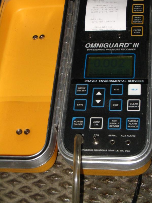

Pressurizing the crawlspace is the best method….. if you can also pressurize the home more than the crawlspace. This can be difficult during certain times of the year unless you have specific equipment. If the homeowner or renter is out of the building until the drying is complete makes it easier to maintain good temps up and down for evaporation. I also like pressure measurements to document.

Driving on the left side of the road versus the right side of the road. Neither is more difficult or safer. I just depends on what you are familiar with. Heated positive pressure eliminates infiltration of cold air, very difficult to control where this is happening under negative pressure in a crawlspace. Pressurizing the structure more than the crawlspace is generally not that difficult. End result is faster drying and less potential problems.
