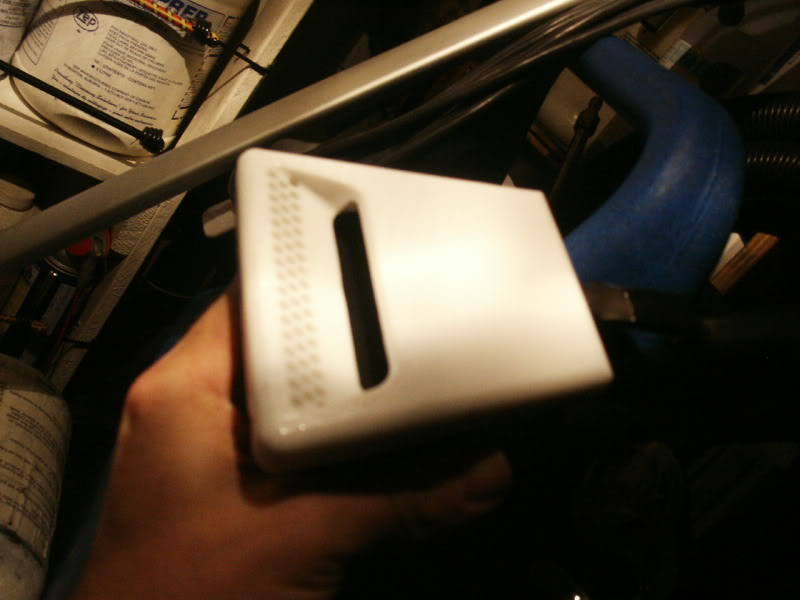

The pics remind me that there is an improved teflon glide for the HydroKinetic, do you have that one yet Loren? Smaller holes and made of teflon, not plastic.

I was using the HK tool this afternoon on some nice velvet. Having used the DM tool for 4 yrs there is no way I'm giving up my HK tool. Worked 20x faster, flushed better, worked at 500psi (same as the wand, no adjustments needed), left the fabric dryer with less effort (The DM required slow passes to achieve the same result). The teflon glide is VERY easy on the fabric and makes working with the tool a breeze!

I didn't know about the new face plate. I am sure I have the original.

The teflon glide makes the SW tool work. If the CFR had a glide, it would be better. If the DM had a teflon glide, it would work better to.
I did some great cleaning with the DM, but I'll do even better cleaning now with the SW HK.

I loved my ol' CFR long handle, only thing I regretted was it couldn't be glided, the SW HK does pick up on that, it's basically a CFR with a teflon face.
