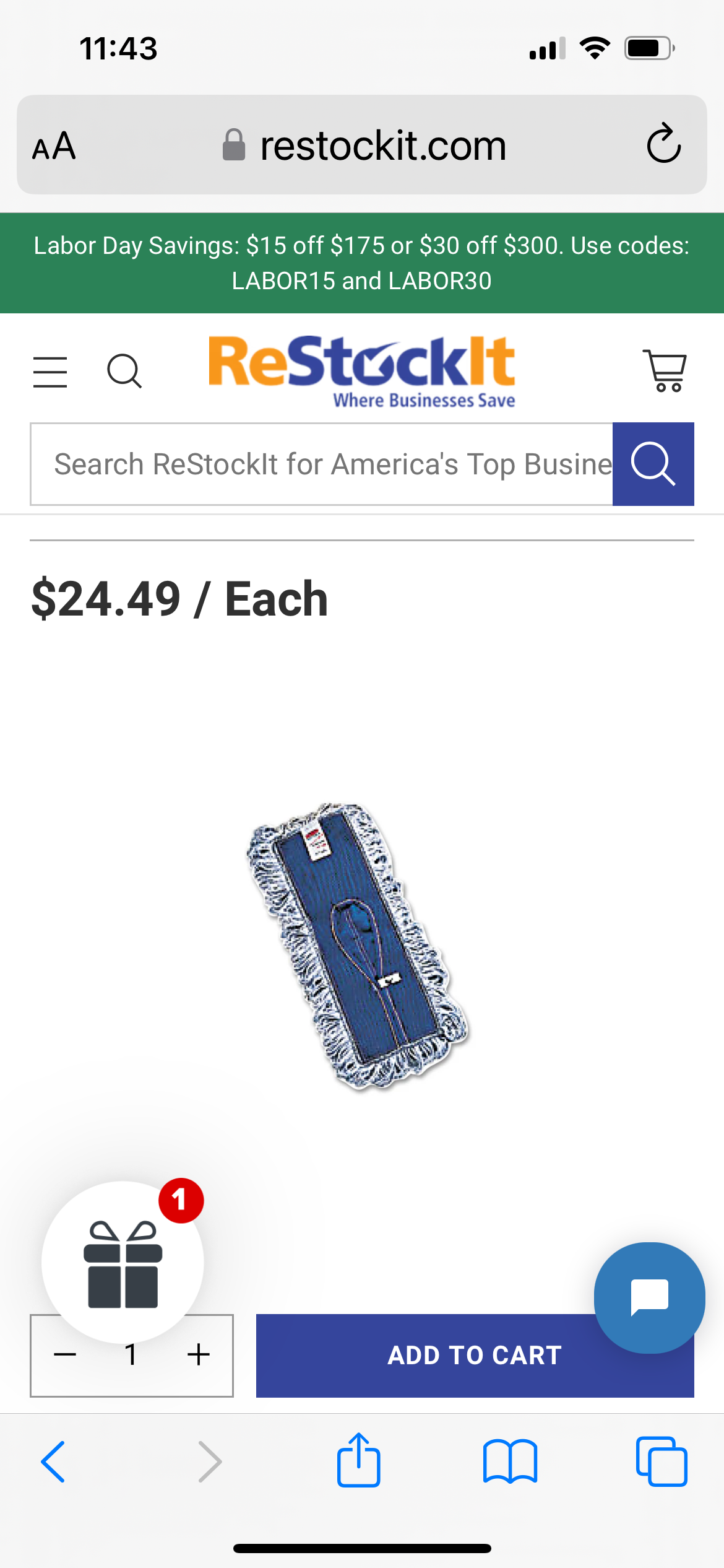

Just google flat finish mop. This is what you want. You’ll need the 18” dust mop from and handle. Whoever you buy your finish from should have the frame and handle if you don’t have one. Dust mop handle. You can find the pad driver you want on line too.

i already got them... i was referencing a day i was looking for stuff a few weeks beck abd had to try 5-6 places before i eventually found a place that had everything, which was t an exotic list- i was surprised it was hard to find the stuff in stock at a brick and mortar... but succeeded just in time. but thanks for the advice!
