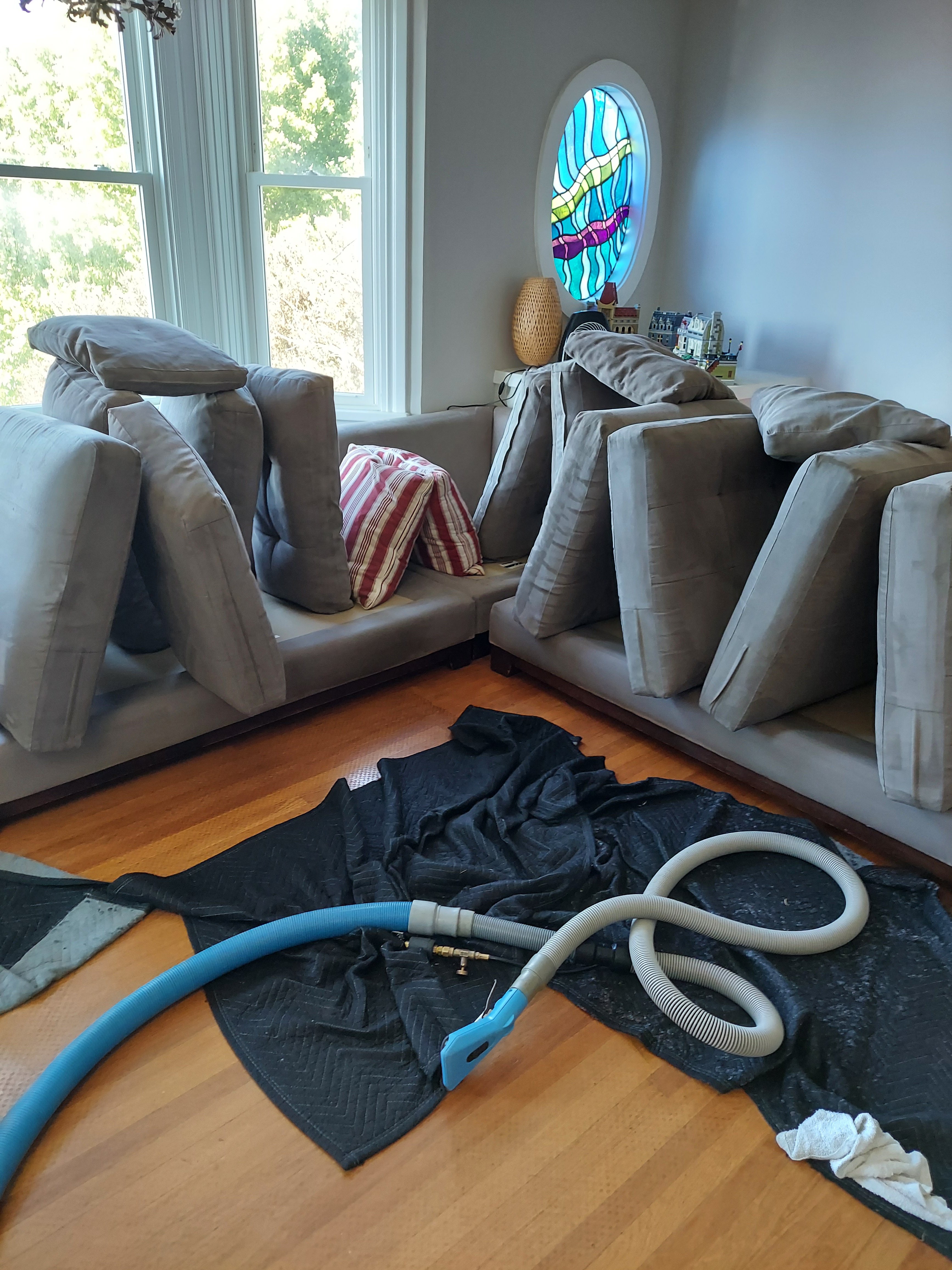

Remember to "A-Frame sofa cushions for better drying. Seat cushions should be with Zipper side down so that the front can dry first.
and inform the customer to flip the cushions in a few hours so the the touching sides can dry.
27,862
I usually don't wet the zipper side. Dry vac only. Usually not dirty. Cleaning over the zipper can make it sticky if you're not careful. That way there is very little chance of the the deck material wicking.
