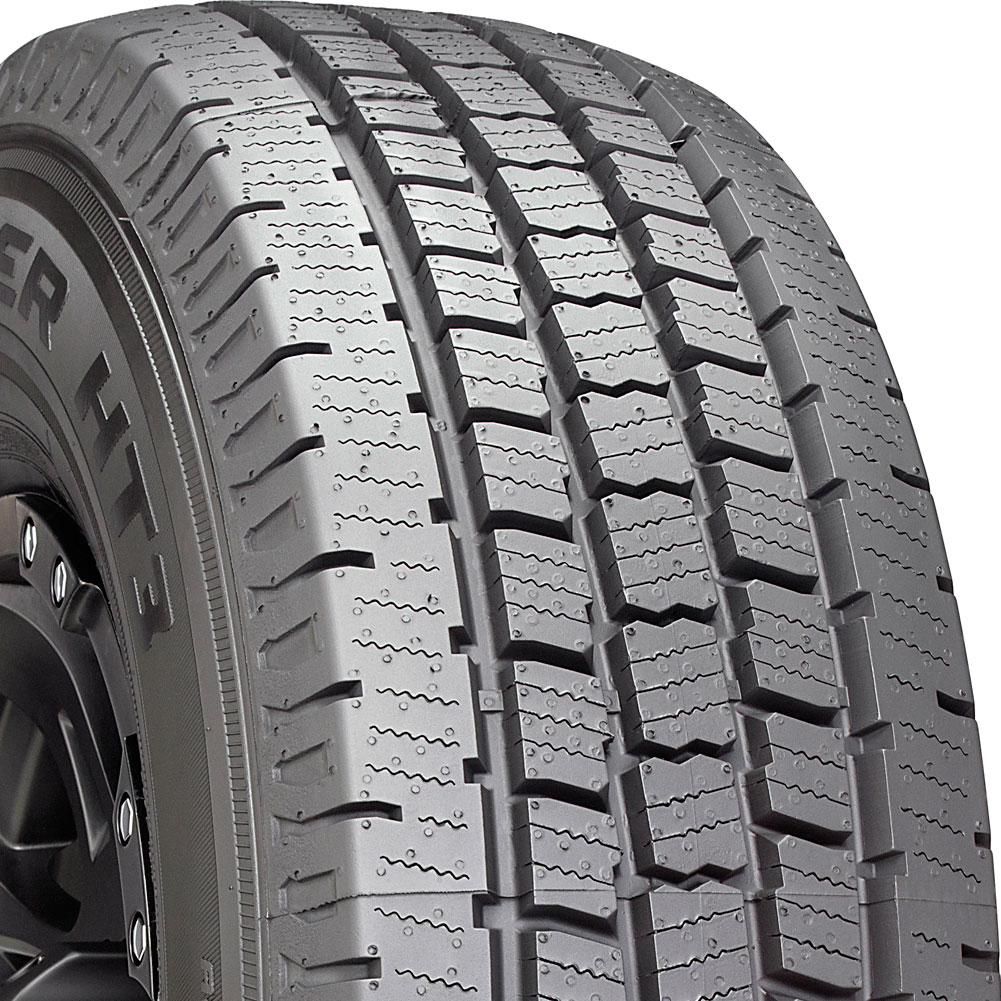

I'm thinking of going with an all season Cooper HT3 in the spring which have lots of siping, and I would have our local tire shop add some additional siping on the center treads rather than swapping out from summer and winter tires..

We have lots of Tire shops here that do siping. Usually adding it on tires that are somewhat worn. Breaks up the tread blocks and gives you a little more traction. They usually do it to existing snow or all terrain tires. You can't make a snow tire out of summer tires.

What is the disadvantage of tire siping?
Tire siping will not increase the tires' life. In fact, it will shorten it. The additional slits will cause move tread movement, causing heat build-up. The tread design is already optimized by the manufacturer and siping the footprint will cause the warranty to be voided
