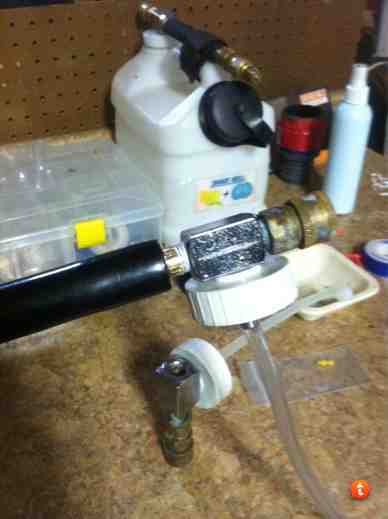

I replaced the whole block w a new one and it is still back filling. Would a bad Male QC on the HF cause this issue?
And how the hell you get the water nozzle out. I destroyed the 807 washer trying to get to it. There must be a trick.
I must master these blocks, they supply the juices to my masterpieces!

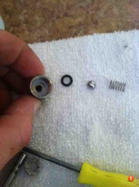

if the jug is filling up, the problem is the ball bearing and the spring on the draw tube. I can not find a picture to show it, but on the draw tube were it connects to the dema valve, there is a spring and ball bearing in there that prevents water from back filling the jug.
Man I really feel stupit : )
Forgot the O ring!
Thanks Tim!

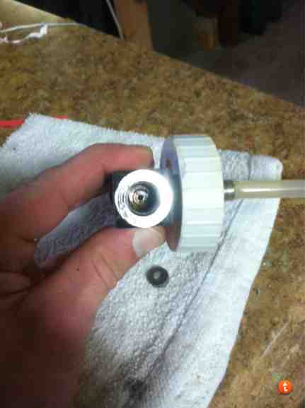

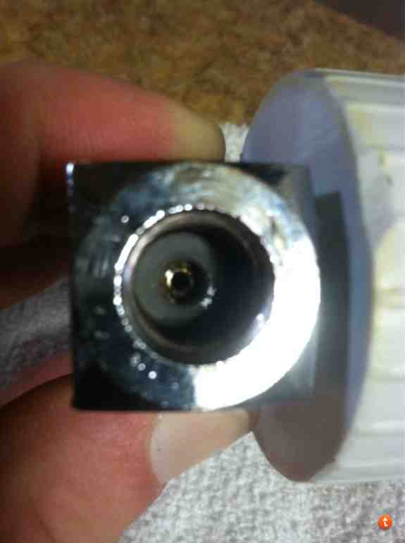

Remove the handle!
Inside the block, in front of the water nozzle is a thick gray plastic looking washer as shown on the white towel.
Also stretched the spring out under the ball. Replace the Ball O ring aswell.
All user repairable with a few cheap parts.
