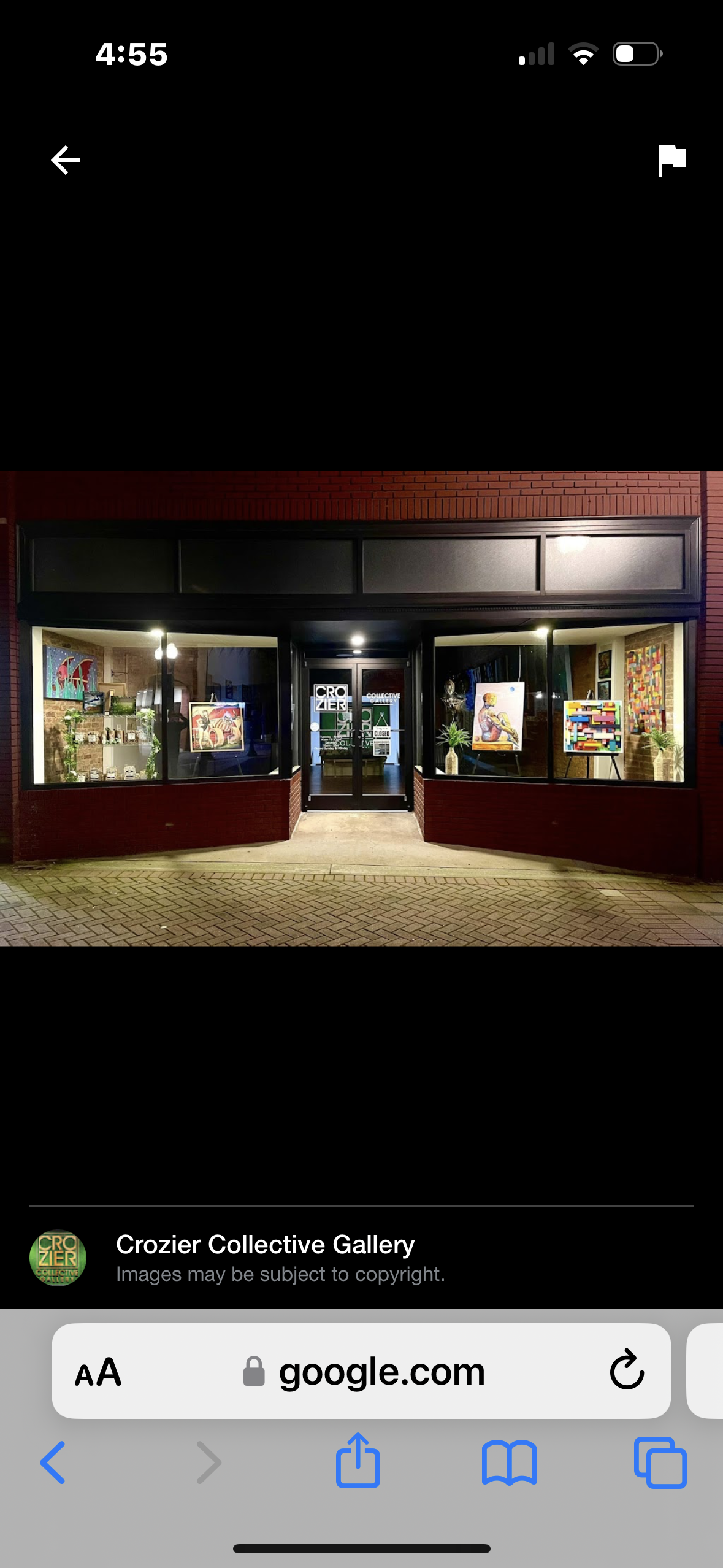

Crazy thing is, a month ago this building was an art gallery business. Just think how much fancy valuable art would’ve been destroyed of that deer running everywhere demolishing that art

In Taccoa GA? I'm guessing zero fancy valuable art would have been destroyed.
I thought more were the floor but when I pulled up the pictures, it shows most of them hanging on the wall.
