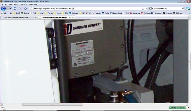

What size blower is this on your 327?
and will we be able to test one @ Vegas?
Bill Bruders
Jan 10, 2009
268
Burlington, WA
Bill Bruders
its a Gardner Denver (Sutorbuilt) 406 trilobe plumbed 2.5 all the way. Yes we will have it plus a 3rd model in the line with more performance,
