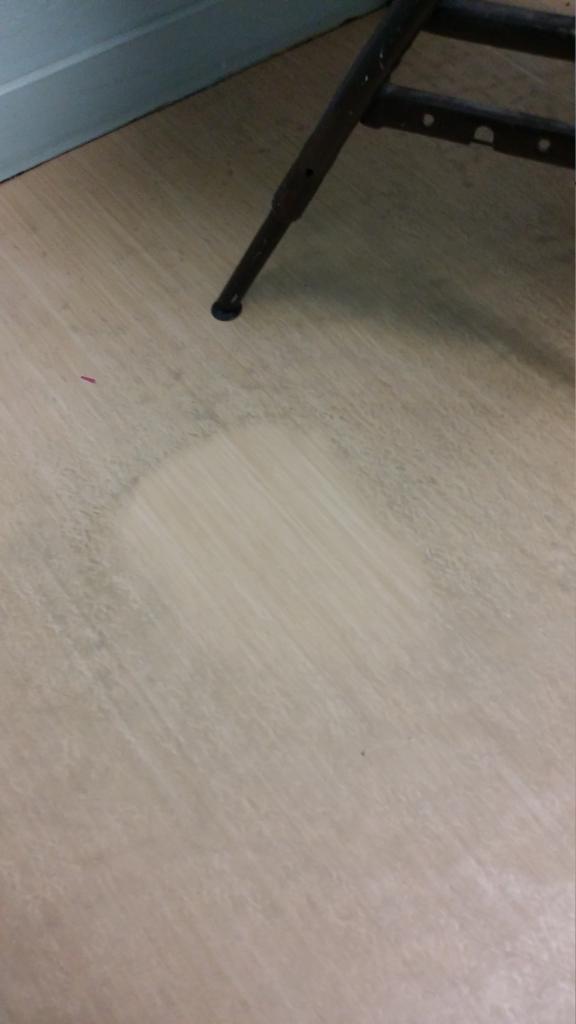

Customer does not want this VCT refinished, just stripped..
115,977
They don't want to have to deal with the buffing, stripping and resealing all the time in 20 small exam rooms.

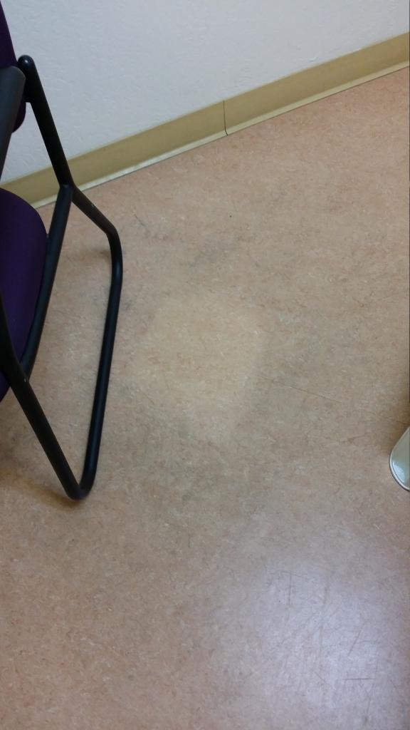

I tested some areas and the funk came right off with a 3M scub pad and some Devastatro stripper.
Looks like just Fabuloso build up
How will this type of Vinyl perform with out a top coat of any kind?
