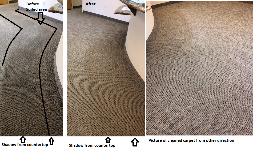

I haven't tried 175 on CGD, so I can't say. To be a fair appraisal I would need to try 175 on carpet enough to know its strengths and weaknesses.
This is b4 and after from Trinity on CGD I did today.
Dark areas on after areas hasn't dried completely. I'll go back when I get a chance for a dry pic.
28,270

When I use a 175 on carpet, that's just the prescrub. Followed by hwe.
I'm lazy, I just use the Trinity. Wet pad after prespray on heavily soiled areas. All areas with Glad pad after that.
Just one electrical cord.
Love the ease of it.
Pads are expensive though.
