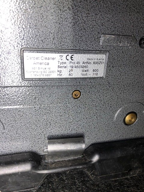

Hi everyone,
My CRB quit running a minute into cleaning a plush carpet.
I raised the handle, then lowered it to start the machine.
It would run 1 second, then quit.
I tried it on an enclosed patio with CGD, it still did the same thing - run 1 second and quit.
I took it apart Monday and expected to find a cracked gear.
I couldn't find anything wrong. I put everything back together and the CRB ran fine.
Two questions, first has anyone else had this happen and should I expect this to happen again?
Second, this made me aware of the need to have some spare parts.
Where can I get spare parts for my CRB?
TIA
