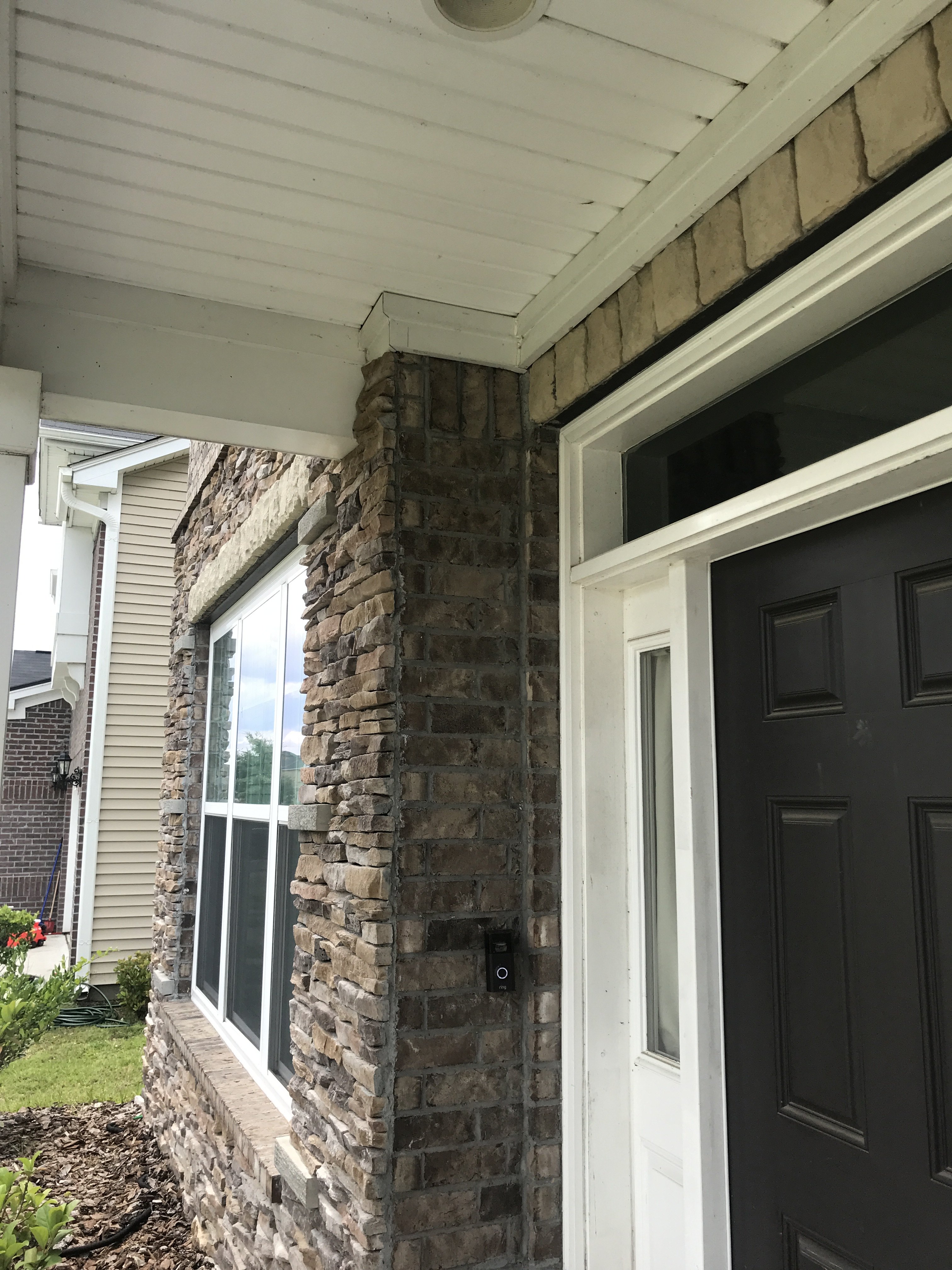

This should drive you nuts Mikey
Too typical low build quality. You're supposed to see the metal roof and not look to closely at the cheap stuff above. The entry may have a nice floor but further in will be matching laminate. Nice looking faucets made out of plastic.
First time buyers don't have the experience yet to see how much work the house will need in the next five years.
