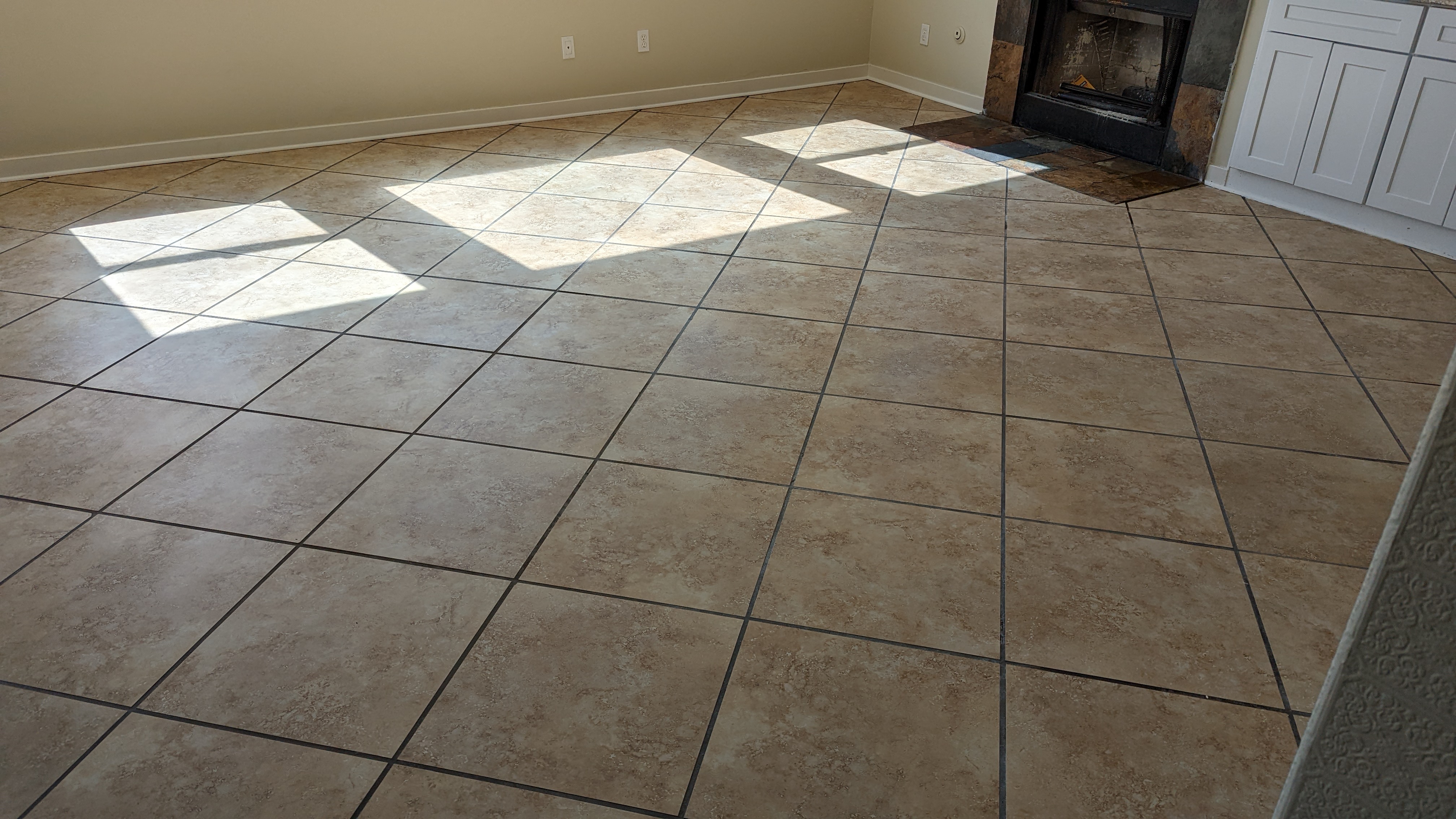

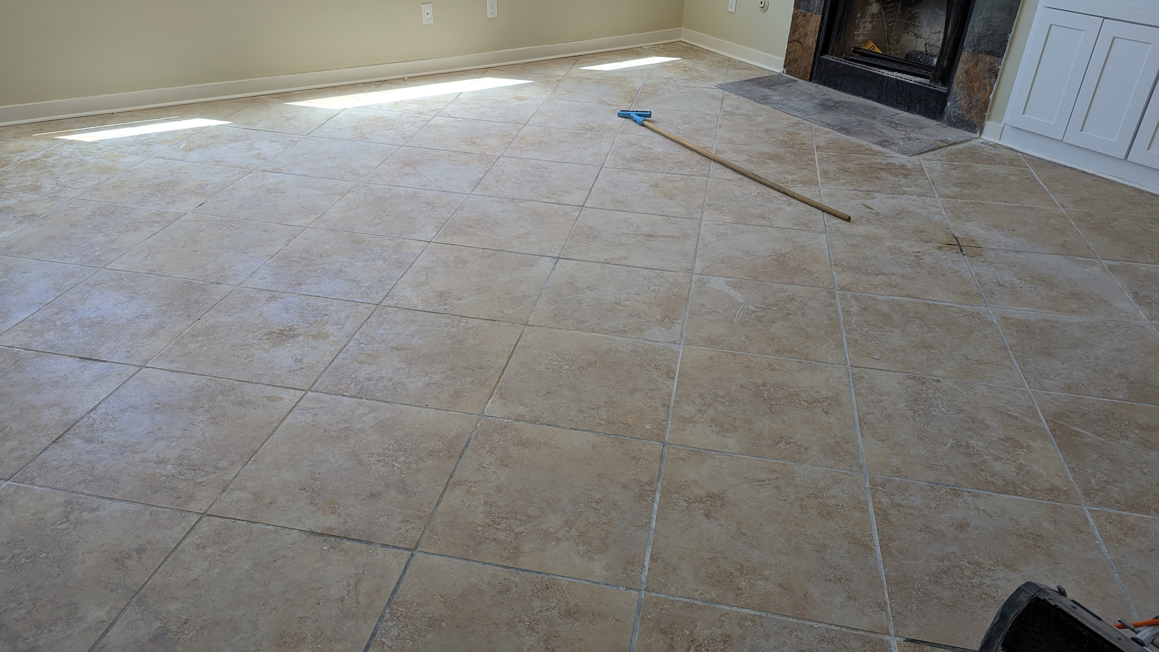

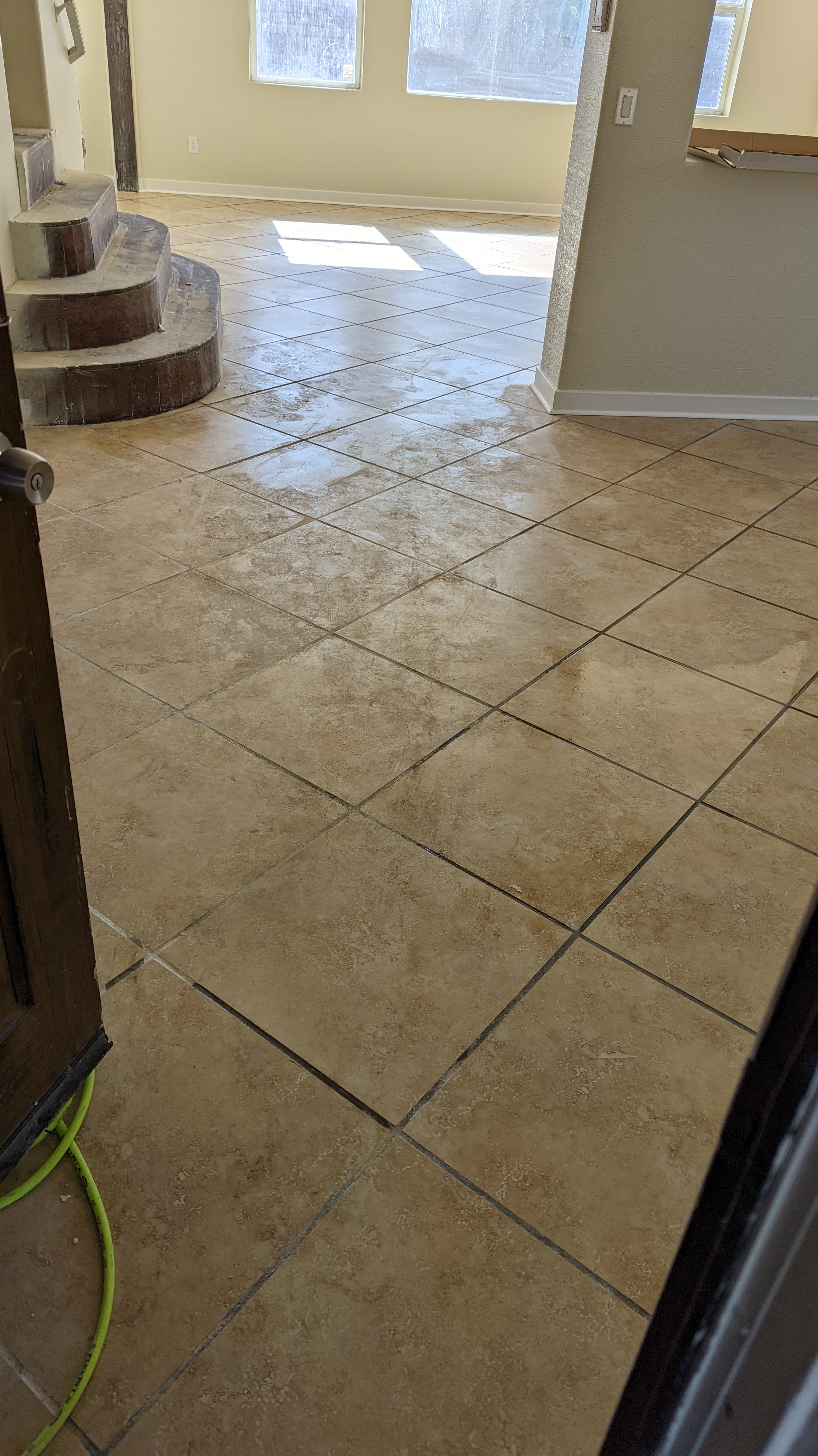

Go clean the tile he says,

StrIpper, black pad, either an OP, or 175, dwell, scrub, suck up the slurry with a shop vac, and rinse W/TM?
Shitty job NTL..

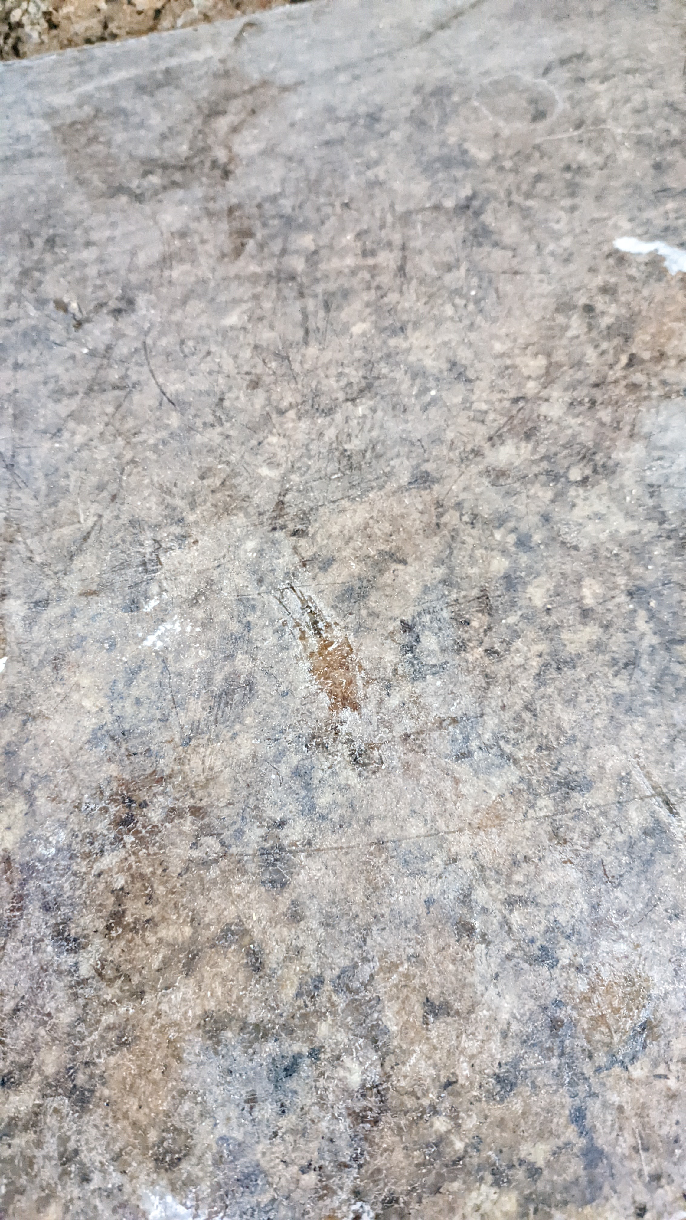

The old owner used a 2*4 as baseboards and caulked the hell out of it.
Yes it on top of a marble floor.

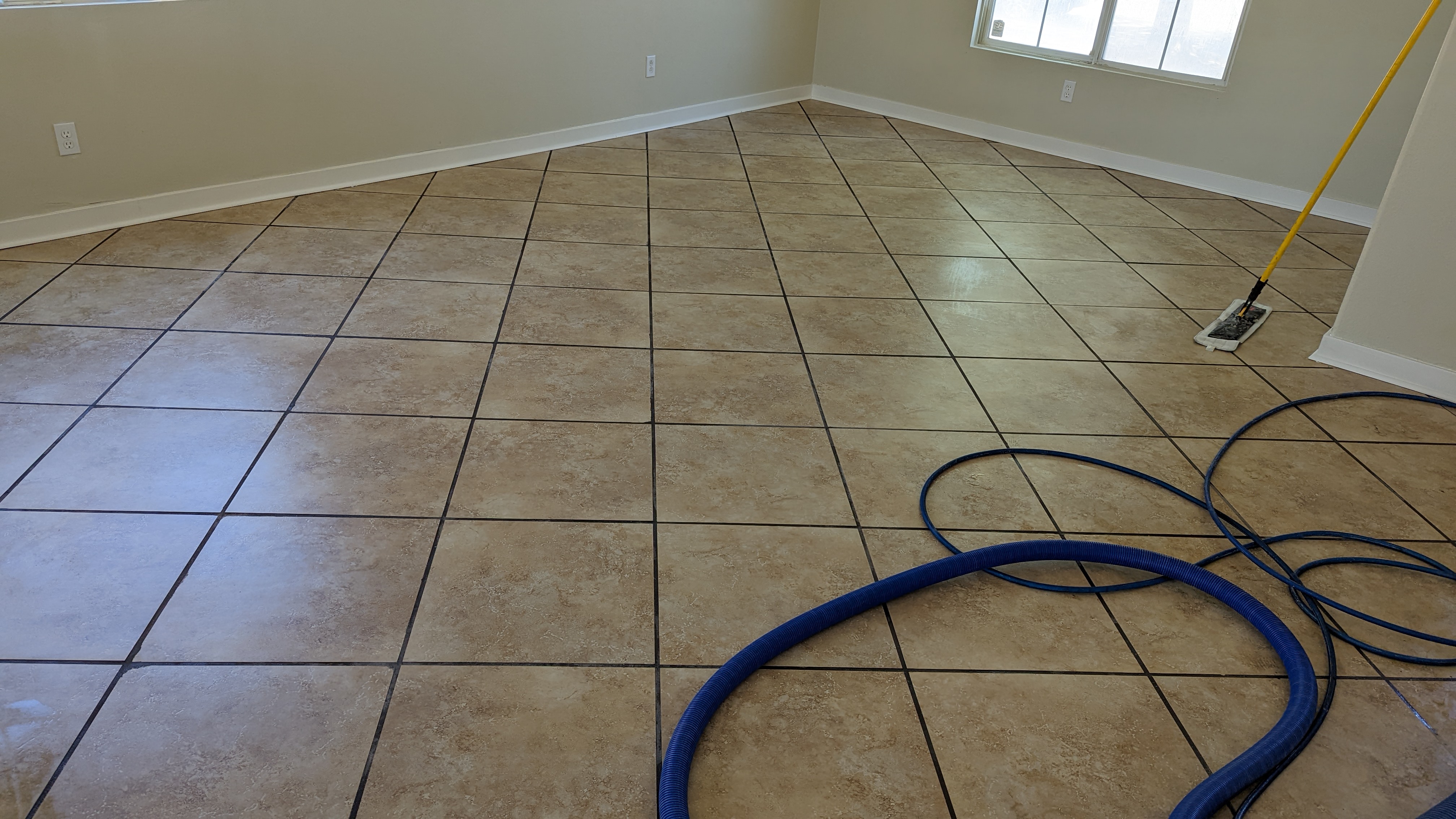

I have a ton of Tile cleaners and I keep going back the the NANO... or what you guys call Prochem UltraPac Extreme. It just does a great job on tile. The other stuff......So so. I really haven't bee too impressed with it.
Saiger's stuff is also good. Never let me down.
11,297
Tsunami is good, the new grout magic is decent.
I have so many I'm burning through.
I liked Nano tech, but a few times it wasn't as good as the wave.
14,079
I'm currently using the new 4ish ph powder rinse for ceramic/porceline (I can't spell that word for some reason) tile floors
