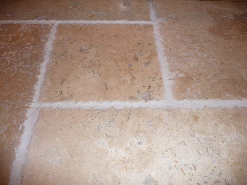

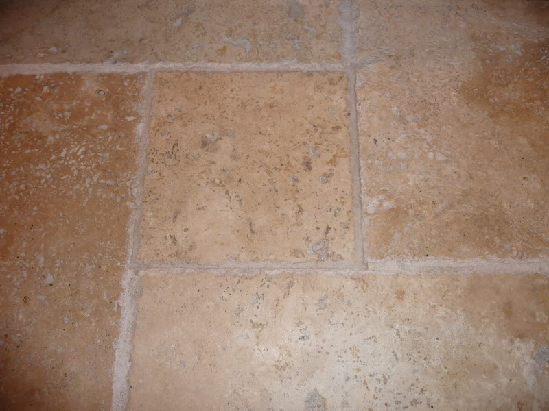

Colorsealing around Travertine for the 1st time
116,054
Amazing.
GP did not stick to the stone at all and made a HUGE difference.
Went way faster than ceramic tile too.
You guys in Arizona would be fools to not offer Color Sealing.

clean image
mike,
looks like alot on the tumbled edge, although there was probably sanded grout there too
makes grout line look wider
i'm sure your flash highlighted that colored grout, and it doesn't look as florescent as being there
try setting your camera to no flash, i have noticed flash sometimes will over expose colored grout lines
