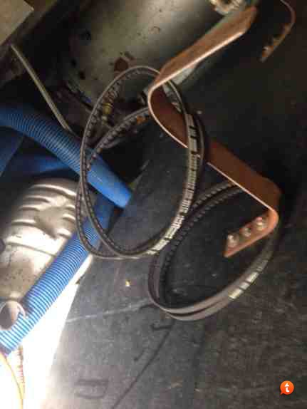

24hp dynachem, Cobb says they don't use belt tensioners and so I can't tighten belts and they slip after a couple months of use.
I should install a belt tensioner. Can't figure out how to download video from iphone.
Back to square ONE it seems Larry?
You still think it's OK to not have a way to tighten belts?, no adjustment? Just push the belts over the pulleys?
You DO know belt mfgs consider that a big no-no because that will shorten the life of the belts by tearing load bearing longitudal fibers of the belts.

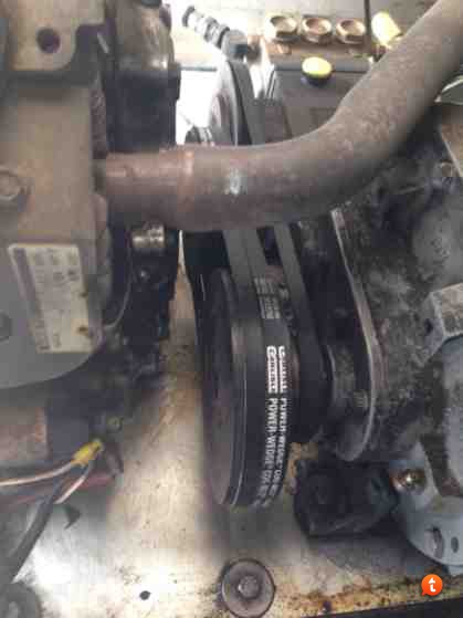

It is generally accepted to install belts in a manner that you can read the writing when facing the machine. The belt on the outside of the sheave is installed correctly, while the inside one needs to be turned around. Just saying.
18,851
Benton KY USA
Lee Stockwell
That pic doesn't show the feature you noted. There is "flex" on the base to plate connection, not motor to blower connection.
You know you needed a way to properly install the belt and maintain its tension over its lifetime. Most mfgs, even in WF TX did that back in 2004 :-)
Please don't blame your customers: "...customers misalign the sheaves when they loosen the mounting bolts", for shortcuts in engineering.
We love you Larry, you make some great stuff. Hopefully your new machines have the improvement you pictured in a different thread.

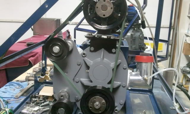

A belt tensioner would prevent the need to loosen bolts and misalign things. I prefer Bobs mount straight to the blower. Might be risky for some to install their self. Very clean
Gene
44,244
go back and look at my bracket.....
you'll notice a coupla extra mount holes.....
this bracket will fit a roots as well as a Sutorbilt.....
Honey Badger don't f'ck around......
Reactions: Lee Stockwell
44,244
Bawb, where do you get your eccentrics?
Crap...can't remember...they ARE from an older vehicle and had to be ordered from my local NAPA....HOWEVER i still got two left on a spare bracket that belongs to CRASH....I can get the #'s off them for you....i try tomorrow....if i forget remind me again..cuz these things are the cats ass.....and work great
