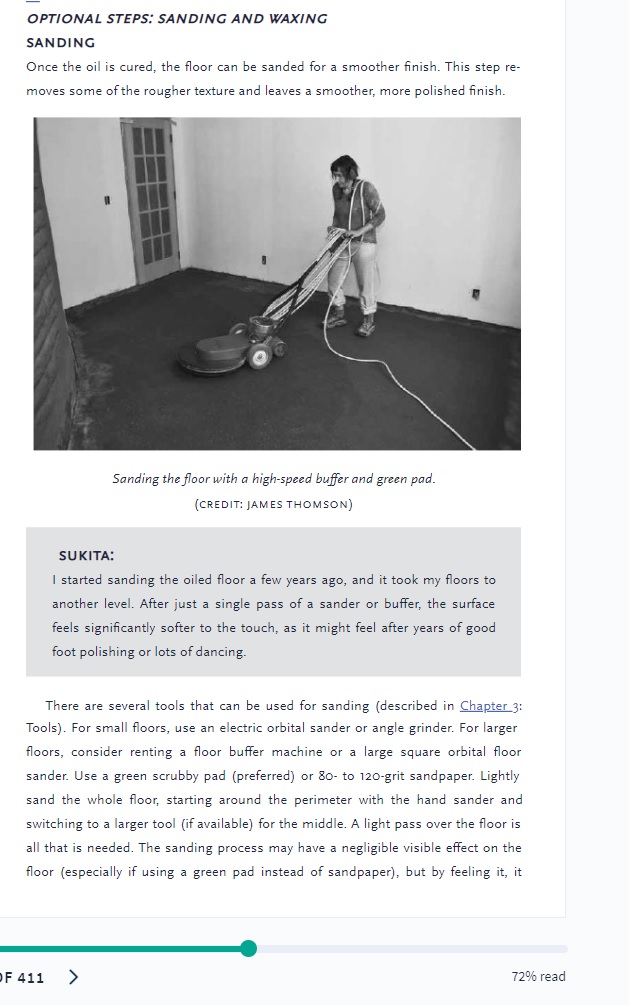

Hey Mike! This is *******, ***** ****'swife. My mom has a natural cob floor and wants to strip a layer of wax off it. She wants to sand it down smooth then reapply wax. It's cob so it's like concrete. What do your recommend?

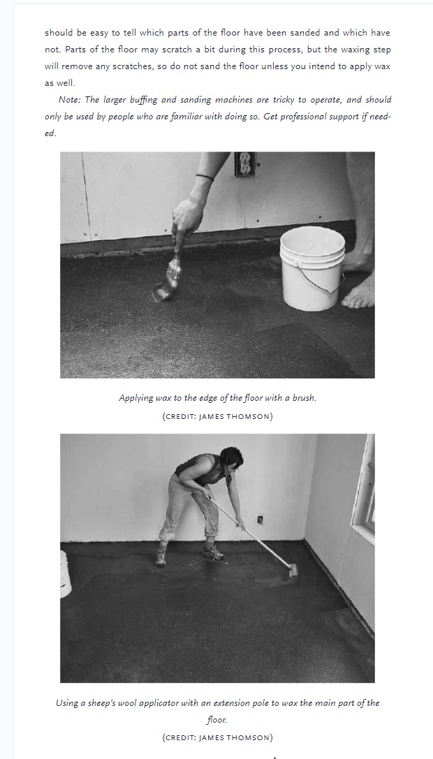

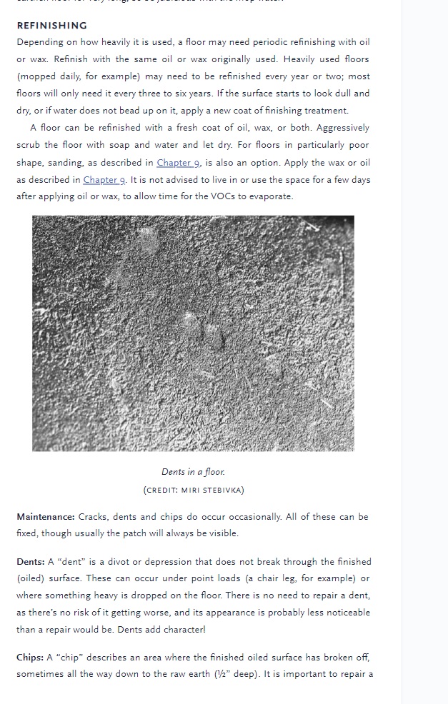

The property i was in at Oregon was a cobhouse. My wife mom has that floor. She sand and reapply wax. She does it by hand because it offgrid and the solor power isnt enough to operat 175
so it looks like
scrub with soap/water (maybe a little dlime)
re-oil (?) and let cure
sand with green pad or 80-120 grit sandpaper
Apply new wax coat
buff with a white pad
*I'd be curious if the "sand it down smooth" is to correct problems that are better corrected by other methods or even a complete redo or just to give a more polished texture
