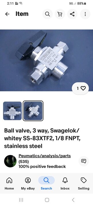

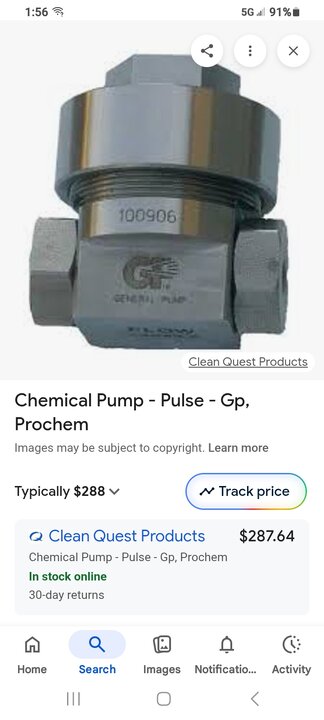

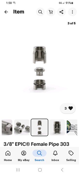

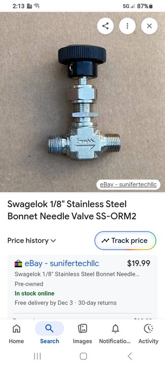

1200.00 is alot! You should be able to get everything necessary for well under 600.00 and maybe an extra 100 to go all stainless. You can get a great General Pump pulse pump for under 300.00. Youll need a check valve for soulition out i love epic 3/8 check valve about 90.00. Youll need 2-⅛" valves DONT SKIMP HERE! buy swagelok youll need 1-needle & 1-3way. About 150-200.00 for both a few assorted fittings (i strongly recommend stainless) a couple of small stainless braided teflon hoses anda couple hours install. You will have to drill and tap a valve cap on your pressure pump to install a pulse pump
Screenshot_20251121_135603_Google.jpg Screenshot_20251121_135840_eBay.jpg Screenshot_20251121_135846_eBay.jpg Screenshot_20251121_141143_eBay.jpg Screenshot_20251121_141450_Amazon Shopping.jpg Screenshot_20251121_141317_Google.jpg
