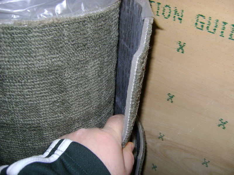

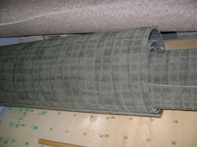

I agree with Sweendog on the Tandus C&A product. Th powerbond has an attached cushion. It may be more expensive than they are willing to pay but it is a great product. Plus their head maintenance guy is an IICRC approved CCMT instructor for Jon Don.
http://www.tandus.com/products/sixfoot.aspx
If they can't afford Tandus then yes go with doublestick if it is properly installed.

Collins and Aikmen.. its a super duty commercial carpet. With the fibers heat set into a thermoplastic backing. They are available as a very dense thin back or with an attached urethane vinyl padding thats welded in as well so you basically have a product that is impermeable to moisture.. Its alot better than any double stick installation.. Regardless of how well a double glue installation goes, it will inevitably fail. But there is no adhesive to fail between layers. no latex. And when the proper floor prep is done and sealer, the self stick back is quite permanent until its power stripped off the floor by machine.
An example of C&A
